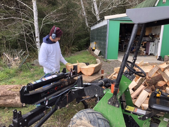

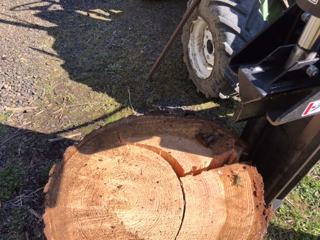

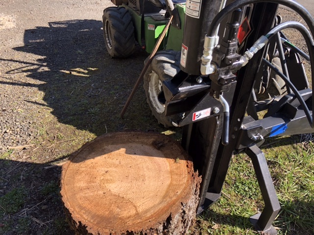

This is the Black Diamond 3pt hitch log splitter that I “attached” to my 425. It works both horizontally and Vertically. I welded an attachment plate to the side of the splitter so it sits perpendicular to the tractor. This make it easier to move around. It works great running off the Aux hydraulics and I can split some pretty massive rounds in the vertical mode.
   / Who's got a log splitter that they run off the PT? #39
I bought a Black Diamond 3pt hitch log splitter, welder and accessory plate to the side so it sits perpendicular to the tractor. It works off the Aux hydraulics.
Splitter $700.00
Quick connectors (purchased from PT) $90.00
Two 1/2” hoses made locally $130.00
Accesory plate I bought with tractor & dont’ remember $
