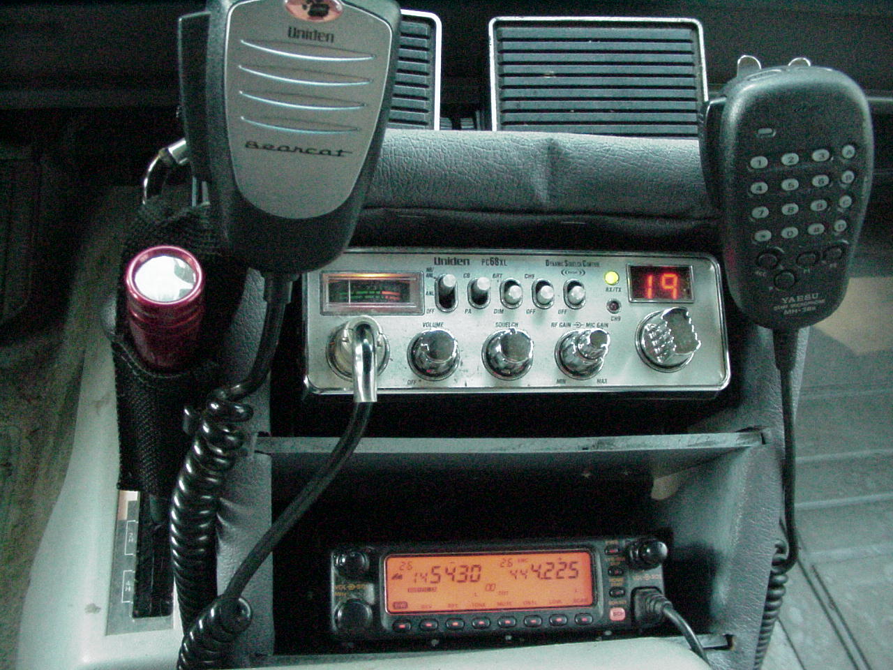

I've had a CB in almost every vehicle I've owned since the early 70s when I first got a driver's license. (telling my age now) My old truck currently has a Uniden PC68XL CB as well as my 2m/440 ham radio since I was licensed in 95 in it. I don't travel as much as I used to, so it does not get used as much as it did. Mostly to listen, but on multi-vehicle trips I have a couple of mobile CBs that I can loan out to provide cheap communications between vehicles too, but the availability of cell phones have pretty much killed that need out. However when disaster strikes (natural or man-made), radios transmissions may be the only communications available and then only from battery power (vehicles or generators).
