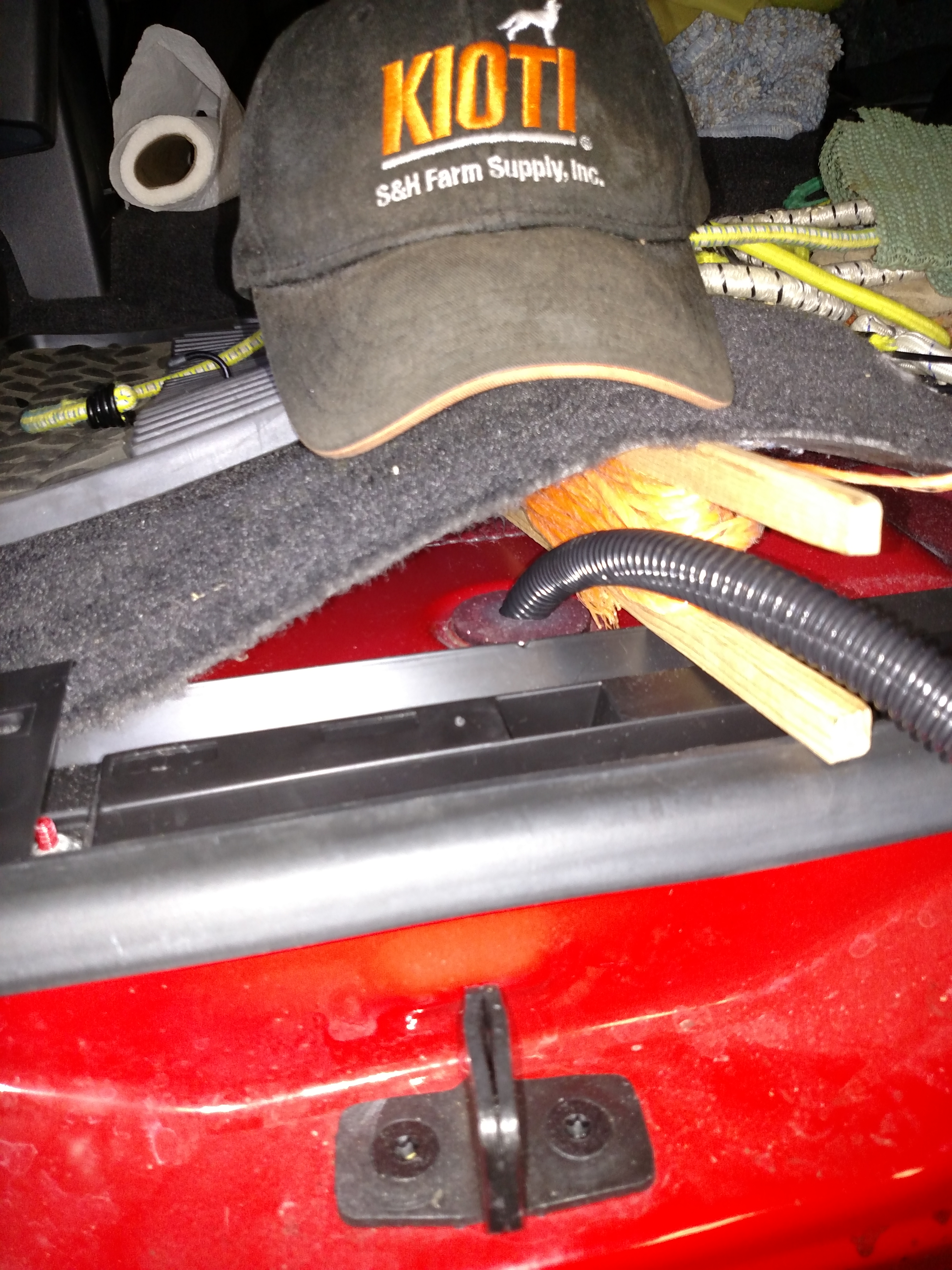

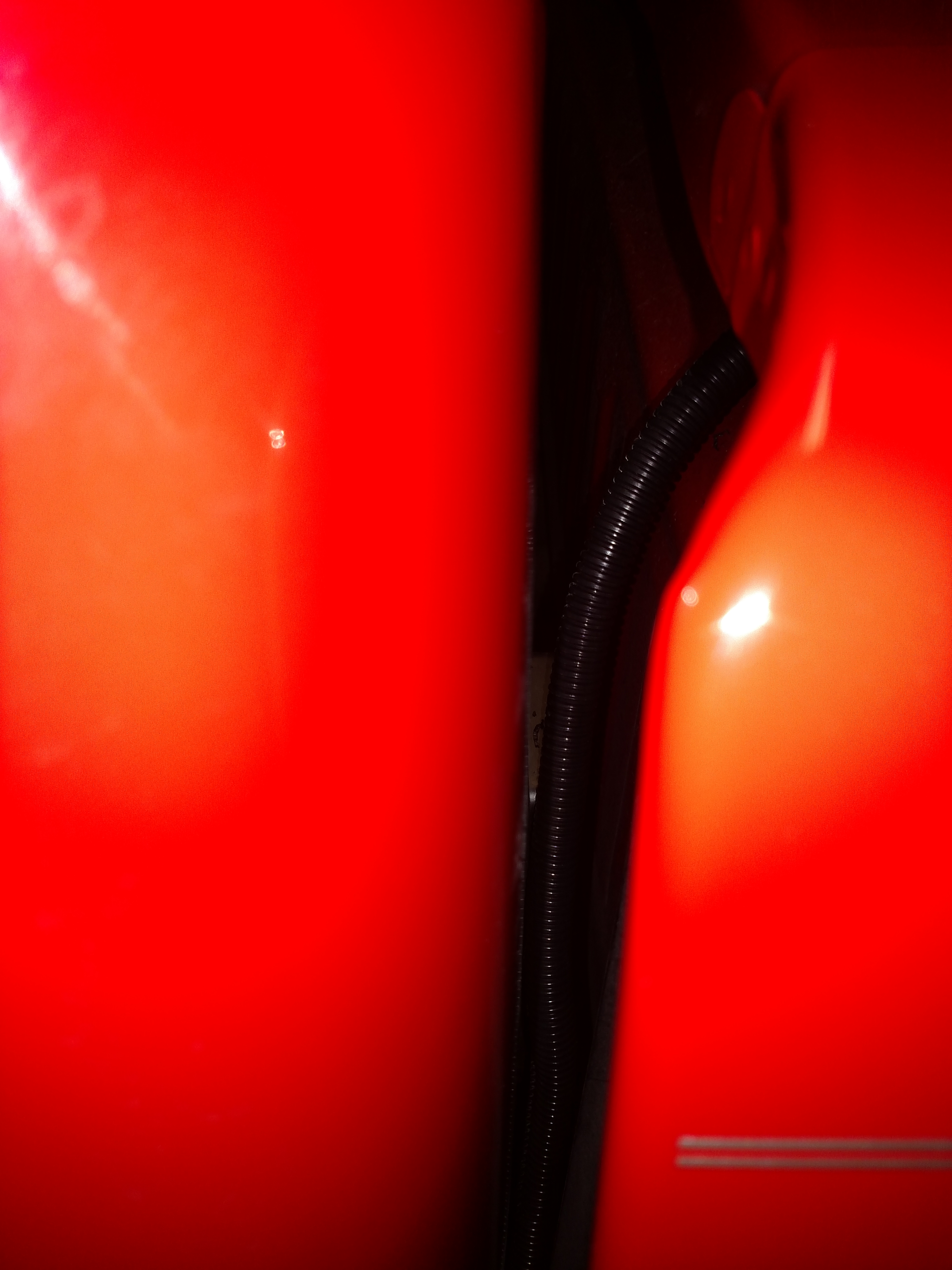

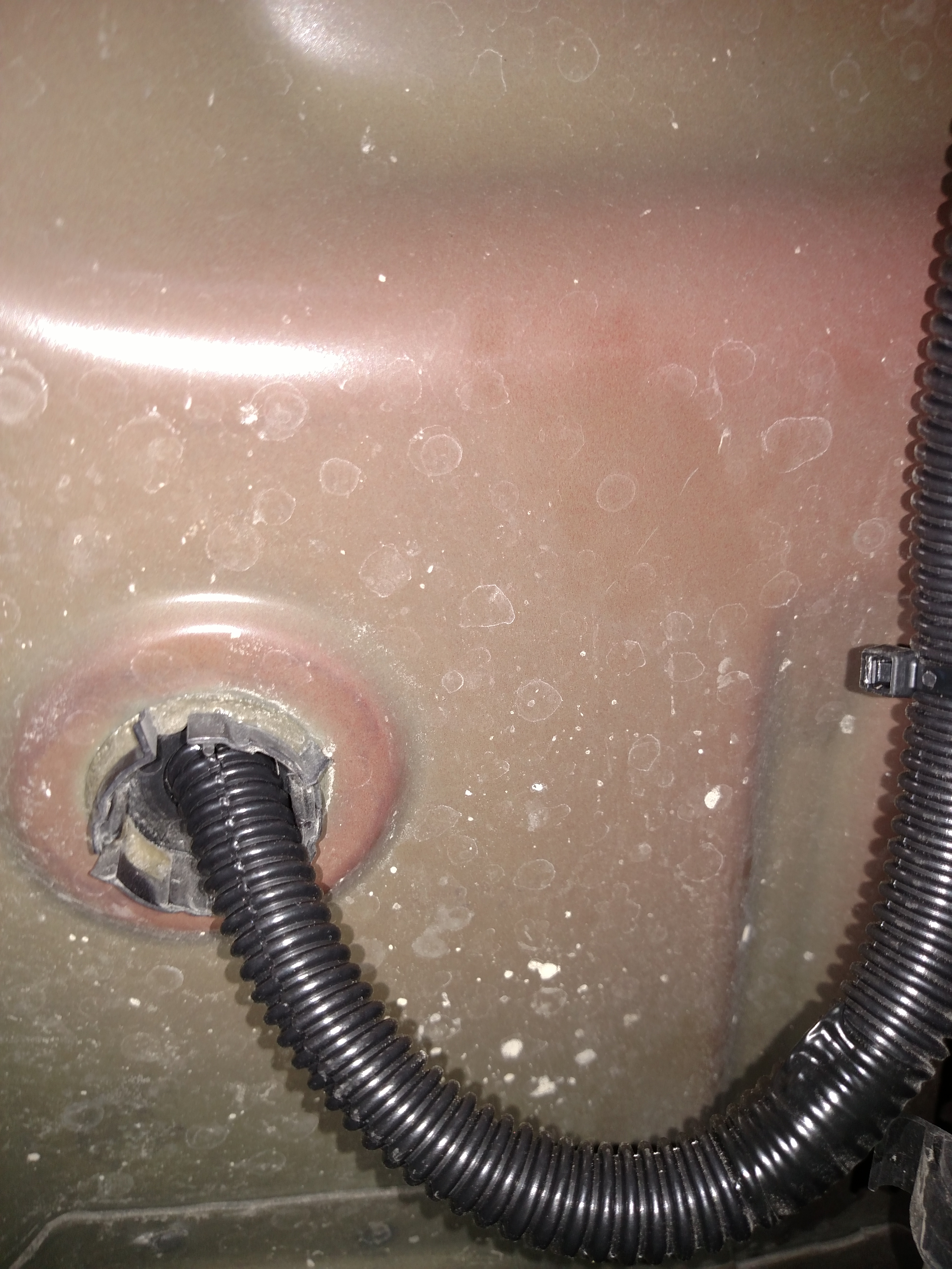

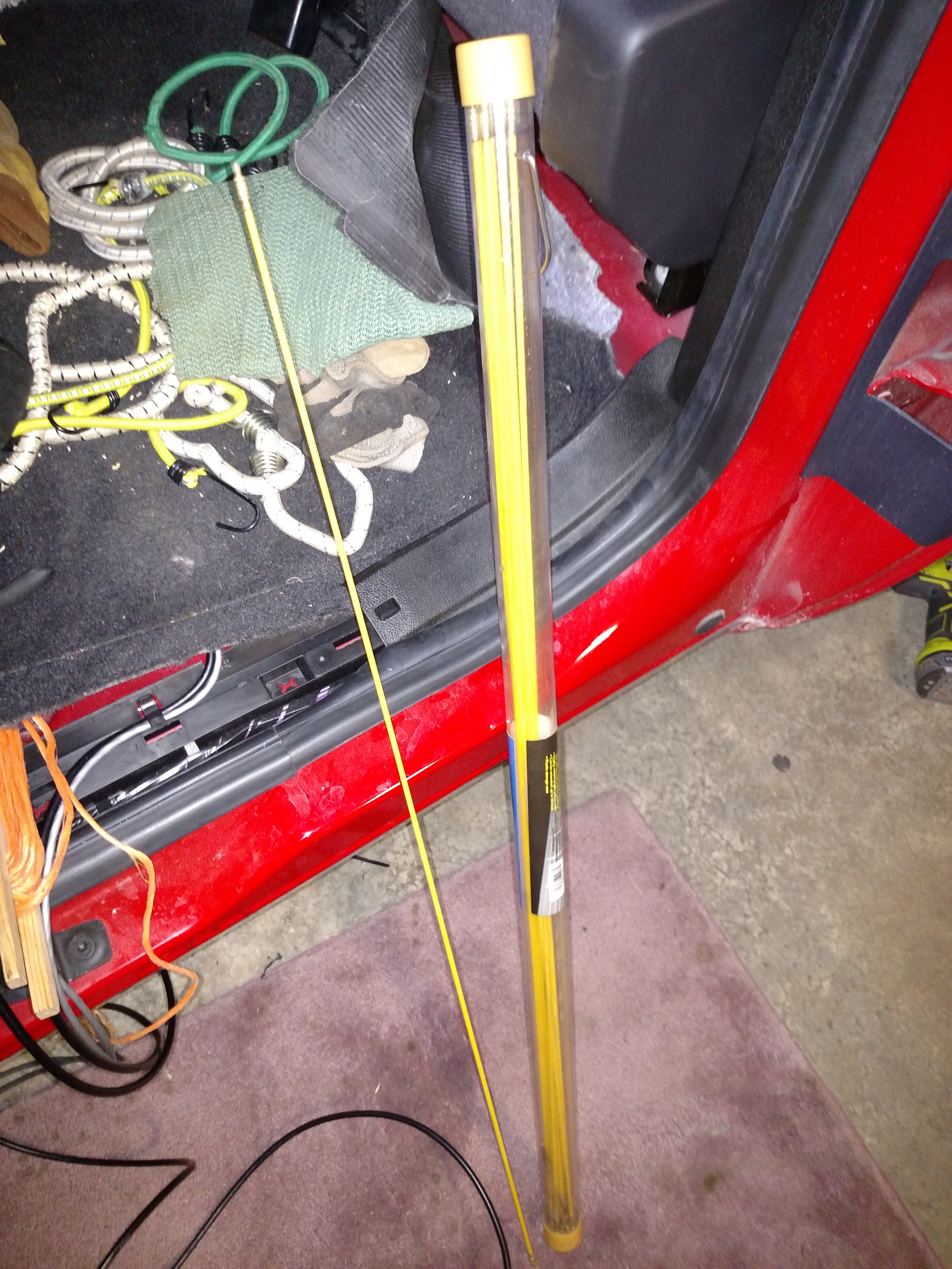

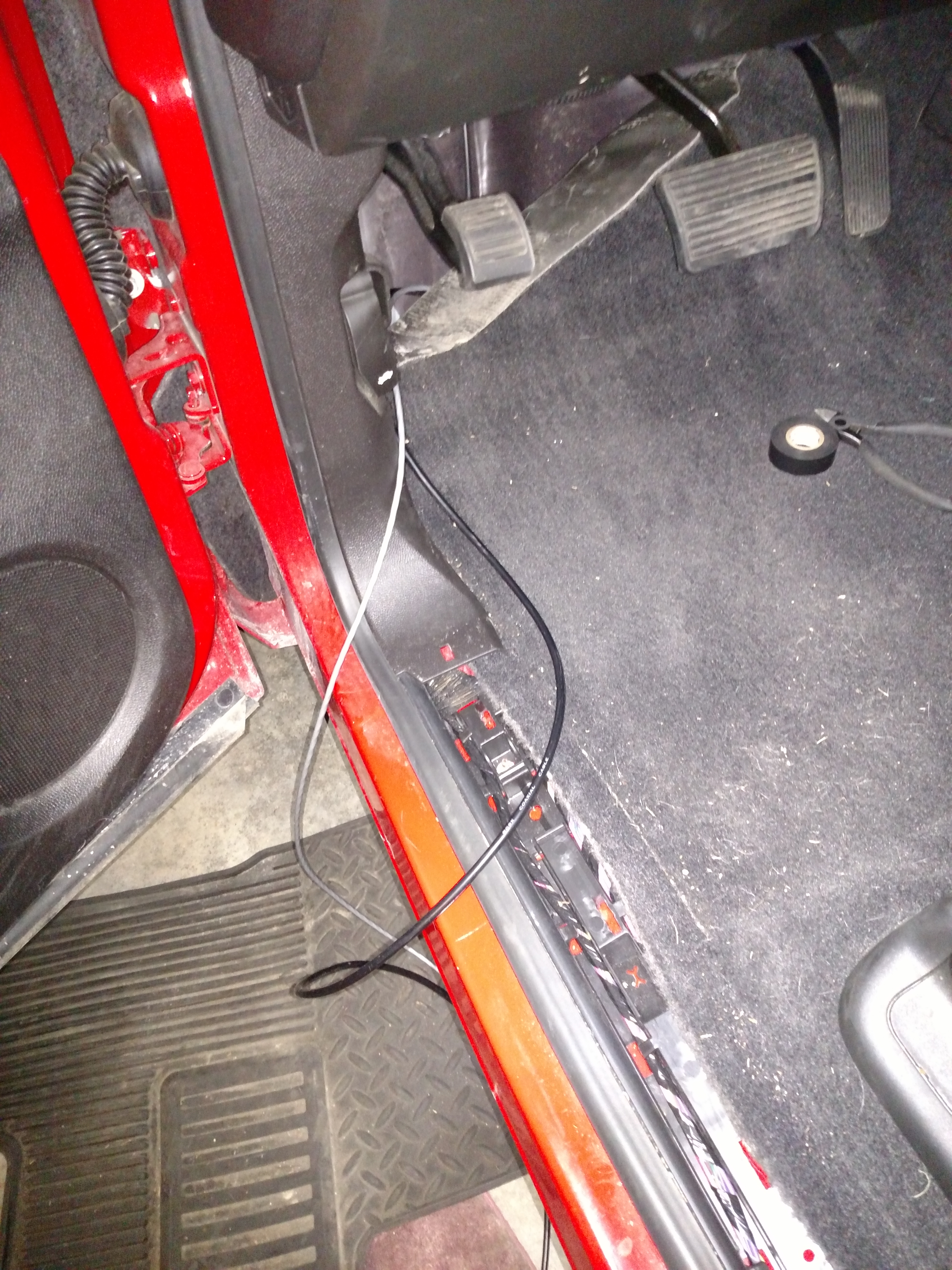

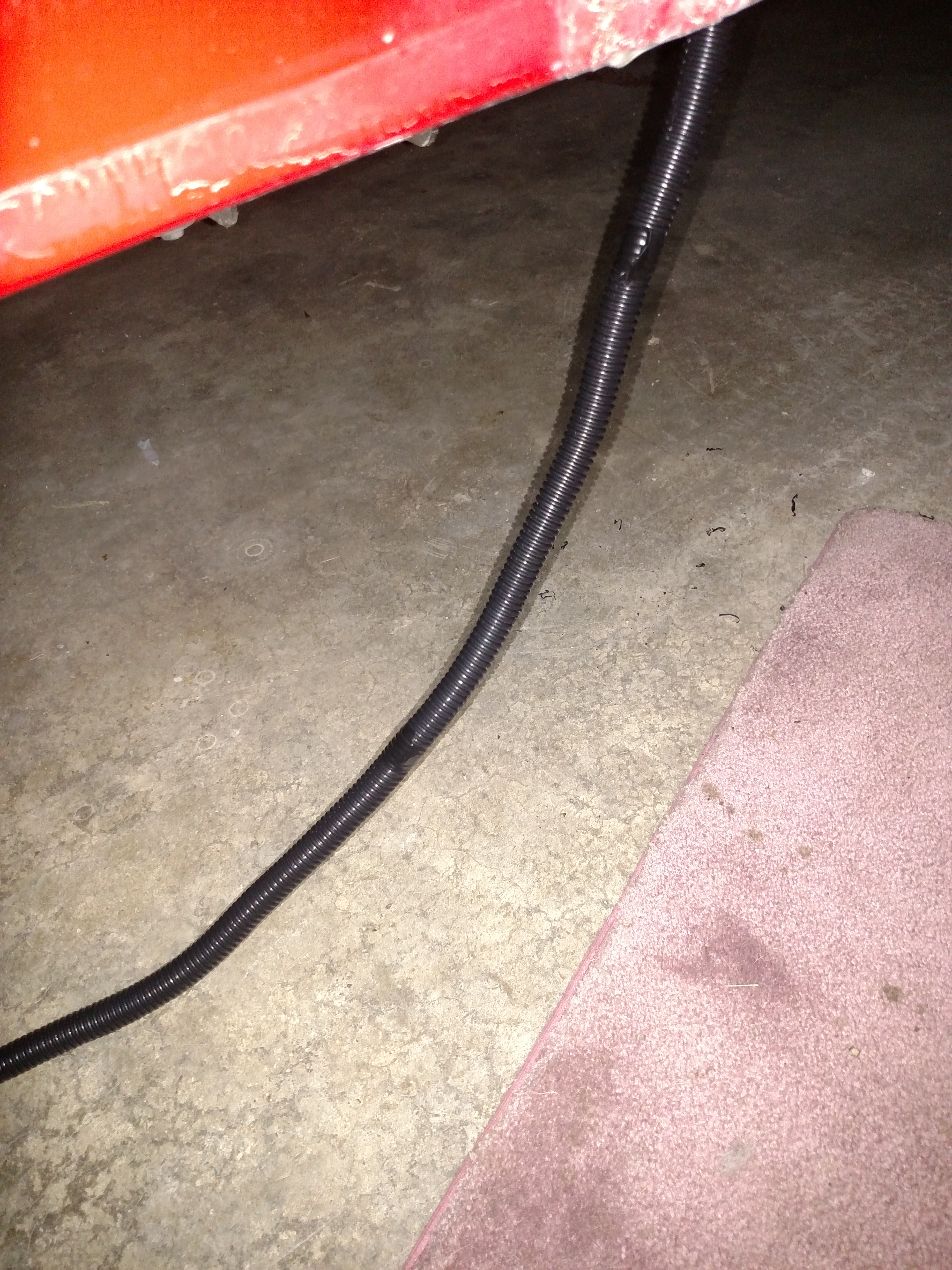

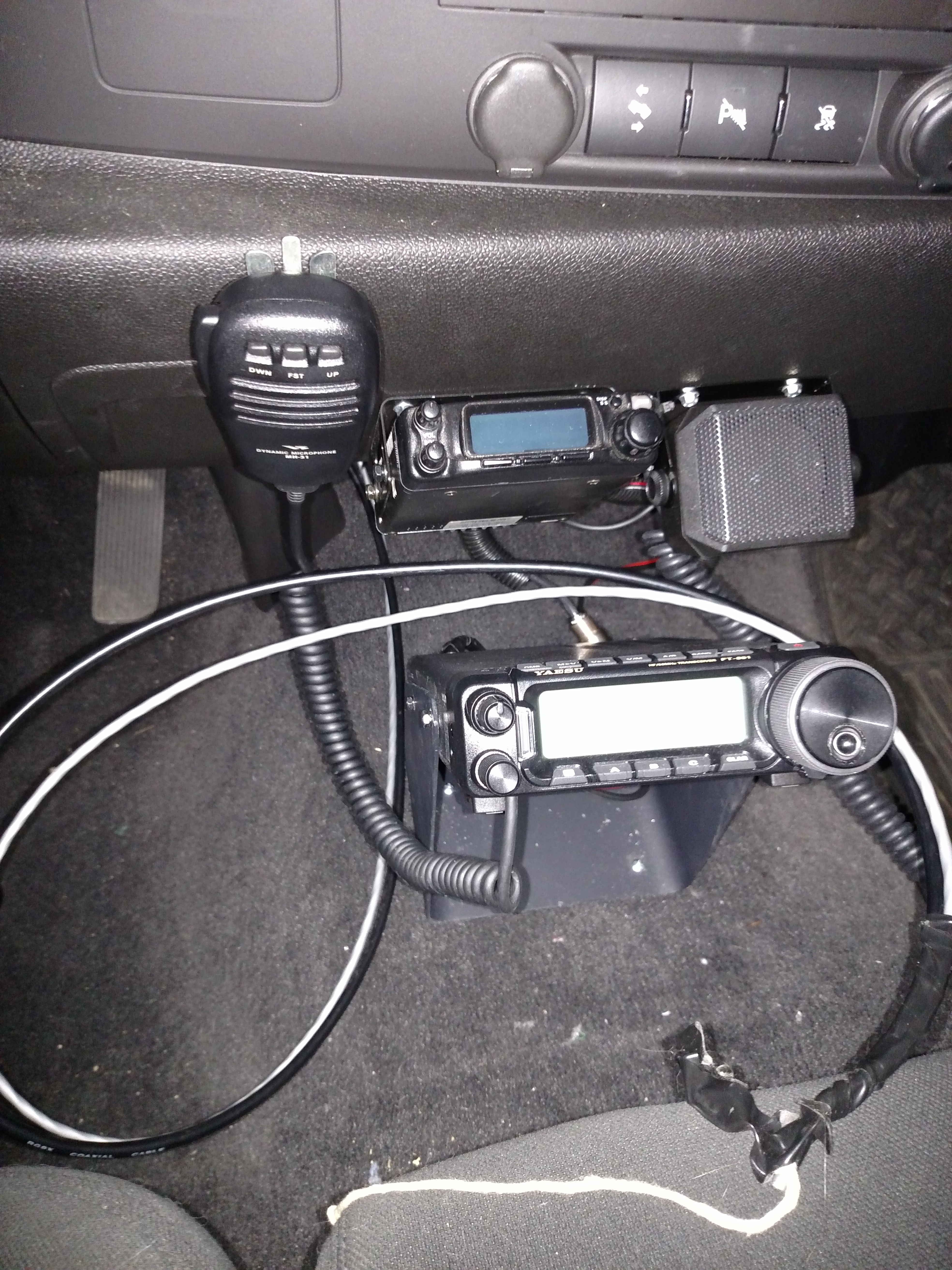

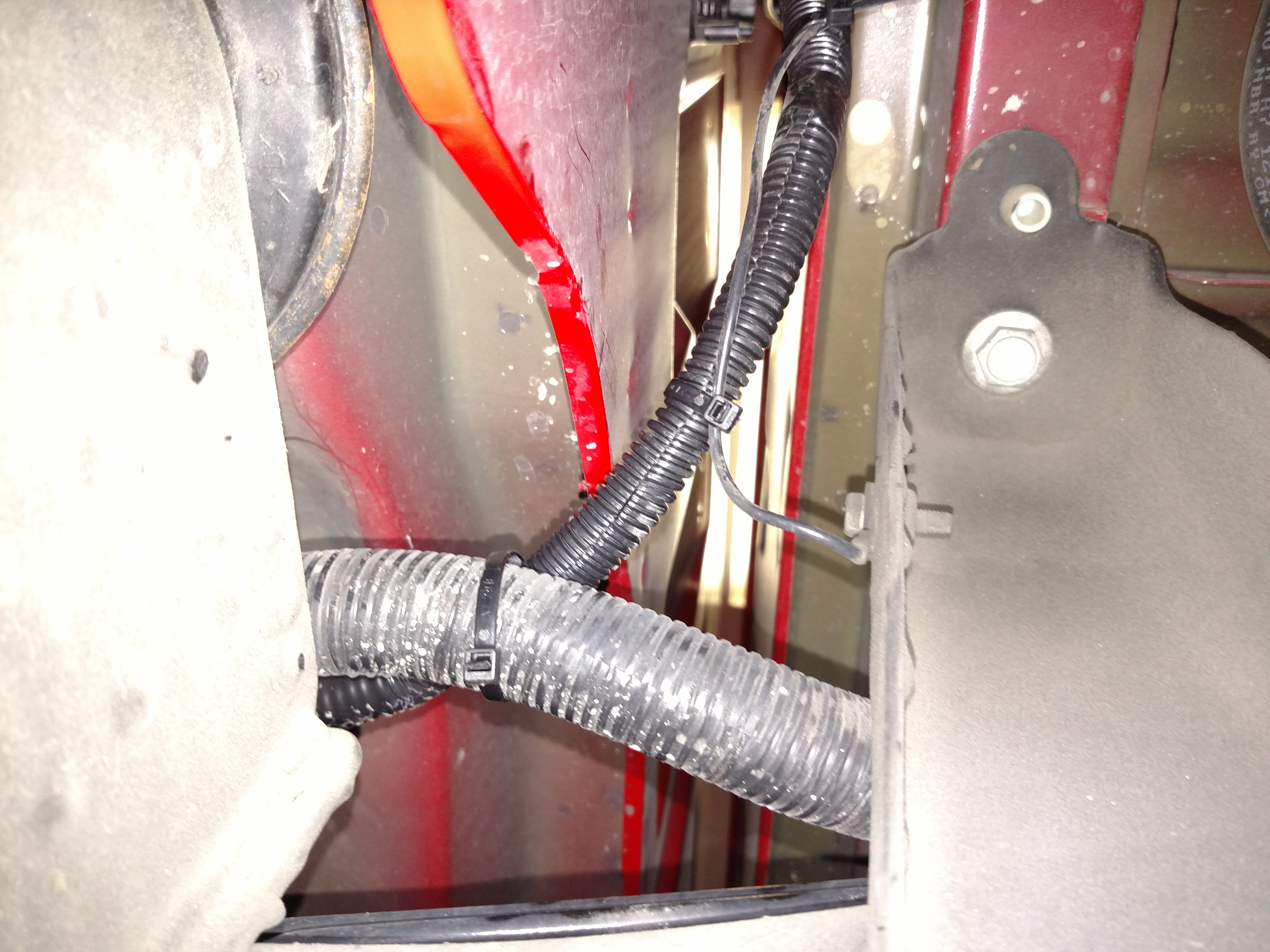

Here are some pix of my pulling the coax and control cable in my 2010 Silverado yesterday.
View attachment IMG_20181126_124228312.jpgView attachment IMG_20181126_124245946.jpgView attachment IMG_20181126_124340878.jpgView attachment IMG_20181126_125132895.jpgView attachment IMG_20181126_130834542.jpgView attachment IMG_20181126_131706558.jpg
The cables are now in the cab and ready for termination. The black cable is RG8x coax and the grey cable is 4 conductor control cable for the screwdriver antenna. The mount for the Yaesu 891 is home made in my shop. Making the bends was teidous, but accomplished in my woodworking vise. Precise hole drilling for the radio mounting screws was a PITA. The top radio has been there for years, it is a Yaesu FT-90 VHF/UHF. The yellow "sticks" are wire pulling sticks from Harbor Freight. Hat is by Kioti. :) (This is a tractor forum after all)
