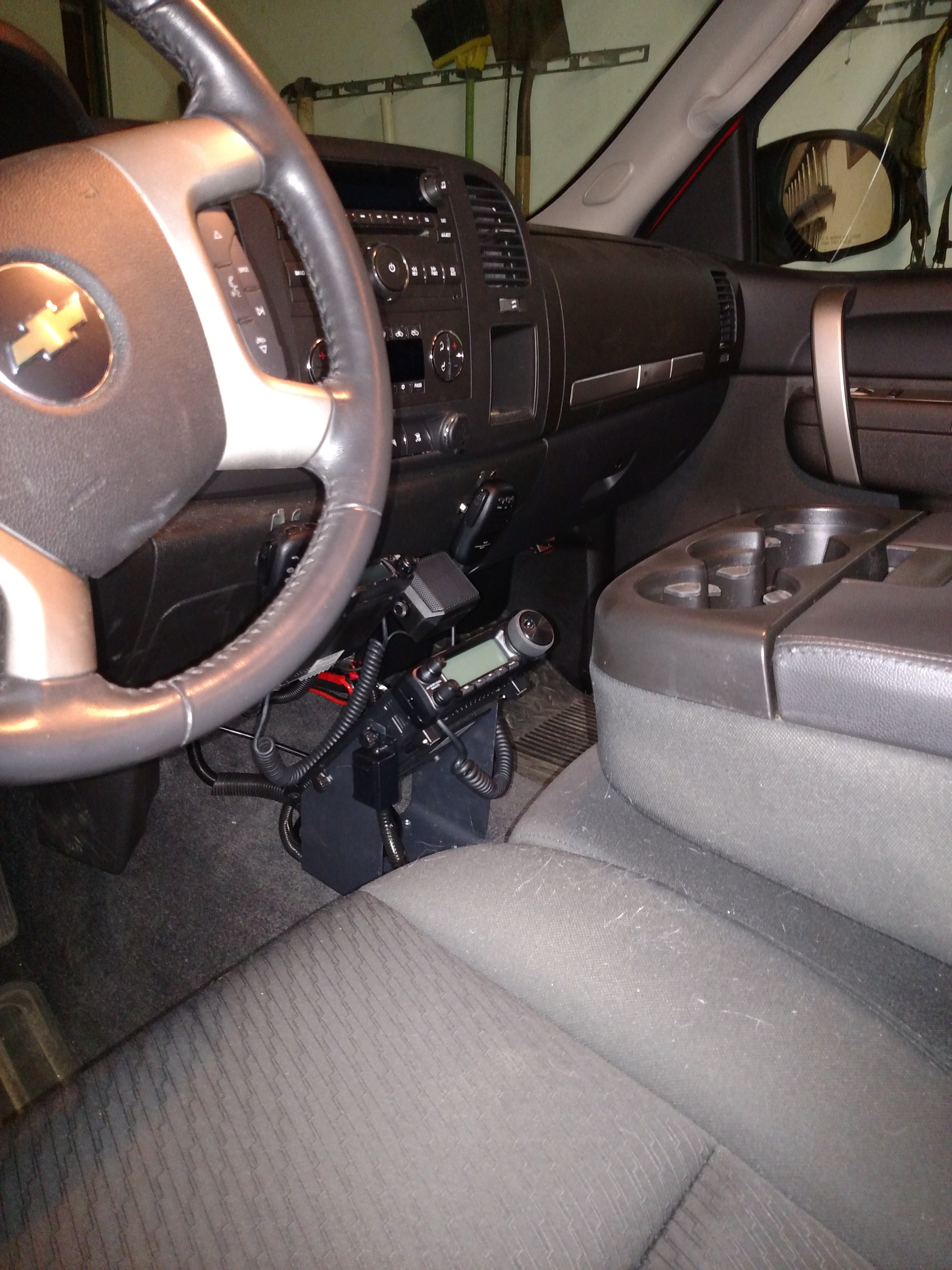

Here are some pix of my pulling the coax and control cable in my 2010 Silverado yesterday.
The cables are now in the cab and ready for termination. The black cable is RG8x coax and the grey cable is 4 conductor control cable for the screwdriver antenna. The mount for the Yaesu 891 is home made in my shop. Making the bends was teidous, but accomplished in my woodworking vise. Precise hole drilling for the radio mounting screws was a PITA. The top radio has been there for years, it is a Yaesu FT-90 VHF/UHF. The yellow "sticks" are wire pulling sticks from Harbor Freight. Hat is by Kioti. :) (This is a tractor forum after all)

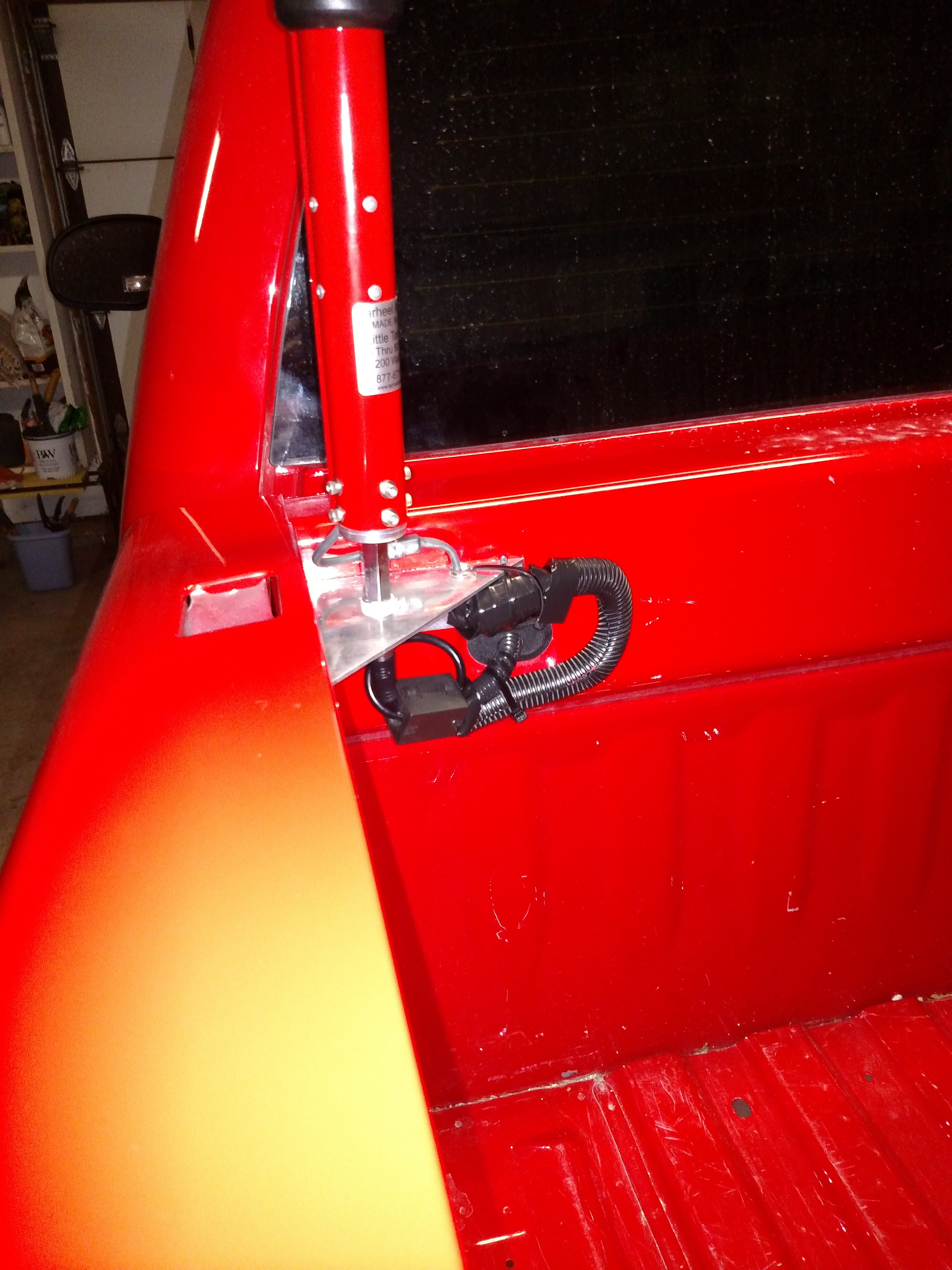

Are you mounting to your truck bed rail? The guys at the HAM store informed me that’s a terrible location due to lack of ground plane...
   / Who Uses CB Radios? #92
It is a lot more complicated than that. There is no such a thing as a ground plane at HF frequencies. Your entire vehicle needs to be bonded together and forms a capacitance to the actual earth under it. We can talk about ground planes at higher VHF and UHF frequencies, but NOT at HF.
If you would like to know more about HF mobile radio you can go to the K0BG website: There is a lot to learn. :)

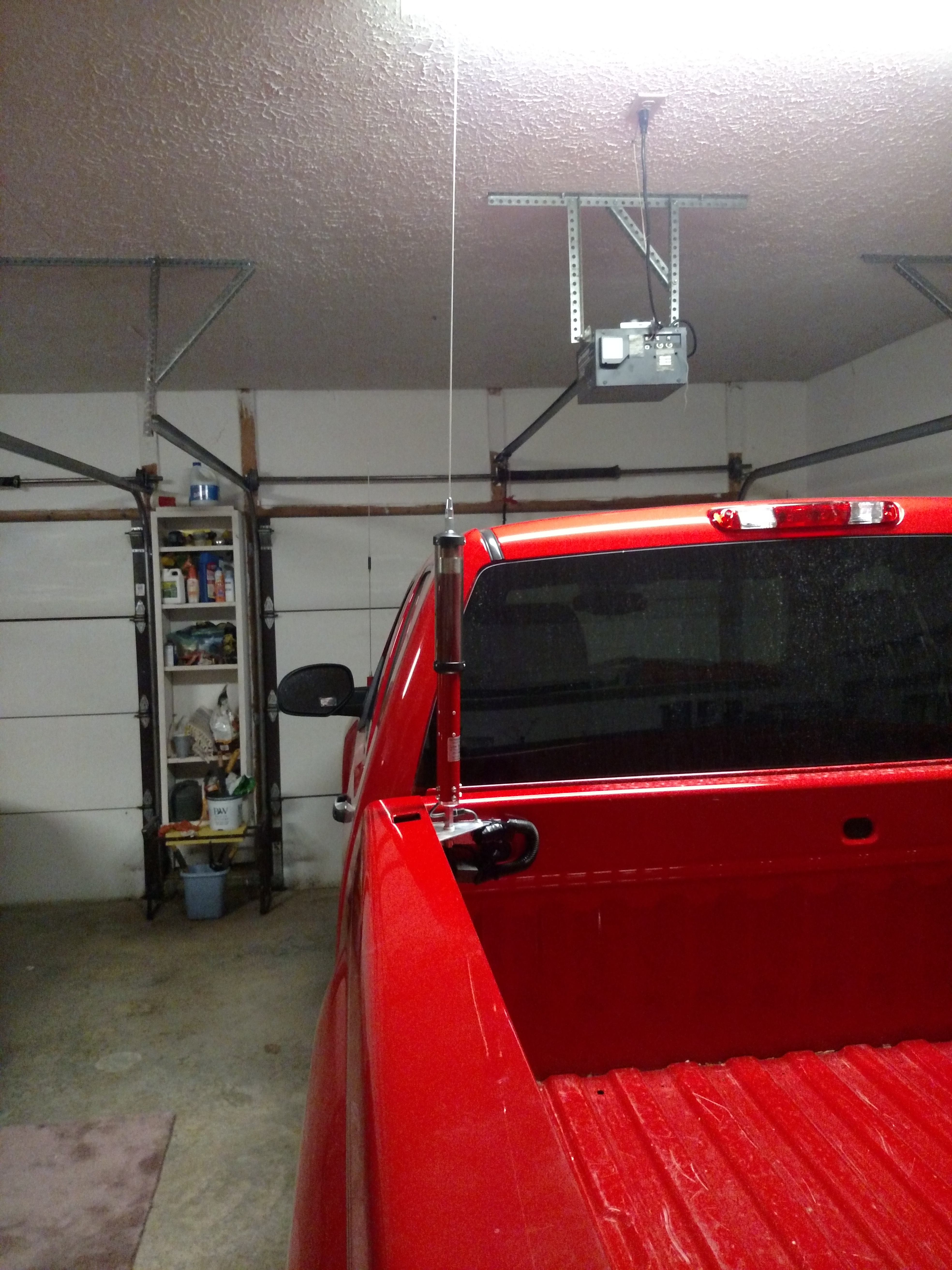

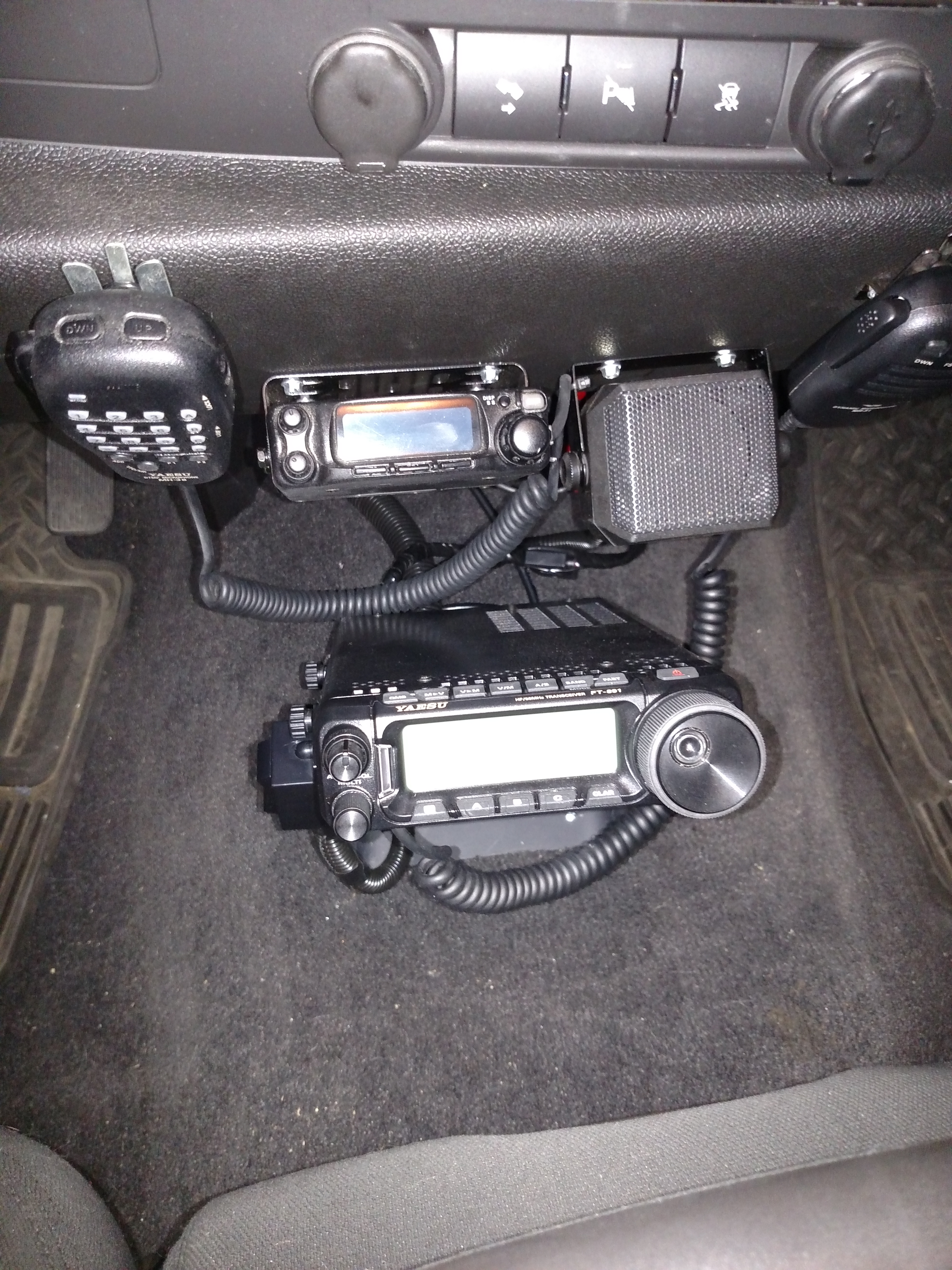

If you are interested here are some install pix of the Yaesu FT891 HF rig and the Little Tarheel II screwdriver antenna for 80 thru 6 meter bands. The other rig in the cab the Yaesu Ft90 for VHF/UHF has been there for years. Also shown in the bed are the ferrite chokes to decouple the power cable and the coax going to antenna and splice for the power cable.
View attachment IMG_20190111_145829673.jpgView attachment IMG_20190111_150014887.jpgView attachment IMG_20190111_145749354.jpg
You can see on the left side of the HF radio the manual up/down button to activate the screwdriver motor and adjust the coil connection up and down. BUT I can tell you already there is going to be an automatic controller in my future. In fact the Ameritron SC-104Y is already on order. It takes a lot of button pushing to go from 80 to 6 meters and find the point of resonance. The controller will keep track of the number of turns the motor makes and can return to any of 8 presets per band. It receives band data from the radio itself and tracks the radio as you change frequency.

Yes, and no. There are many repeaters that have fairly active road information during times of severe weather. It just depends. Yes there are more people on any given stretch of road with CB vs. Amateur vhf/uhf rigs in their vehicles, BUT repeaters can cover a wide area, and during severe weather they are often linked together and nets are called to provide information. Now as far a warning you about a wreck up ahead, the CB will likely be more help. Also keep in mind, with the relaxing of the Amateur Radio licensing requirements, more and more truck drivers are licensed amateurs and many do have Amateur rigs in their trucks. Some both vhf/uhf and even HF. I am not saying even every 1/10 truck has an licensed amateur aboard, but they are a fair number of them.
