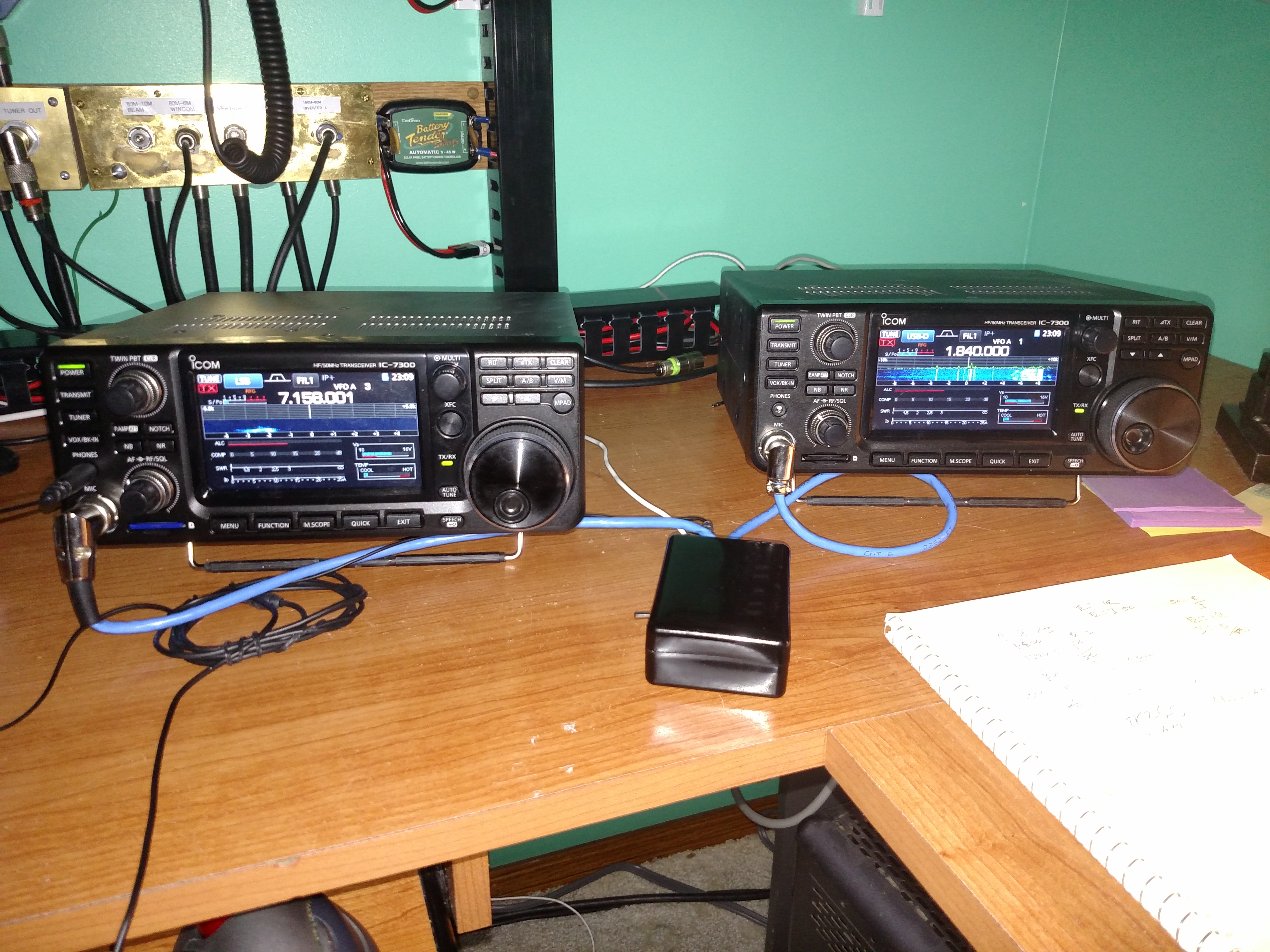

Moss, here are the "twins" I referenced in the PM I just sent you. I did finally get the guy in Belarus in the log.
Still listening to the guy in Kuwait. YOu can see the frequencies on the display.
Nice setup James it appears you have a Homebrew Mic switch?? What antenna's are you running on the twins?
Yes, a homebrew microphone switch box to easily change the microphone between the rigs. I use a computer headset as they have an electret element in them just like what the Icom's need. It also has an input for the footswitch on the floor and a PTT button on the front, so multiple ways to key the selected rig.
Antennas include a Cush Craft (before MFJ bought them out) MA5B for 20 thru 10 meters, an OCFD (Off Center Fed Dipole) for 80 thru 6 meters, a 6 meter vertical, and a 6 meter moxon 2 element beam above the MA5B. I also have an Inverted L out in the woods for 160 meters which also works well on 60 meters . And also on the same feedline is a 30 meter vertical with elevated radials. There is about 100 foot distance between the antenna groups so I can operate many combinations of bands at the same time.

Why two rigs?

Why two rigs?
A couple of reasons. One is simply to have a backup rig. As in "two is 1 and 1 is none" which is a military readiness axiom.
And the more pressing reason is I often operate two rigs at once to be able to be on two different bands at the same time. I will often set one on 30 meters on the FT8 frequency, and then tune around with the other one on 20 meters thru 10 meters during the day working either FT8 or CW chasing DX while checking the spotting on the DX spotting network.
During the night, the one rig that was on 30 meters gets set up on 160 meters and stays there and the other rig goes between 80 meters or 40 meters again usually on FT8 or CW, and occasionally will go to SSB if something "juicy" is spotted on that mode.
When the 6 meter Es season comes in late May, the one rig will be on the 6 meter FT8 frequency looking for double and triple hop Sporadic E propagation into Europe and Asia. The other again will be up on 20 thru 10 meters. With two rigs on different bands at the same time, more DX can be worked in a given time and less openings will be missed.
