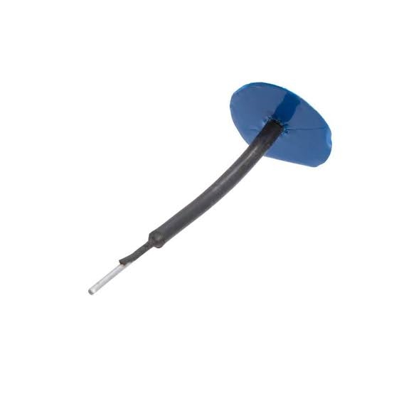

Legal repair? Is there a state board of legal tire repair methods?
Not sure what entity decides these things, but for a tire to be repaired it has to be dismounted and the liner sealed from the inside. A plug is not a legal repair.
Say what..a legal repair? What’s a “legal repair” mean exactly? Tire companies say don’t fix their tires? That’s not a law. Again, Says who? Where?
NH has always had strict vehicle inspections, and a tire with a functioning gummy worm repair is completely legal.
You speak like you’re insinuating the entire country… I’m genuinely curious where you’re getting this apparently federal law from, that Ive never heard of.
Sorry gotta call bs
   / Who plugs tires? #80
And here I thought it was common knowledge. Guess it's not.
Anyway, tire manufacturers, the DOT, the Tire Industry Association, USTMA, and others have pretty much all agreed on what constitutes a legal repair.
