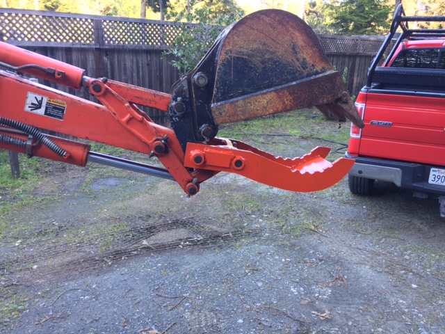

I am always trying to get a bit more functionality out of the B21. Rather than get another machine. That is why I made the hyd thumb with progressive linkage. The hyd actuation is very important as Gary said. With the progressive linkage the thumb gets 180 degrees range of motion and a lot more reach than any mechanical thumb. Direct link hyd thumbs get 90-110 degrees range of motion. It makes a difference. When I was mocking it up I got 210 degrees of motion but dialed that back to avoid excess force on the components. Also with progressive linkage the cyl stays close to the stick, compared to direct linkage, and out of harm's way for instance when dumping into a trailer.

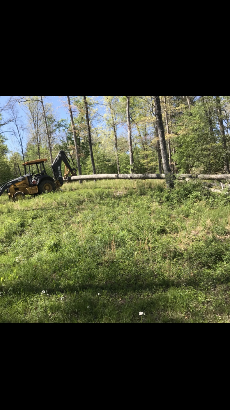

Betcha he didn't get far with that wide load. Seems to me, a logging style grapple would be infinitely more useful. I know it would be for me.

That may not be what's going on there. Looking back on the picture on message #25, I often do the same - I use the thumb to pick up a downed tree to about that height to make it easier to limb and then chainsaw into sections.
BTW, around here most TLBs have thumbs now, but thumbs were rare 20 years ago. I wouldn't buy one today without a thumb.

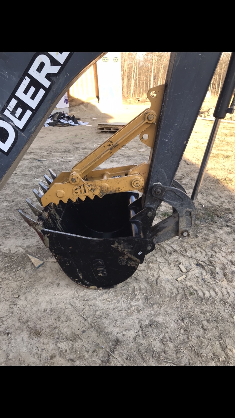

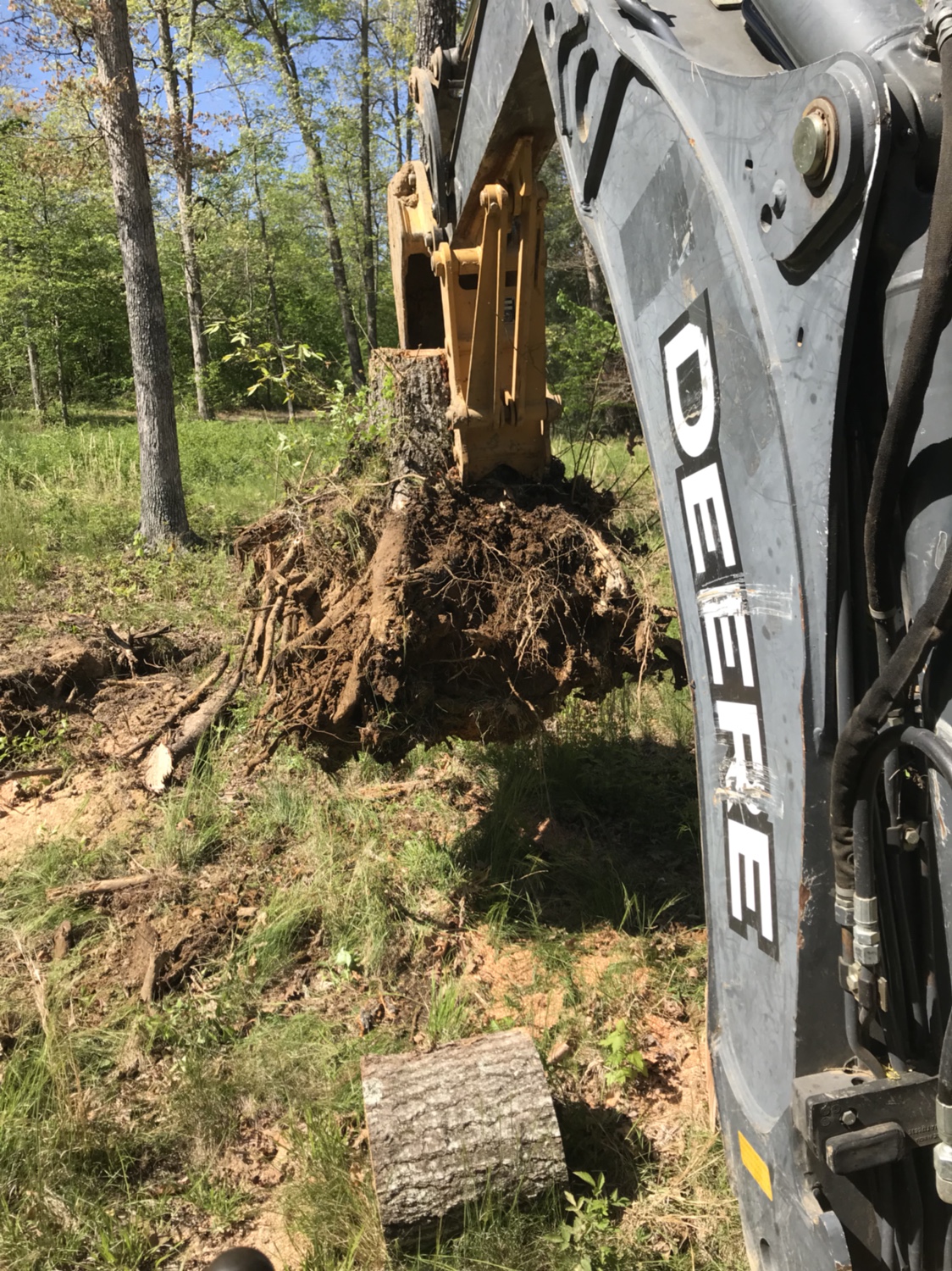

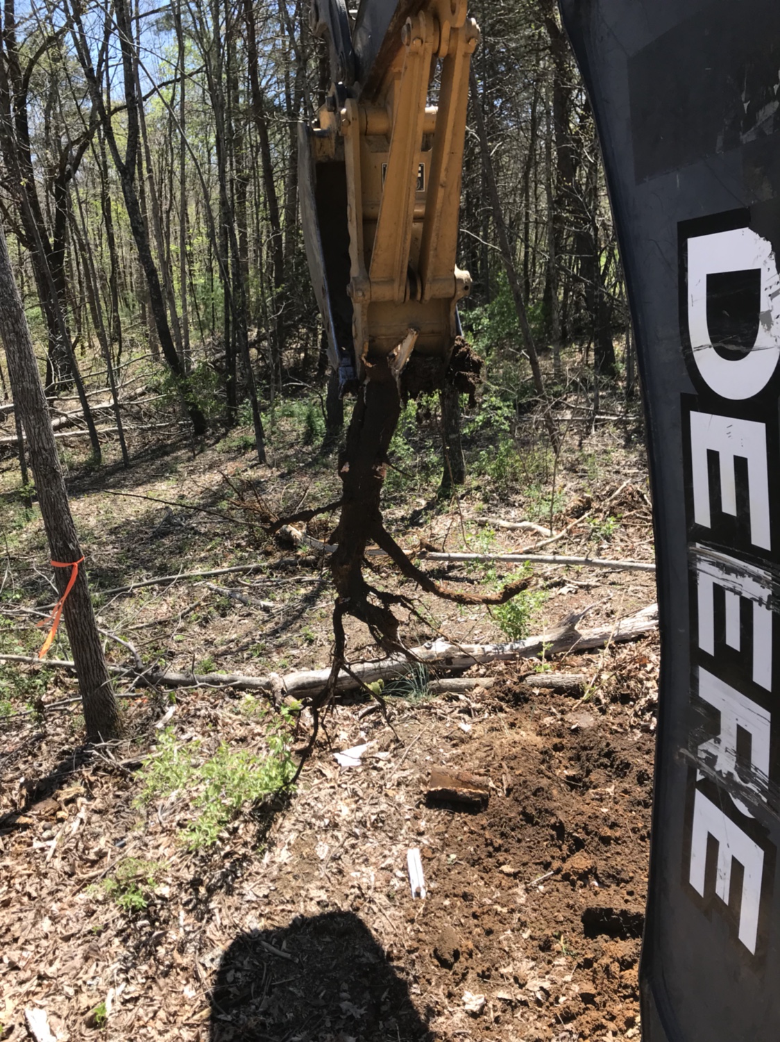

Post 25 was posted by me and there is a thumb on it. IMG_2064.JPGIMG_2054.JPGIMG_1990.JPG
