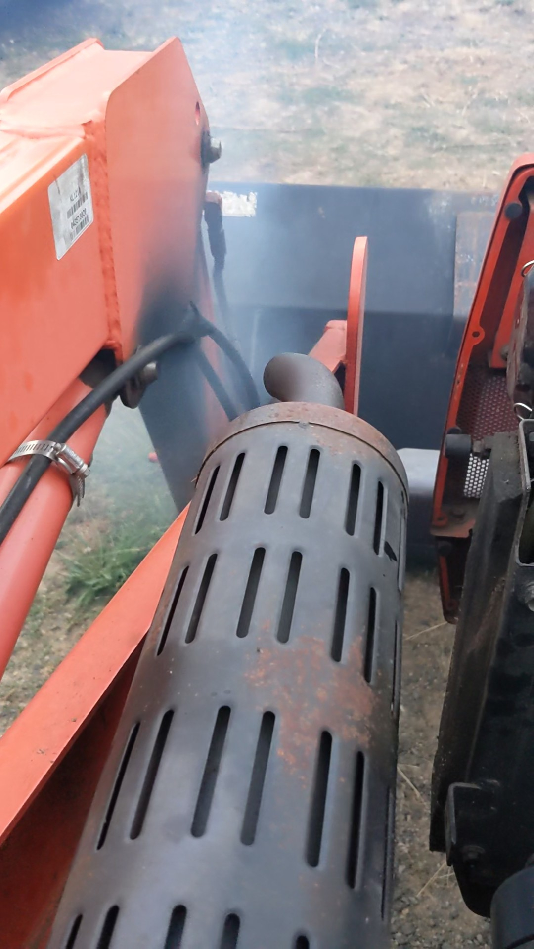

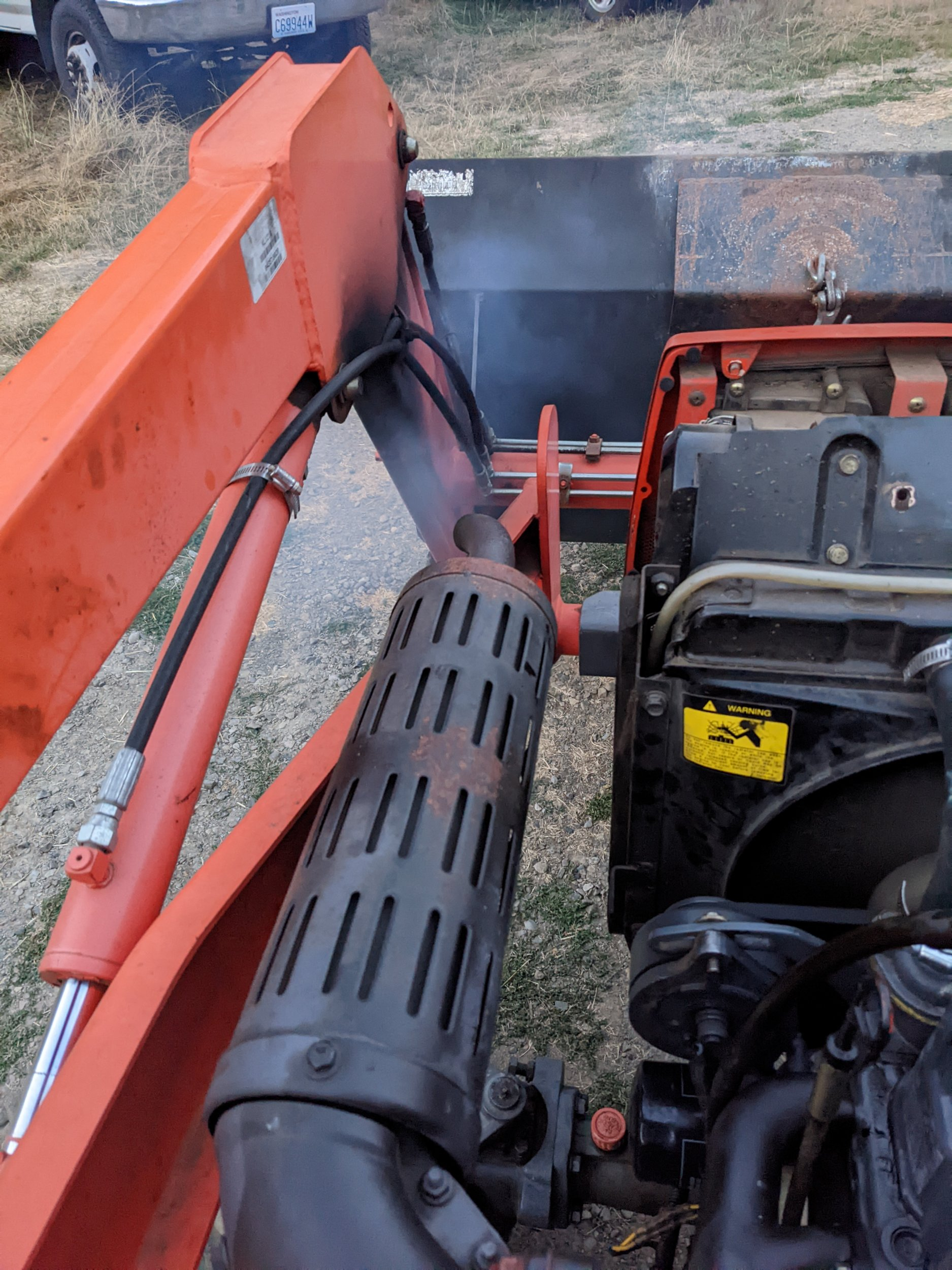

Hi all,
A friend of mine has a Kioti LB1914 and I was over helping him today.
He had a valve collet fail - he put new collets in it, and re adjusted valves, and it's running better now.
However, it's blowing white smoke under load. I tired to attach video, that didn't work, so I frame grabbed. It smokes a bit while operating, but under load it's very evident. It's possible a valve seal is leaking a bit of oil during operation, but this smoke under load is very white.
It's very quick to appear and disappear as you add and reduce throttle.
Any ideas? Seems like injector to me. But I'm a lousy mechanic.
Thanks for any help!

White smoke is a possible indicator of water entering the cylinder. If the head was removed to replace the valve collets it's possible the head was not torqued properly. Hopefully the head gasket was replace if the head was removed.
/ White Smoke Under Load - Kioti LB1914 #3
That looks more like oil smoke to me.

OK, to me that looks like the white smoke that happens with unburned diesel being pushed out the exhaust. Usually from a cylinder that isn't igniting. Typical of cold weather starts. White smoke that smells strongly of diesel is sometimes called "diesel fog".
If that is what it is, it could be injectors, but just as likely - given the history of a valve problem - it is compression related. One good diagnostic step would be to do a compression check. You can do that when you pull the injectors to check them.
BTW, you call that part a "collet"? I've always heard "keepers" and had to look up the term "valve collet".
But regardless whether we call it a collet or keeper, I was a mechanic for a long time and don't think I can ever recall seeing that part failing on anything.
Can you tell some more about the failed collet? Had he taken the head off and done a valve job? How does one replace the collet without taking off the head? How did he know it had failed? Did the valve fall down? Lots of questions...

Oh yeah, it smells very strong of diesel.
I will borrow a compression tester and test it tonight if I get time.
Kioti calls it a collet - E5700-13363 - I didn't know what he meant when he first told me either!
It does seem pretty odd to me too - but I talked with a Kioti dealer nearby who said he saw this happen on this generation of LB1914. The collet 'lip' was almost worn smooth. The replacement part had been changed to a more aggressive lip.
So, he was mowing - heard a noise and the tractor lost power and then started to smoke a bit. He shut it off, brought it to a mechanic who told him the collet had failed and he was lucky to have not lost a valve. The bid was so high he decided to order parts and replace himself. He is not a mechanic by any means, neither am I.
He said he took the valve cover off, installed the new collets - then reinstalled the spring and spring retainer, then we adjusted valves to .13mm - as .18mm was running very poorly.
Thank you

Well, I am a mechanic - or was for many years ..... My experience is mostly with with gas, but a few diesels.... and you sure sounds to me like you know what you are doing. No reason at all that between the two of you it can't be made right. Mechanics is mostly common sense.
It does sound like he got lucky not to have dropped a valve - which would be a VERY BIG REPAIR! But unfortunately not so lucky that he didn't slightly bend one. And it may have dinged the injector too - just depends on the distance between them.
Still, he may still get lucky and have only a minor and fairly easy repair.
What's important here is not to come to any preconceptions or conclusions without more testing. The compression check will tell much more of the story. Your valve clearance is reasonable for that type engine.
Some hints:
1. Expect that compression will be in the diesel range rather than the gas engine range. I am just guessing on that engine, but would expect it to be in the 400 to 700 psi range. So you will need to come up with a diesel compression gauge. A gasoline engine does not have that high of a compression, so a gasoline engine compression gauge is NOT suitable.
2. You need to ask the dealer if this engine has a separate removable pre-combustion chamber that needs to be locked down when the injectors are removed when doing a compression check. If so, you might want to have the dealer test compression. Or at least have him advise you on any special steps. You don't want something coming loose or flying out of the cylinders when you are cranking it with the injectors out.
3. disconnect the injector lines at the injector, turn off the fuel flow at the filter.
4. For a good compression check, remove ALL the injectors before running the test. Injectors can be hard to remove on some older engines and sometimes require a special puller. There are tricks to get by without a real injector puller...but there is a learning curve. So I'd say to have a puller handy if they are stuck. There are universal injector pullers with a variety of threads. Get one that fits your injectors. Replacing the injectors usually requires new injector seals.
This is where we need to double check before proceeding. We check once more if it is standard procedure on this particular engine to lock down the pre-combustion chamber insert.... if it has them. That is what I was saying in #2 above. So ask the dealer.
5. Otherwise, you are good to test. pull the throttle fully to the OFF position. You will check each cylinder. Crank each cylinder test about the same length of time - you can see when the gauge stops moving. 5 seconds is typical but varies. You do not want to overcrank for too long because compression (with the gauge screwed in) causes a lot of heat, and in fact makes enough heat to throw off the test. So if in doubt crank less instead of more. Do each cylinder separately. I don't know the specs on that engine so best look them up. My own memory says to expect a really good newish small imported diesel that is a good runner and starter to be in the 550 to 650 psi range. Anything under about 450 psi is still going to run but be harder to start expecially when cold. Getting down toward 400 psi and is time to think about doing a basic top end overhaul or put up with harder starting. Those are general numbers - and your engine may be different so don't take them without getting real Kioti specs to go by. But in general, you want to see cylinders should be approximently the same. Plus or minus 25 psi is the tradtional "good as gold" target. More than that and you begin to wonder why.
6. It is possible to check (and rebuild) some injectors at home, but best to just have it done at an injector shop. Typical test and rebuild is about half the cost of new ones. Some places will test them for a nominal fee, others charge the moon.
7. If the problem does turn out to be one low cylinder and is then probably a slightly bent valve, sometimes all it takes is taking the head off, a new valve, hand lapping, a new head gasket and bolting it all down again. But it's a judgement call how far you go with things like flattening the head and other valves.

I finally have a response for you -
Cylinders had good compression - last time I heard the neighbor said the smoke has cleared up and it's running just fine now. Apparently it takes almost exactly two minutes from cold start to clear exhaust - and is running well enough for him to live with it.
/ White Smoke Under Load - Kioti LB1914 #17
It sounds like you have a hole out and it needs heat to expand and seal before it fires. Possibly rings or valve seals
