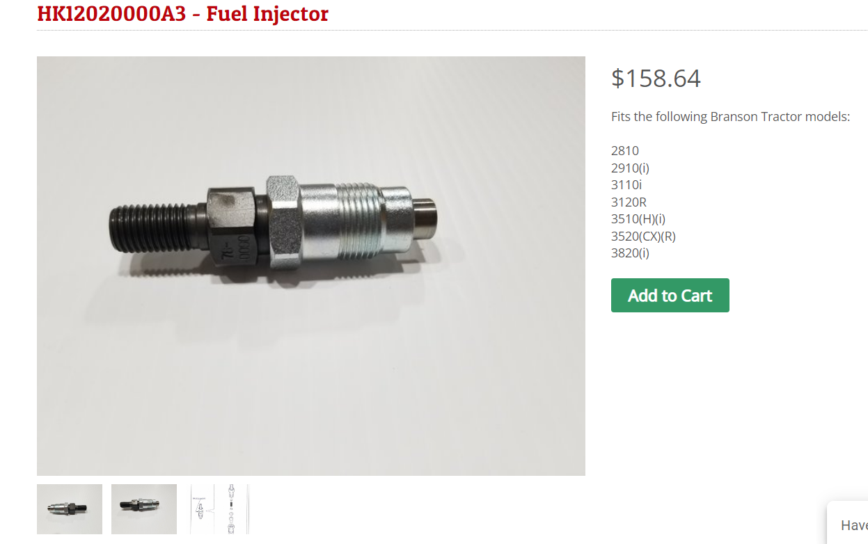

thanks guys. just in case, anyone got any good leads on injectors? definatley don't want to pay 160 a piece. I'm sure there's another brand that fit's and works great. since mine are going on 20 years old might just replace them for the right price.
