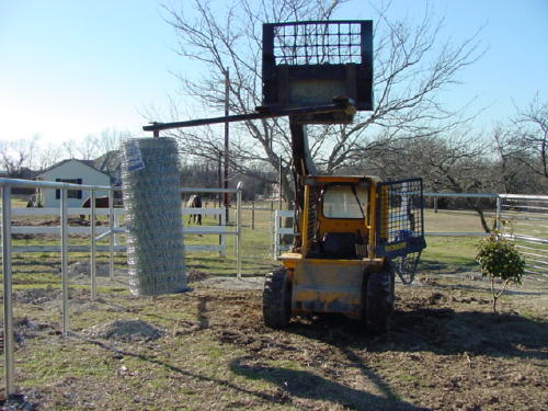

Charlie I need you to post a picture of your deally do if you can.
What I've got is a job where there's an existing fence belonging to the neighbor and it's eighteen inches inside his property. Not enough room for me to use my wire handler since it's a welded pipe frame fence with five foot two by four non climb.
I'm thinking about building a quick attach plate for Iris (my tractor for unitiated). I'll attach a piece of four inch pipe about six feet long dead in the middle of the plate. I'll have a plate attached to a bearing's spindle that will attach to the four inch pipe at the far end.
Concept is this. I place the pipe through the center of the roll of wire. I attach the base plate to the pipe. I can now drive up to the fence. Lift up and tilt down the roll until it's vertical and on the other side of the fence. I can then unroll the wire.
My only glitch might be fixing the angle of the pipe to the anchor plate to where I can take best advantage of the capabilities of the tractor.
This also might allow me to use two hundred foot rolls when I have a drive off situation.
This here puppy might replace the old wire handler for livestock fence. /forums/images/graemlins/grin.gif /forums/images/graemlins/grin.gif
Your input would be appreciated.

Harv: Take a look at the post back in June in this thread. It shows a roll of wire dangling from the lifting boom on my Power Trac. Putting it off to the side would be good, but I haven't really needed it.

Well, let's blame it all on Charlie.
That and the fact that the V Mesh roll is too wide for my original wire handling tractor attachment.
That picture of Charlie's idea was like a porpoise chasing a steamer. I just couldn't shake it.
