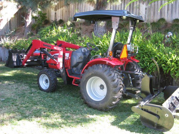

I recently purchased a new 34 hp Kioti CK35 HST tractor and a Rhino 160 rotary cutter. I have been researching box blades. I am wondering if it would be able to utilize a 72" Woods medium duty BSM72 box blade. It weighs 680 lbs but is rated for use by a 40-60 hp tractor. Or should I go with their 65" standard duty BSS65 (528 lbs) or 72" BSS72 (551 lbs) box blades which are rated for tractors "up to 45 hp" on the Woods website. I will be grading and maintaining an existing four hundred foot gravel driveway plus leveling and restoring about 5-6 acres of lawn and pasture. The soil is southwest Virginia clay. I like to have good quality tools and and implements. The medium duty Woods box blade is more substantial, but I don't want to overburden and possibly damage the tractor. I thought maybe in 4 wheel drive it might be okay to use the heavier box blade. I'd appreciate any advice. Thanks

I run a 1100 lb Gannon on my NH TC35D and it handles the weight just fine. Before the Gannon I used a medium duty Bush Hog BB which worked too, but I wanted more weight. My suggestion is to buy the heaviest one you can afford. The Woods at 680 lbs will work fine.

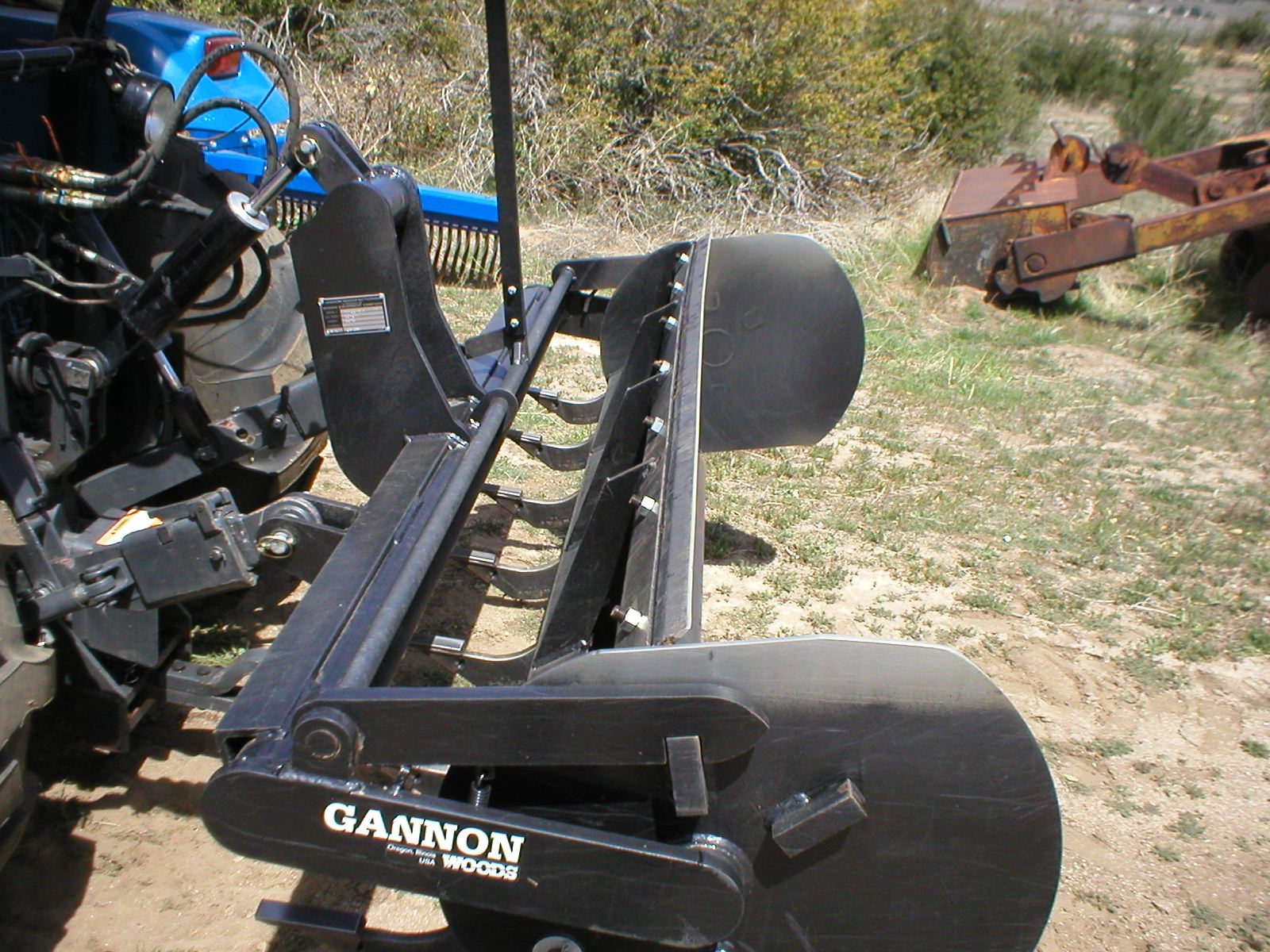

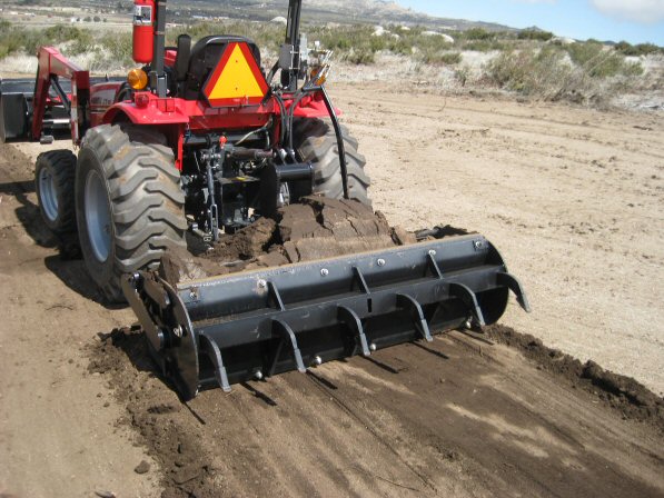

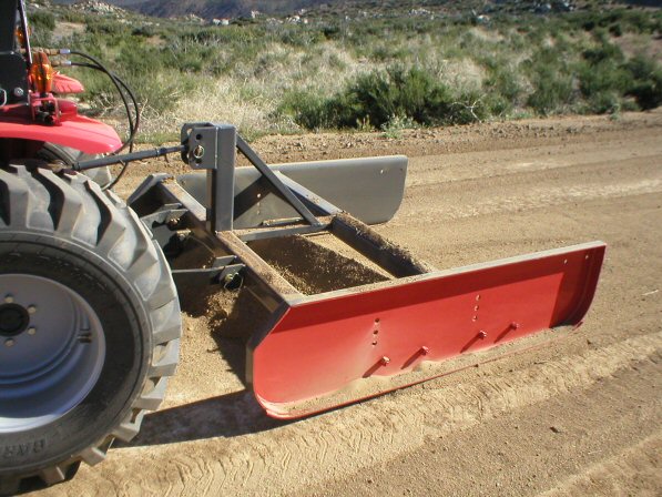

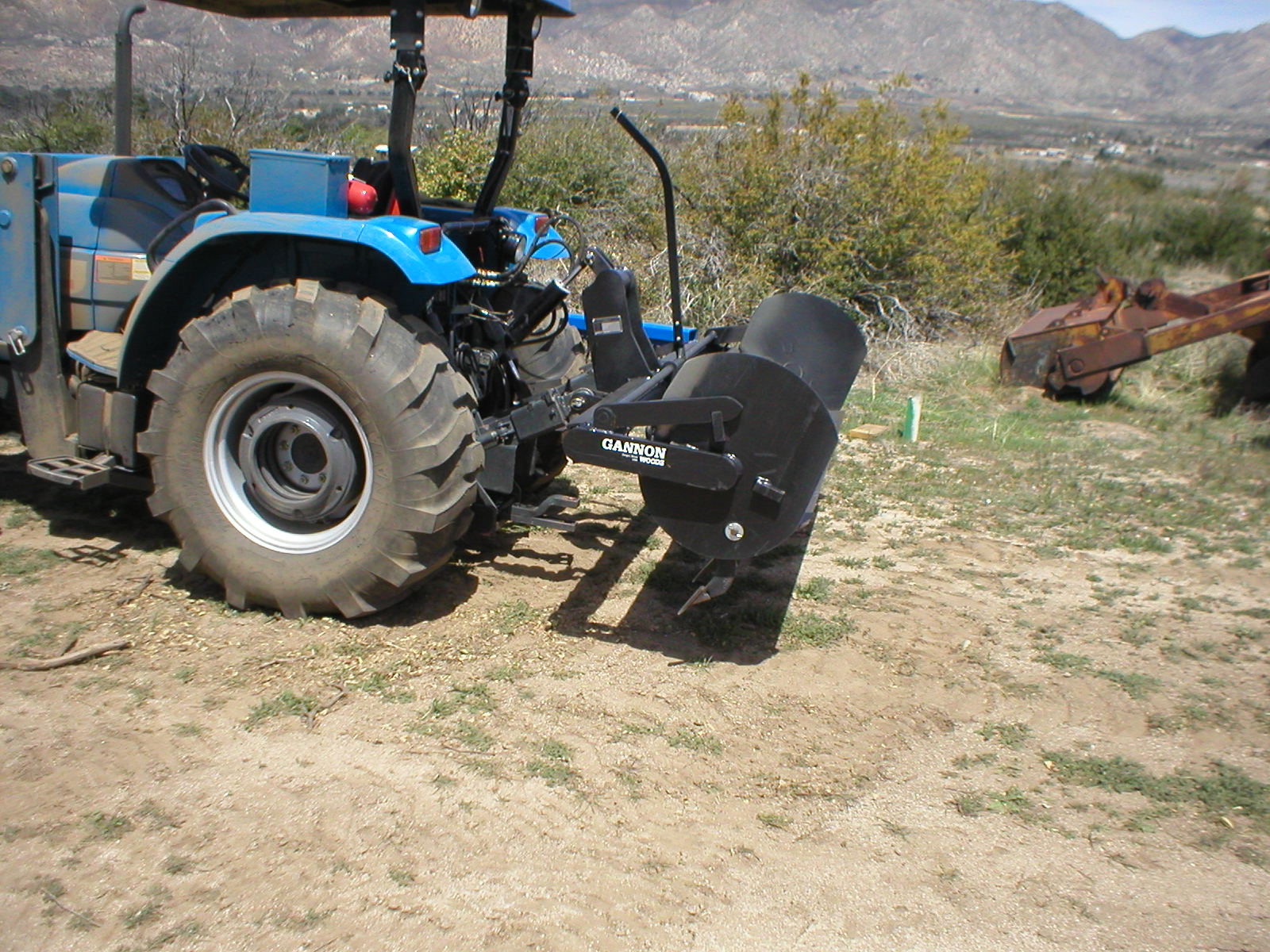

A perfect match for your tractor is the BLR55 of these ROBBs Just the right width, heavy and you can get the rippers in the ground from your seat, no hydraulics needed, and no stopping and putting each ripper down by hand.
You mentioned a driveway, you may want to consider one of these type implements for that chore, they work very well.

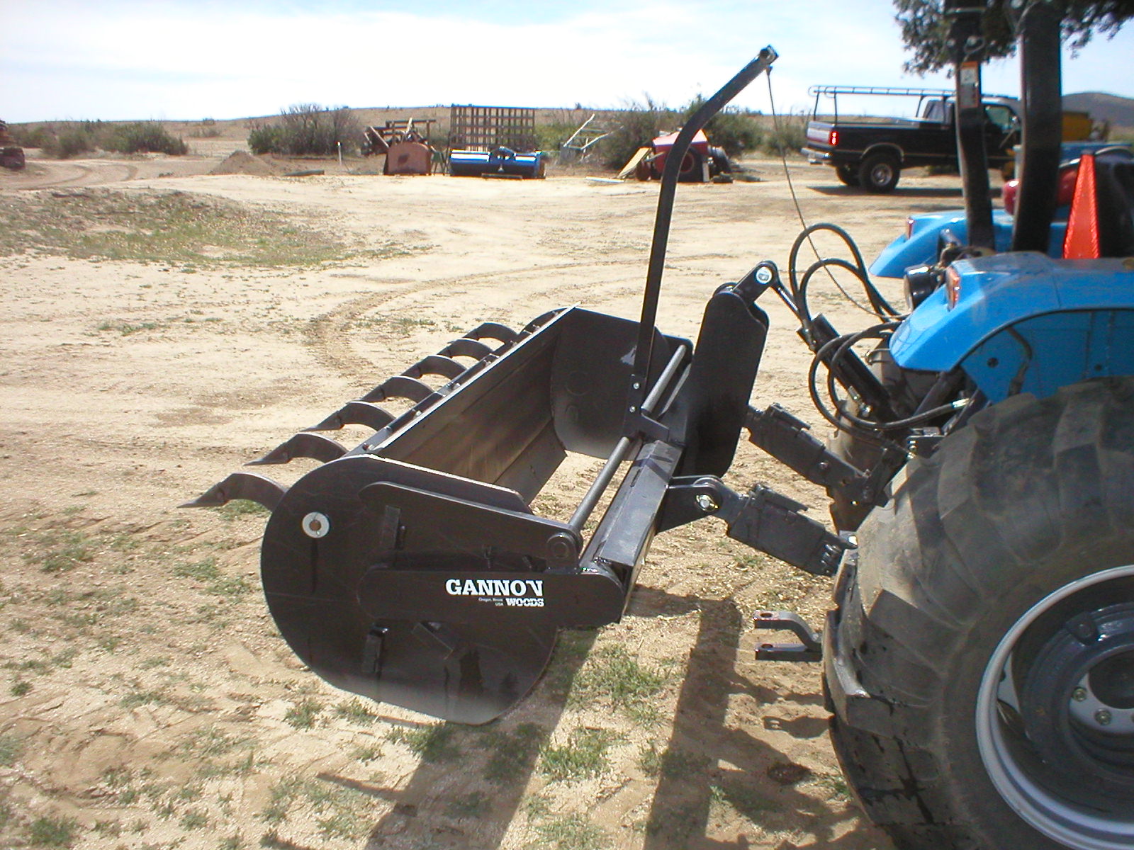

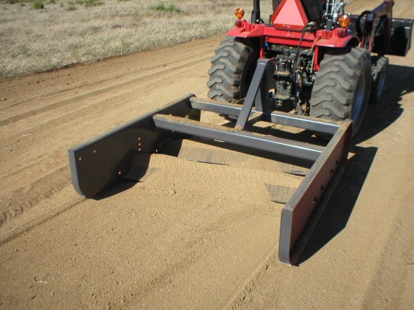

Other than back filling up tight next to a wall, they can do everything a box blade does. ROBBs are what used to be used on industrial tractors for the most part up until the hydraulic
actuated rippers became available, and then the commercial guys went to the hydraulic actuated rippers as they got new tractors with rear remotes to control top & tilt sets as well as the rippers.

I have the same tractor as you, and I would say the 680# 72" medium duty box blade would be fine. The tractor has a lot of power and unless you were really pushing it, I think you would have no trouble. You would know it was back there, but it would handle it. Don't go light duty, I have a 84" rear blade form TSC that has bent back edges from snow plowing and light grading. It was 220# abt and the CK doesn't even notice it.
