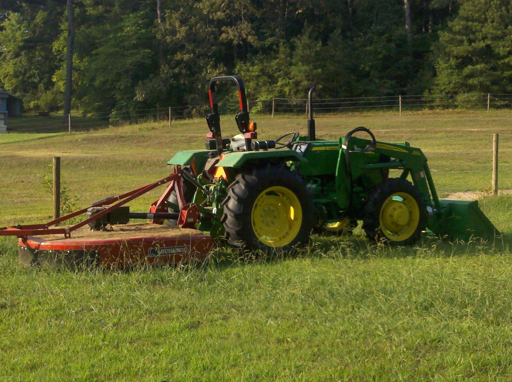

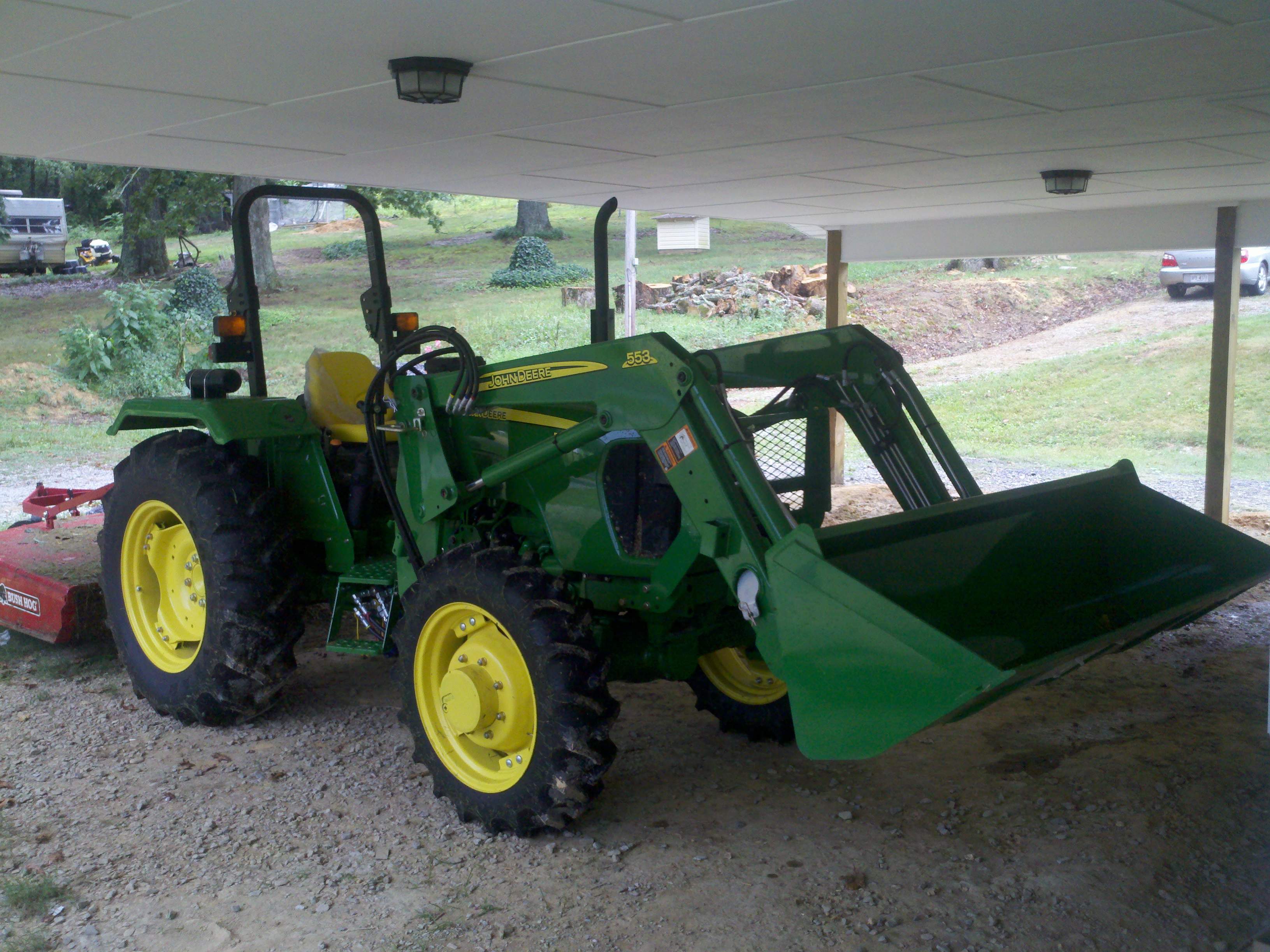

My 5055E was dropped off Saturday morning and I can not be more pleased with my decision. Not a lot of bells and whistles, just a solid running machine. :thumbsup:
