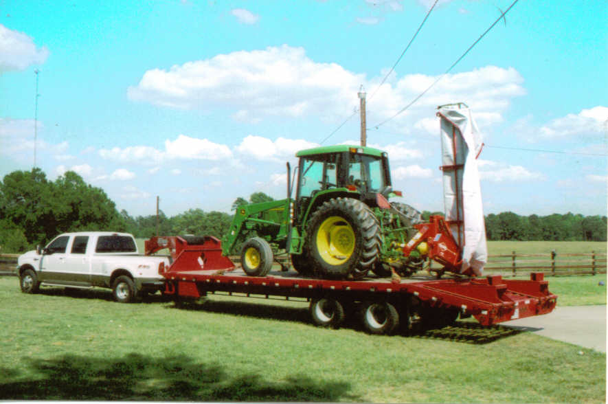

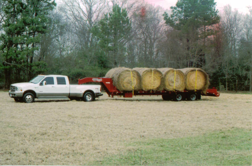

I have had a 3/4 ton diesel (SRW) and now have a 1 ton (DRW) diesel. I have a 12,000 lb gross weight trailer with 4 wheel electric brakes. I would not be happy with much less truck with much over 5-6000 lbs behind me. I don't care wht the manufacturer's ratings say, It is my BEHIND that is behind the wheel when some bozo cuts me off when braking to a stop around a curve with a tractor on the trailer with 1300 lbs of box blade and FEL. This isn't an issue of convenience or economy that you have brought out for discussion. This is a clear case of safety and stability. Sure you may never drag race your truck with a loaded trailer on behind but if you don't have enough OMPH to safely accelerate to speed and merge into interstate traffic then you are an accident waiting to happen. I suggest an exhaust brake too. - - - - - - Pat
