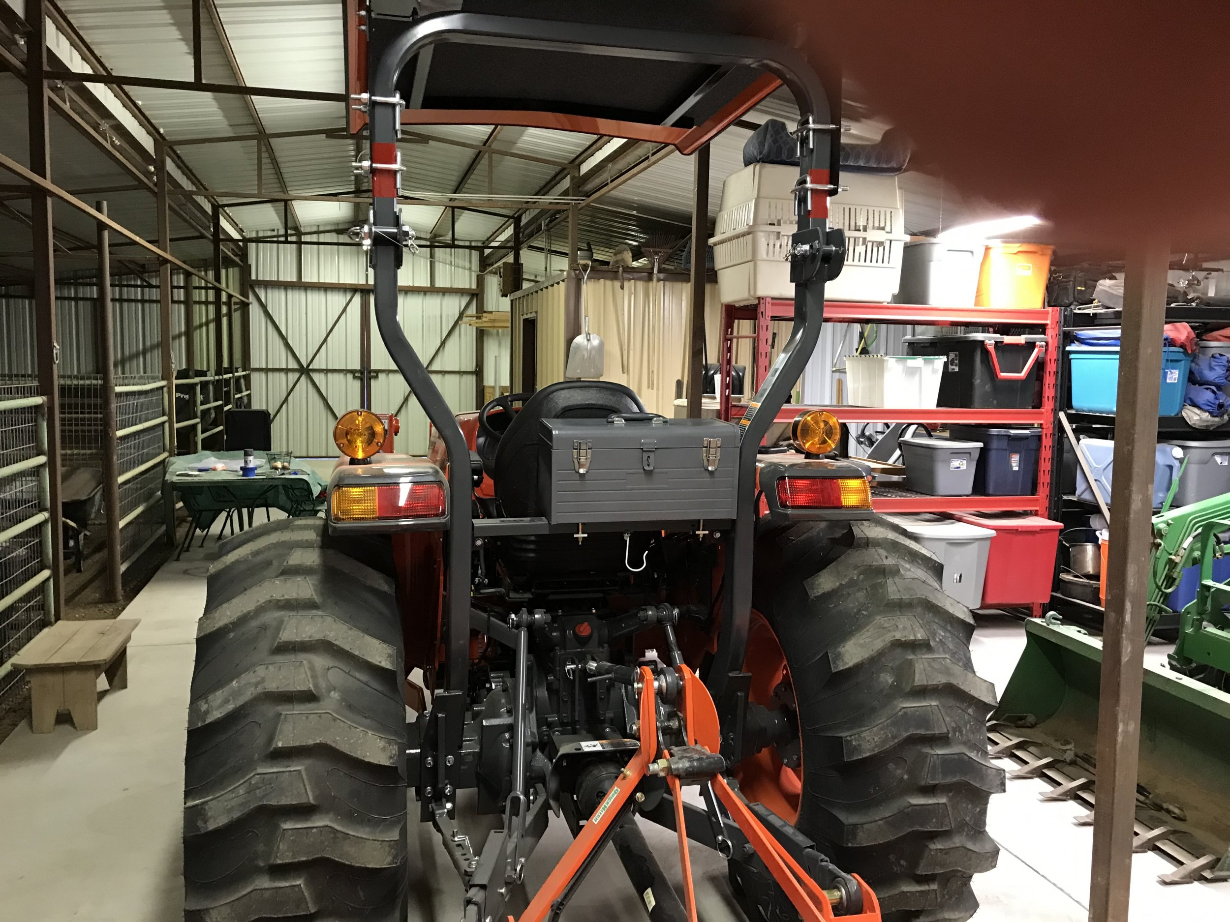

I’ve got a Kubota so I dont need any stinkin toolbox
I have been looking to see where I could mount a toolbox that wouldnt be in my way.
The one that came with the tractor will barely hold a pair of goves.
   / Which tools for tractor toolbox? #58
See what I did to my Kubota.
