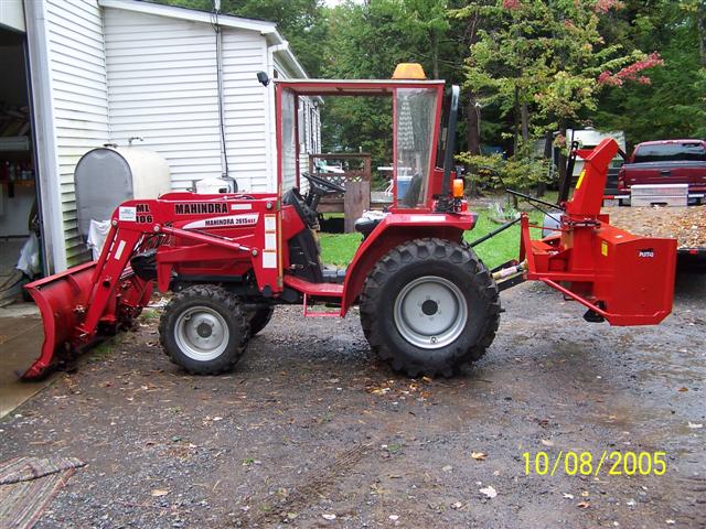

I have the Puma 64" I use on my Mahindra 2615HST. I like the blower. Seems to be well made and at 540 PTO RPM it throws pretty good snow. Good luck on finding one.
