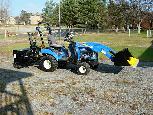

They are all mid mount 2 stage snow blowers.
You could purchase the P680 snow blower and mount the entire snow blower
on your loader with a SSQA plate using a ROTAX 23 horsepower go cart engine
to power it and have enough torque to clear snow.
Leonz , i've been watching alot of vids on diverter valves, 3rd remote for FEL but l know the flow is not there for this. So lm looking at just what you mentioned. I have the quick attach and know l can fab up sometime self contained...
/ Which snow blower #22
The Rotax 2 cycle 23 horse engine is lighter and you will have plenty of torque to do the job using the Pronovost P680.
You will need to fabricate a mounting plate for the snow blower that will let you mount the Rotax engine or a surplus air cooled snowmobile engine off an old sled with its
pulleys and belt drive to the 6 spline stub shaft of the gear box. You will need a fuel tank for mixed gas and the muffler off the sled to run the engine and a hand throttle with a long enough sheathed cable to mount on the loader.

Honestly thinking of building one from older parts with a new motor as what l see looks like chinese beer can aluminum...
/ Which snow blower #26
Don't waste your money; you need the speed and torque a 23 horsepower
rotax engine will provide you with the new pronovost snowblower to spin
the impeller at 700+ rpm. The simplicity of a go cart or snow mobile belt
drive system is what you want and need.
/ Which snow blower #28
I would think a snowmobile engine is going to have an overheating problem when used on slow moving equipment like a snowblower due to not enough air flow to cool it down.
/ Which snow blower #29
The snow vac 2 stage design is a poorly designed snow blower that could be made much better in my opinion with few simple design changes
using the 33 horsepower ROTAX 2 cycle air cooled engines or the largest Wisconsin V twin engines.
/ Which snow blower #30
Nope, they work well in the cold and always have with the fan on the blower housing.
The forced air cooling system for snowmobiles has been a proven method of engine cooling
for many years just like the 4 cycle gas engine on a lawn mower or weed wacker.
/ Which snow blower
#31
I don't have a problem using a 2 over 4 cycle. Ran 2 strokes since the 70s and probably less weight depending on cc size. 4 strokes have good low end torque. Belt or chain, either is fine with me. I just think the older ones are built much better than todays. Gotta pay for heavy quality. I saw the Snovac. If l remember they were kinda high $. I enjoy building so thinking if l can find a good shape older blower unit and mod it with a new ( 2 or 4 stroke) engine, that'll be my route. I just want the unit to be able move some snow as mentioned with good rpm...
If there were more front blower options l might go that route and buy. Like that 64" Bigg Pigg. I believe $6500 was their sale price if their still building them. I know l can build a quality, reliable unit for less...
