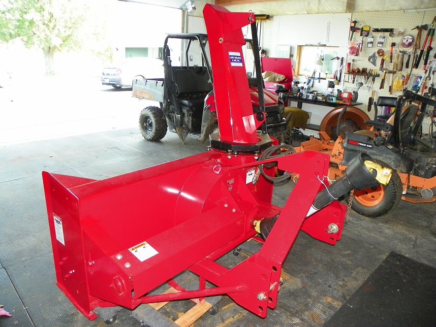

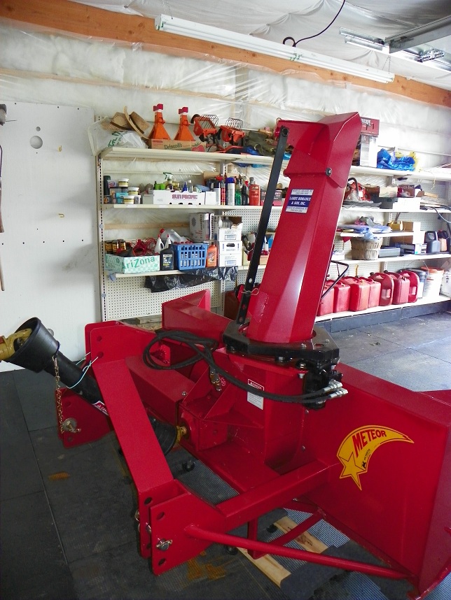

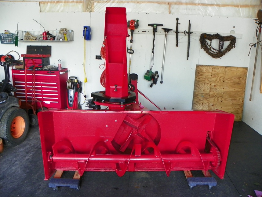

I just got a new MK Martin 75" Meteor snowblower. They redesign a number of things on the 2010 and 2011 models making the blower much better. It has a newer hydraulic chute rotator, a fan plate added to keep the fan from throwing some of the snow back out of the blower, a front chute cover to keep the veocity of the snow from dropping and the deflector is nozzle shaped now for better performance. Below are some pictures of the new blower.

That blower looks to be a good one.:thumbsup:
Thanks for posting the pictures.
