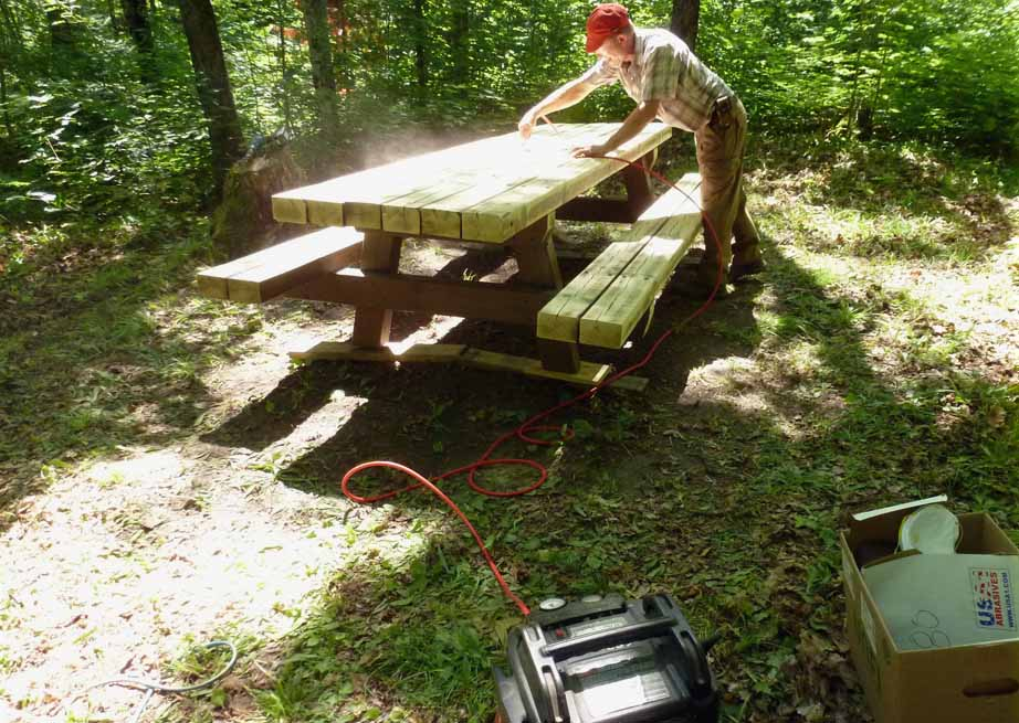

We have some large picnic tables we care for which are located at remote locations. The finish is starting to peel so they need to be scraped, buffed and refinished. For cleaning and buffing them I thought I'd bring my generator so I could use my 4.5 angle grinder to do that job with. We'd then blow them off with air compressor when done. What pads might we use? I thought about trying these soft pads in 120 grit.

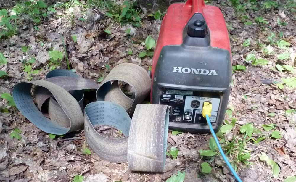

I use an old porta Cable 4x24ā€ belt sander with 60, 80 and 120 grit belts. Sand with the boards not across. Get a good grip, it will want to pull you across the table. It will cut the old crud off.
Once you get use to one a bit, it does not take very long to straighten up an old wood table top, steps, rail or deck. Just buy a box of belts per grit, keep the belts inside, they last a long time.

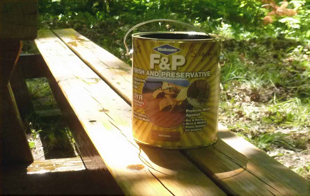

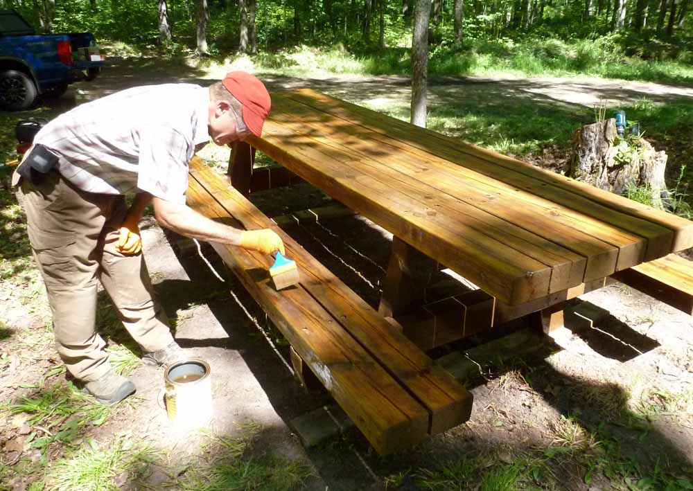

Got it done with 60 grit 4x24 belts and it took about 6 of them. They'd get gummed up with tree sap. It did get treated with preservative/stain and will post pics when I can process them.

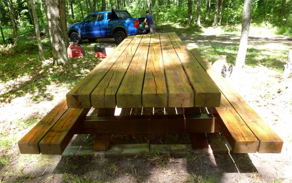

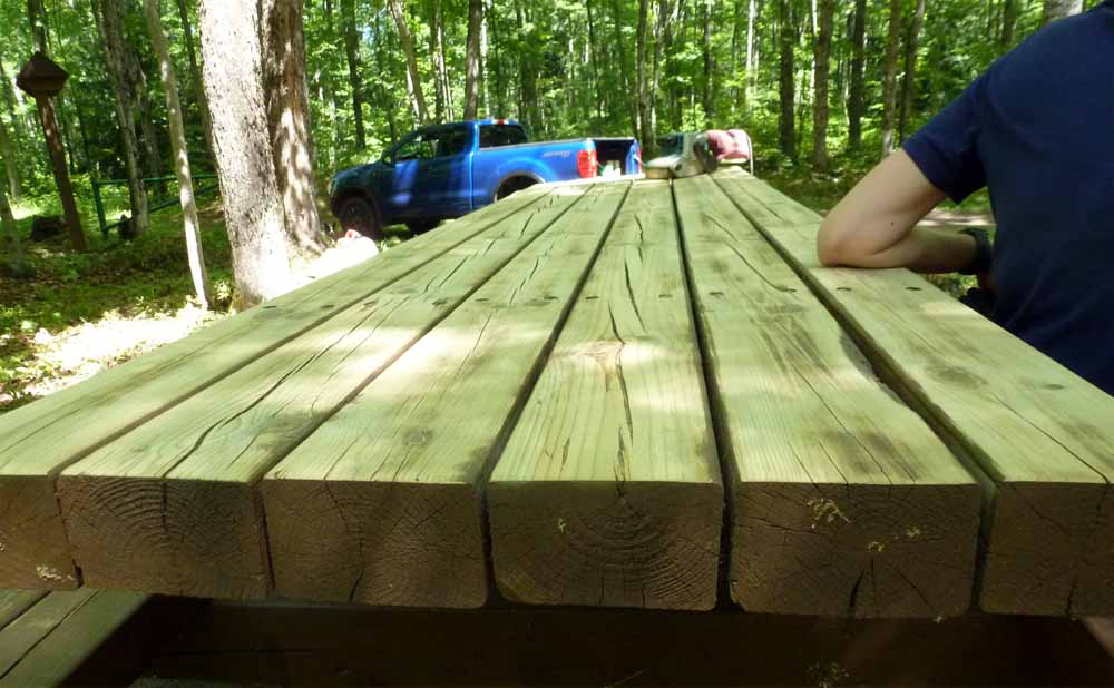

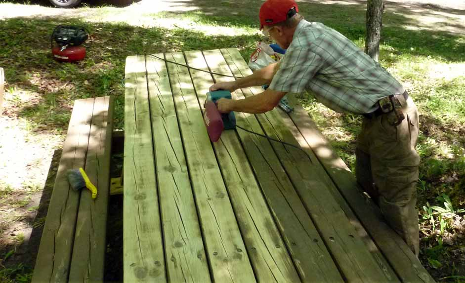

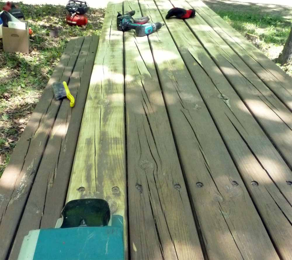

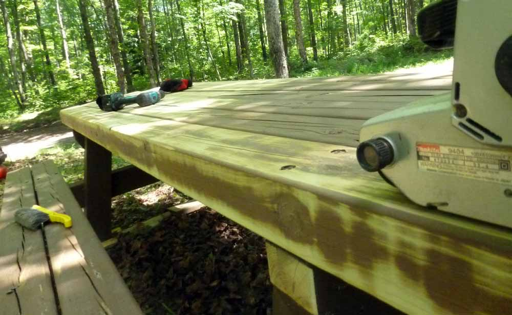

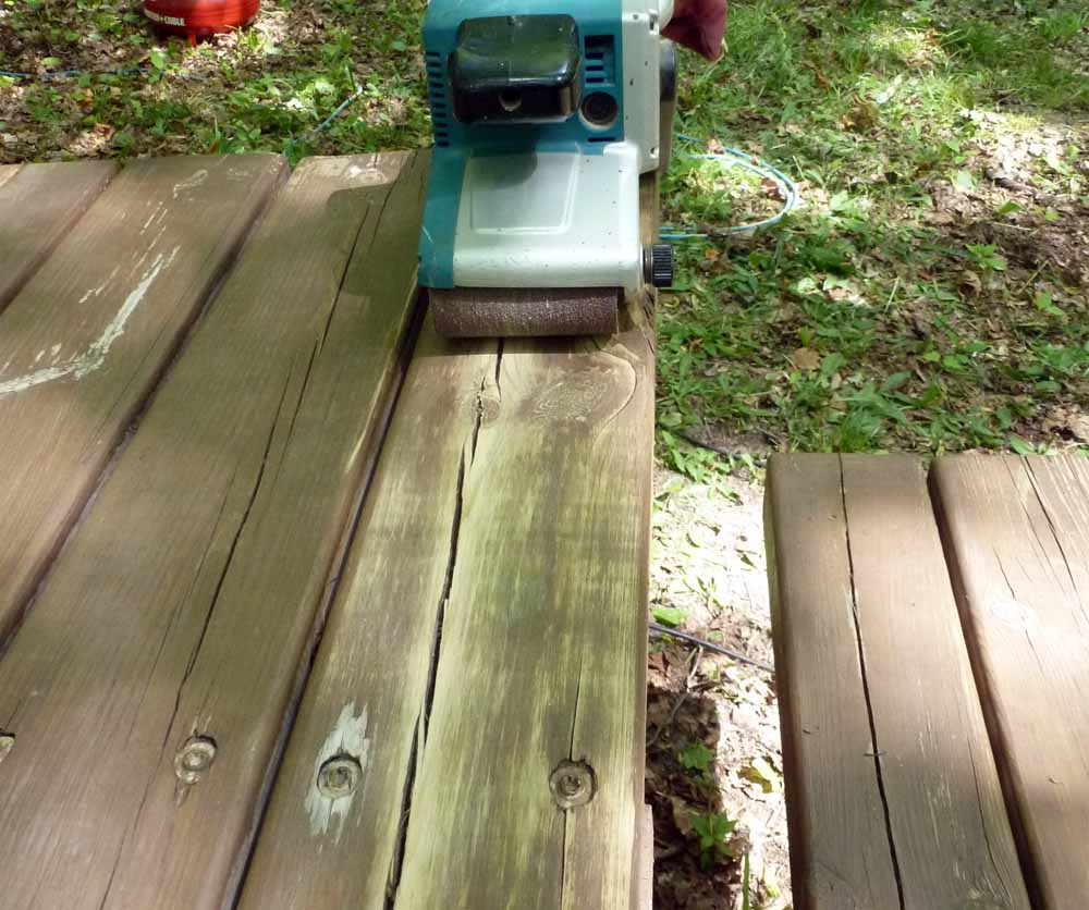

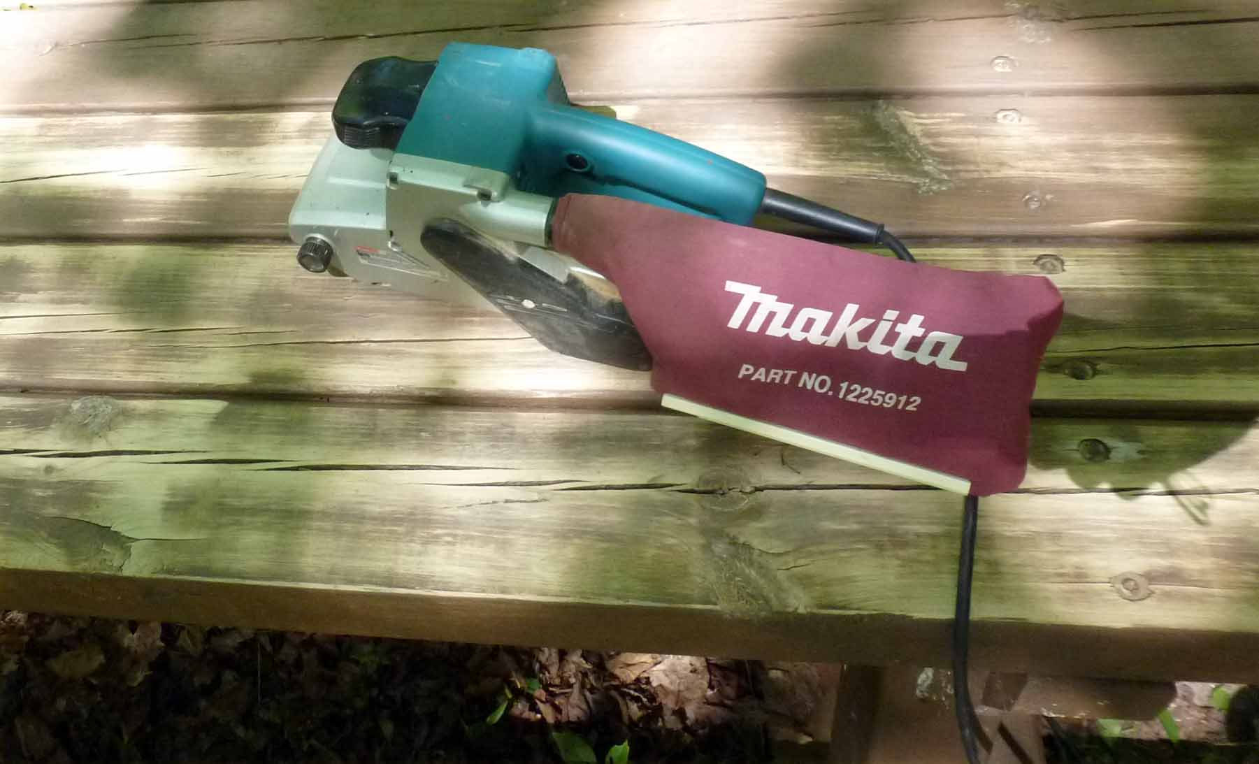

I few pics taken yesterday. Seems if we'd had used a orbital stander, we would still be out there sanding away. šŸ˜…
So much material was taken off, the 4x24 was the best way to go.
Who is the fine looking, yet hard working guy? 😁
