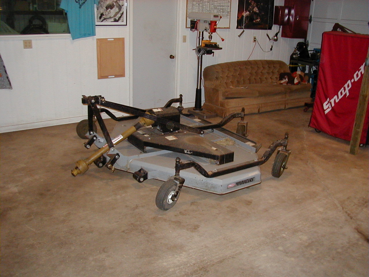

Whatever make of rear mower you go with, check out the location of guide wheels and if it comes with anti – scale rollers. I just purchased a new 60in Kioti RFM and it looks like all the rest. 2 wheels up front and 2 in the rear, rollers are an option. I find mine scalps and the rear corners dig into the sod on uneven ground. Earlier there was a post from a guy with a Wabco/Douglas mower, it looks like the right idea, 3 wheels in the rear, 2 up front and anti scalp rollers in the front. My two cents worth.
