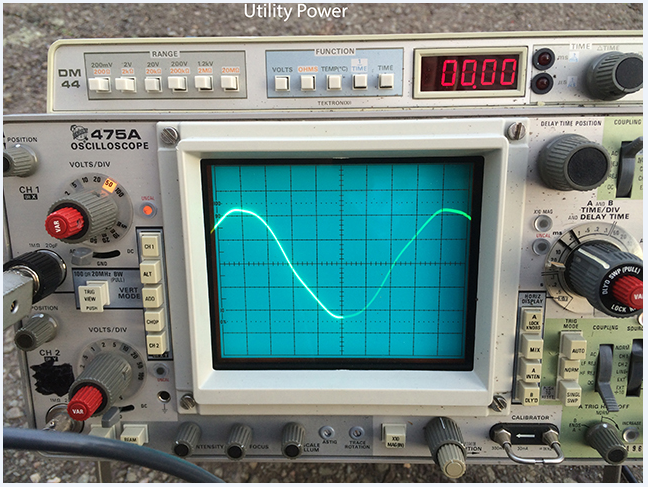

For some comparisons, attached are a couple of my generators plus the output of the MP above, the inverter generator was running at 98% capacity in the picture, otherwise its cleaner then the MP as well.
That said i do think they are a nice genny and will prolly work flawless with everything you own, i would like to see a frequency hold via a meter, which the video did not show
the ELM3000 had about 500 hours on it, and ran electronics i still use today including tv's computers and refrigerators, so how much damage was actually caused? not sure
take a look
and what utility power looks like

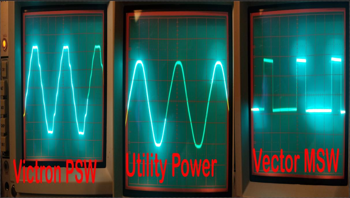

This group of photo's are from 2 dc -ac inverters,
There is pure sine wave, and the more common modified sine wave. again, i have used a MSW inverter for a long time and all computers are still working fine, i just picked up a PSW last week, photo's for reference again. so how much damage is really being caused? alot of people make you think it will be destroyed in minutes, voltage and hertz stability is generally more important. at least in my experience.

unless you have something with 30+ year old ferro-ressonant power supplies, most newer computer power supplies are switchers, and freq and voltage fluctuations don't bother them much. 50-ish to 60-ish htz, and 90-260vac and they run fine.
As long as you keep a generator within it's load range, and it's rpm, thus frequency is correct, then the sine wave should be near perfect . they still do it the old fashoned way.. magnets/e-mags and balls of copper..

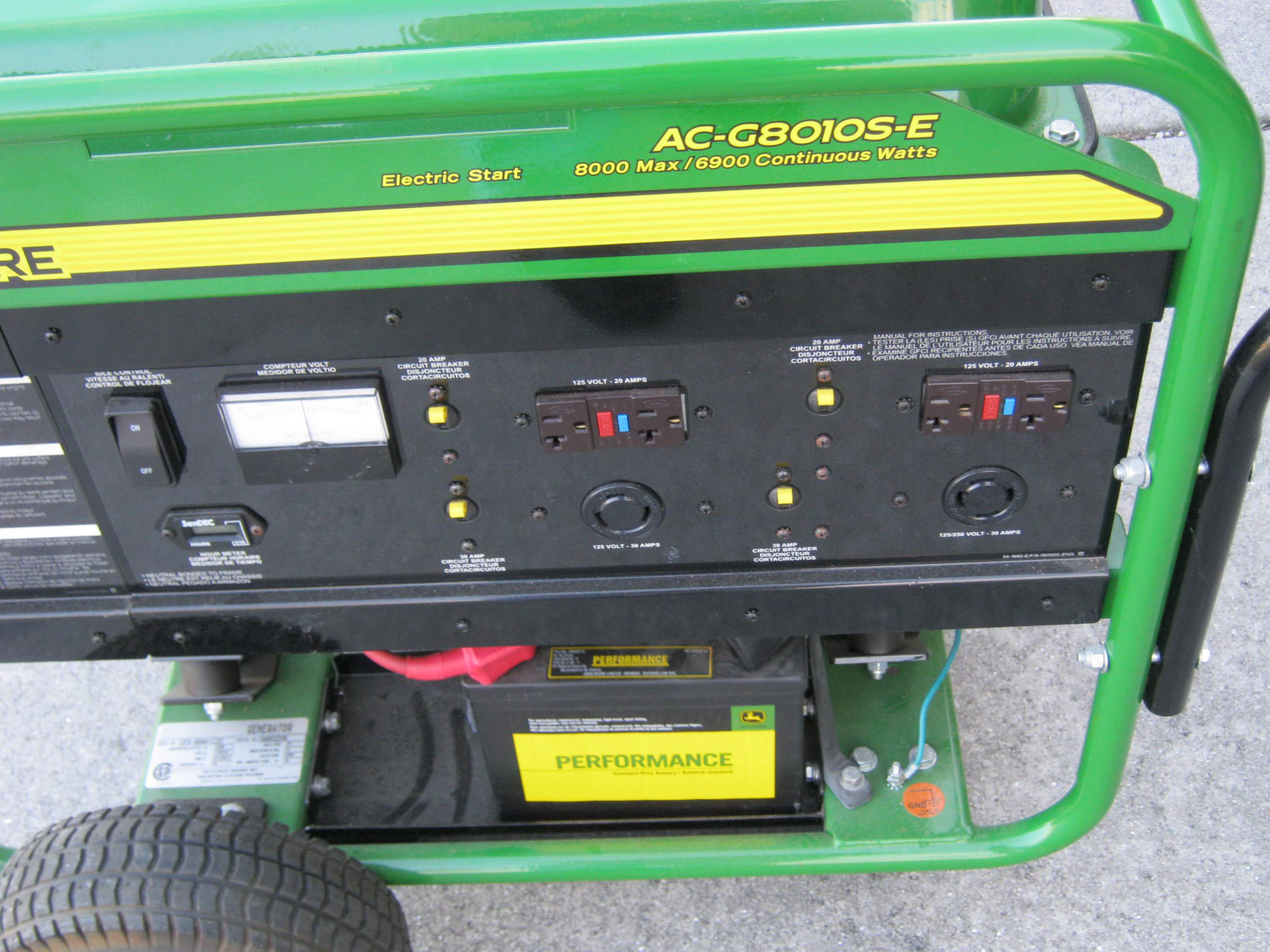

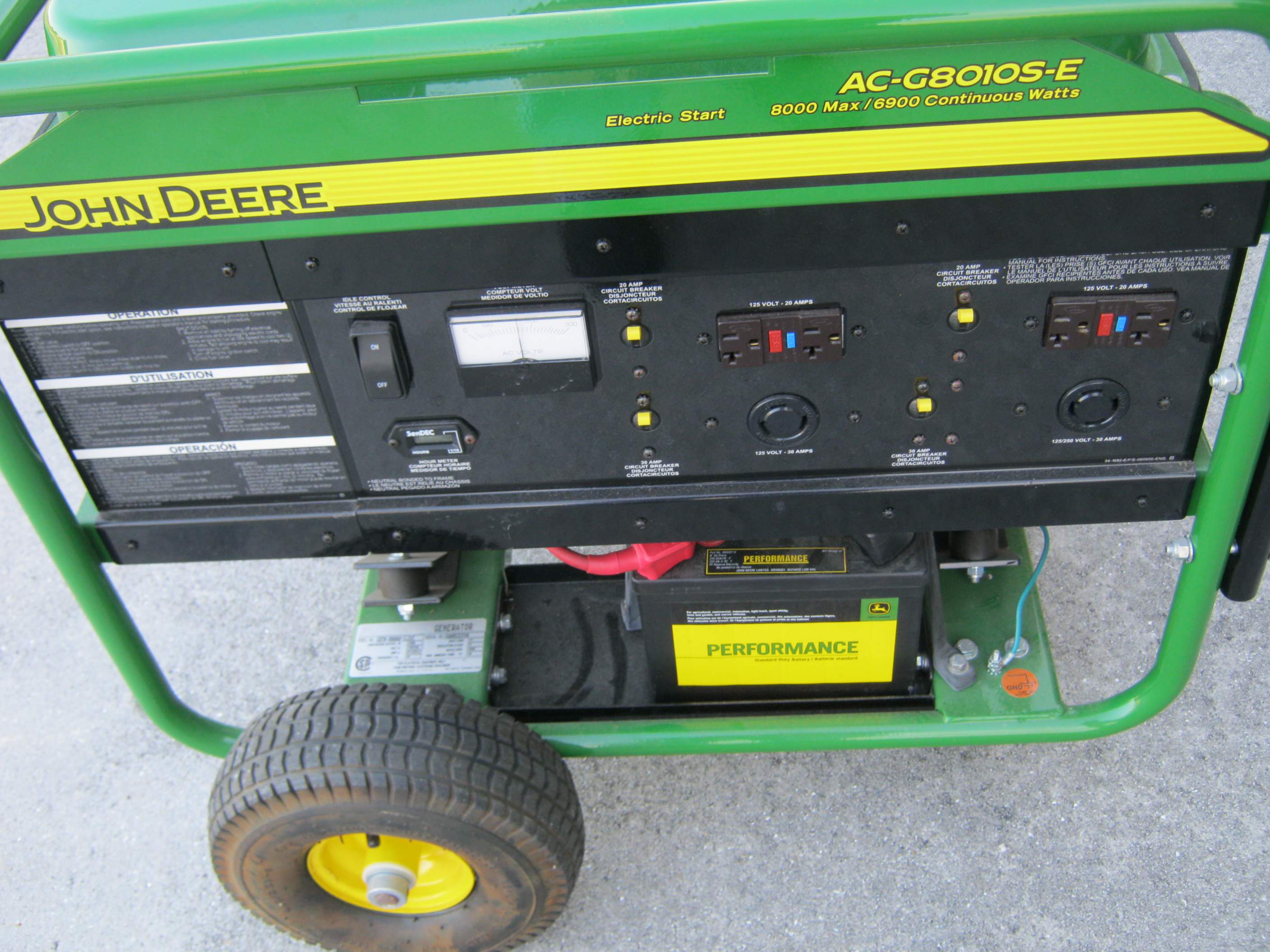

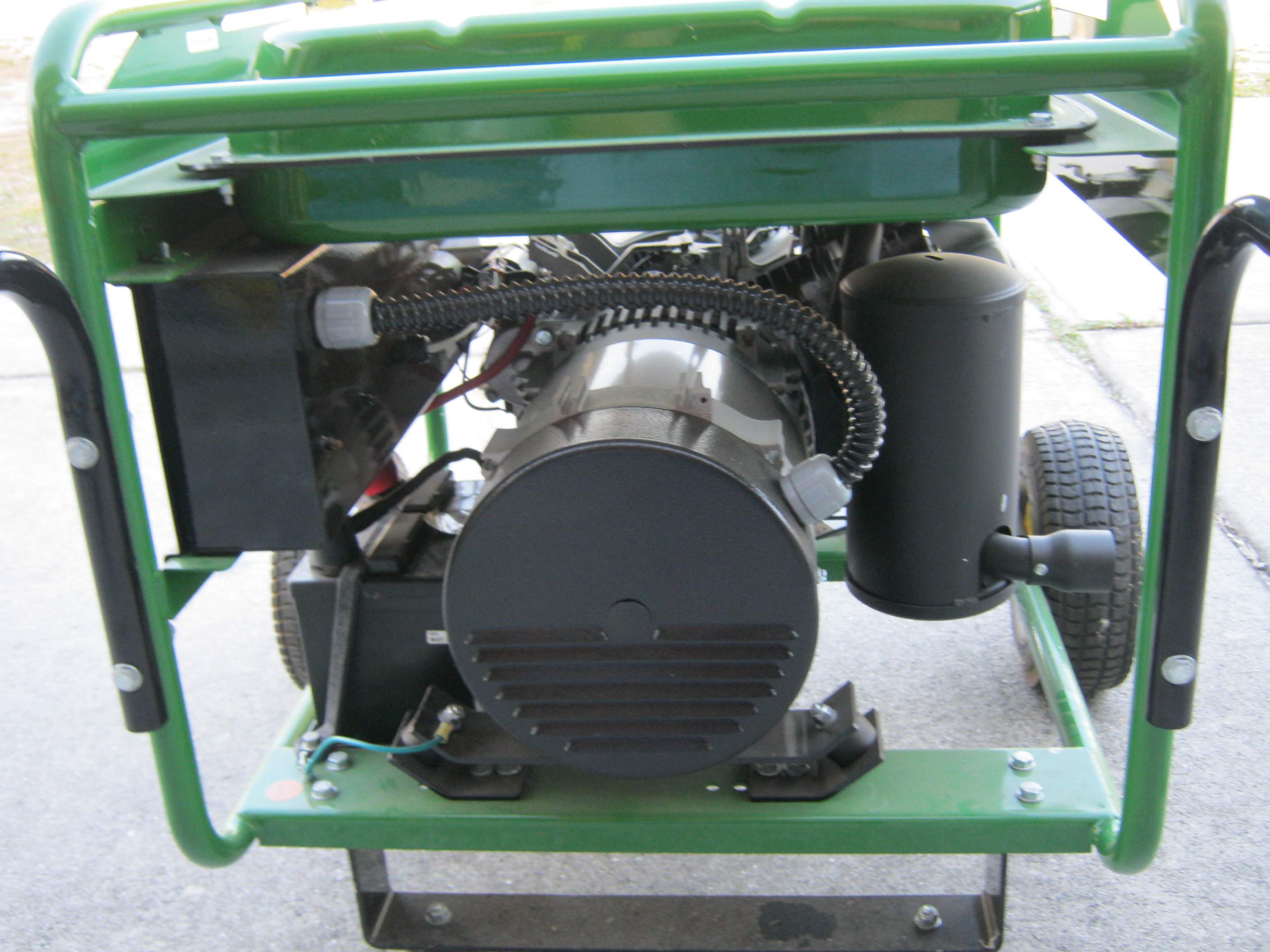

Yeah old thread I know ! Sold my Yamaha EF2400iSHC some days ago dureing pre Dorian sw Fla panic .
Rite now down too my JD 404CC 14hp Subaru powered genny . From what I hear Subaru for rite now not makeing gennys .
That dang Subaru powered JD of mine been a beast of a genny . E start n recoil bk up . Never given me a lick of trouble . No oil filters on them . I change the oil before OM specs , no biggie . You dont see many of them around , some even came in yellow .
If your ever in need for one and run across one priced rite imo dont be afraid to buy it .
