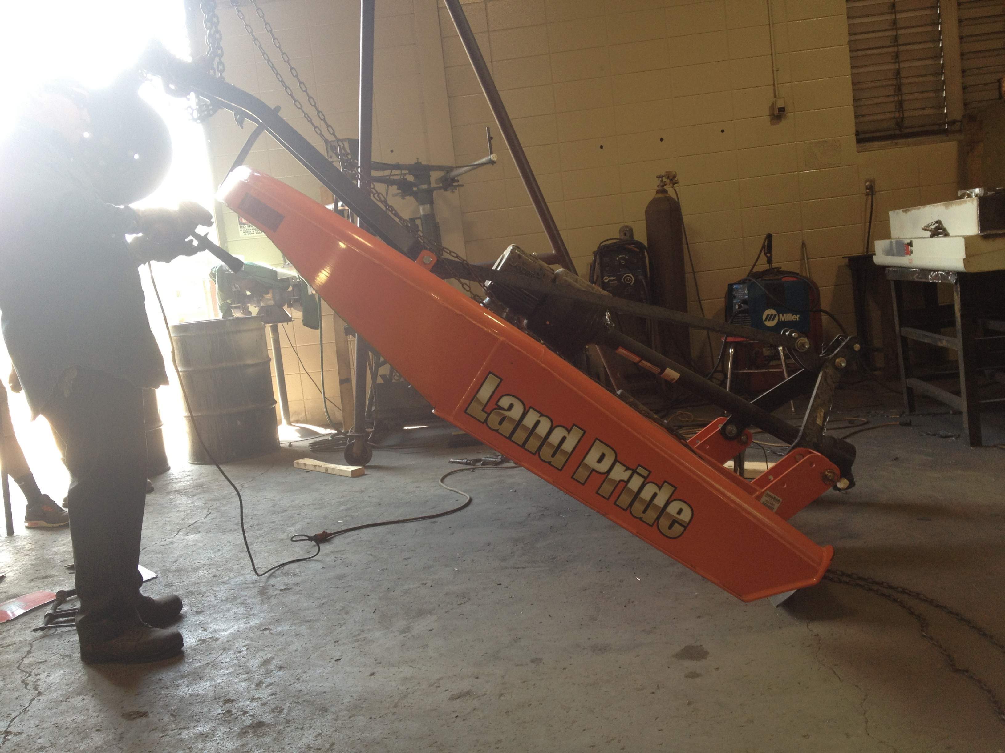

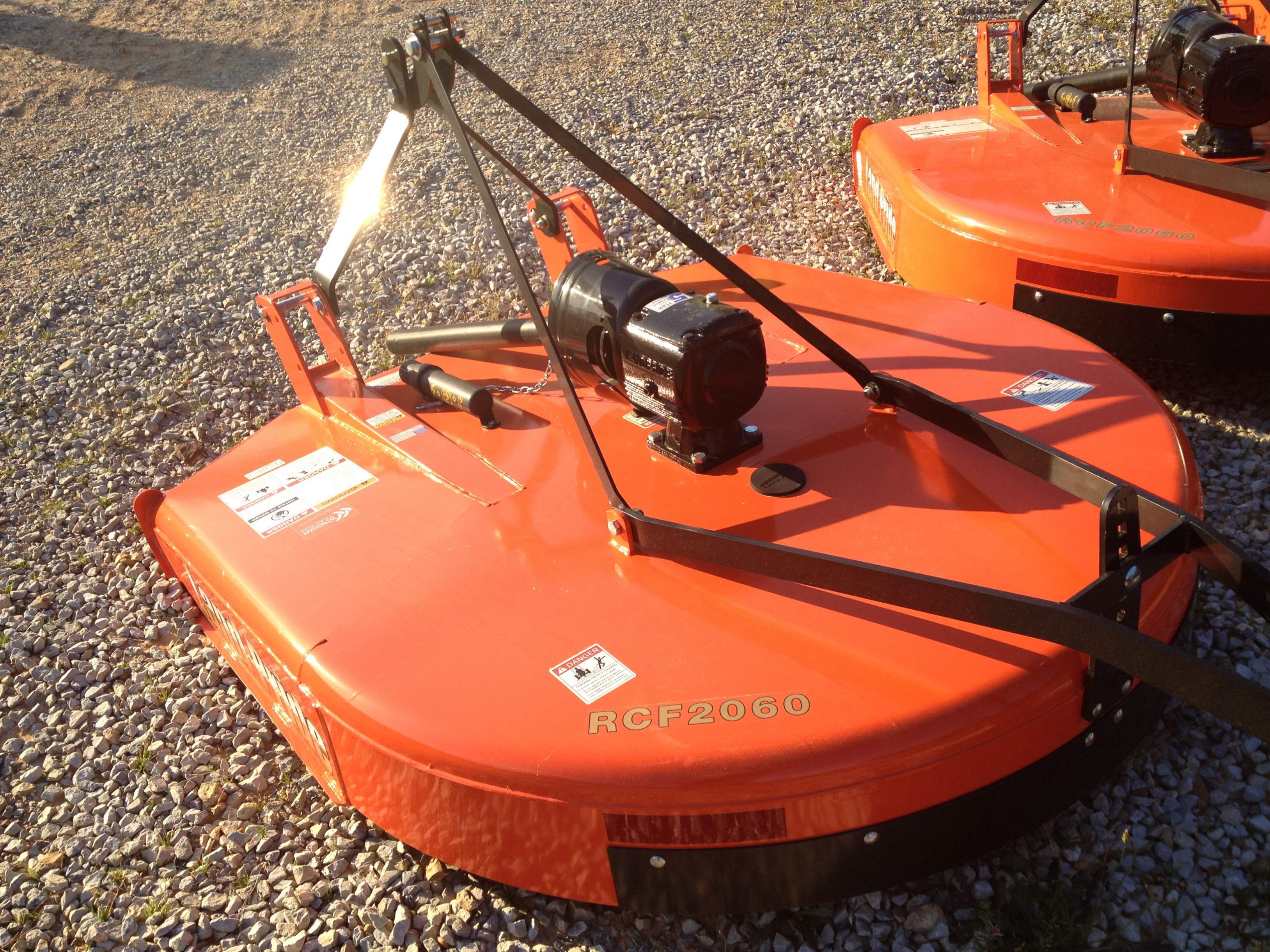

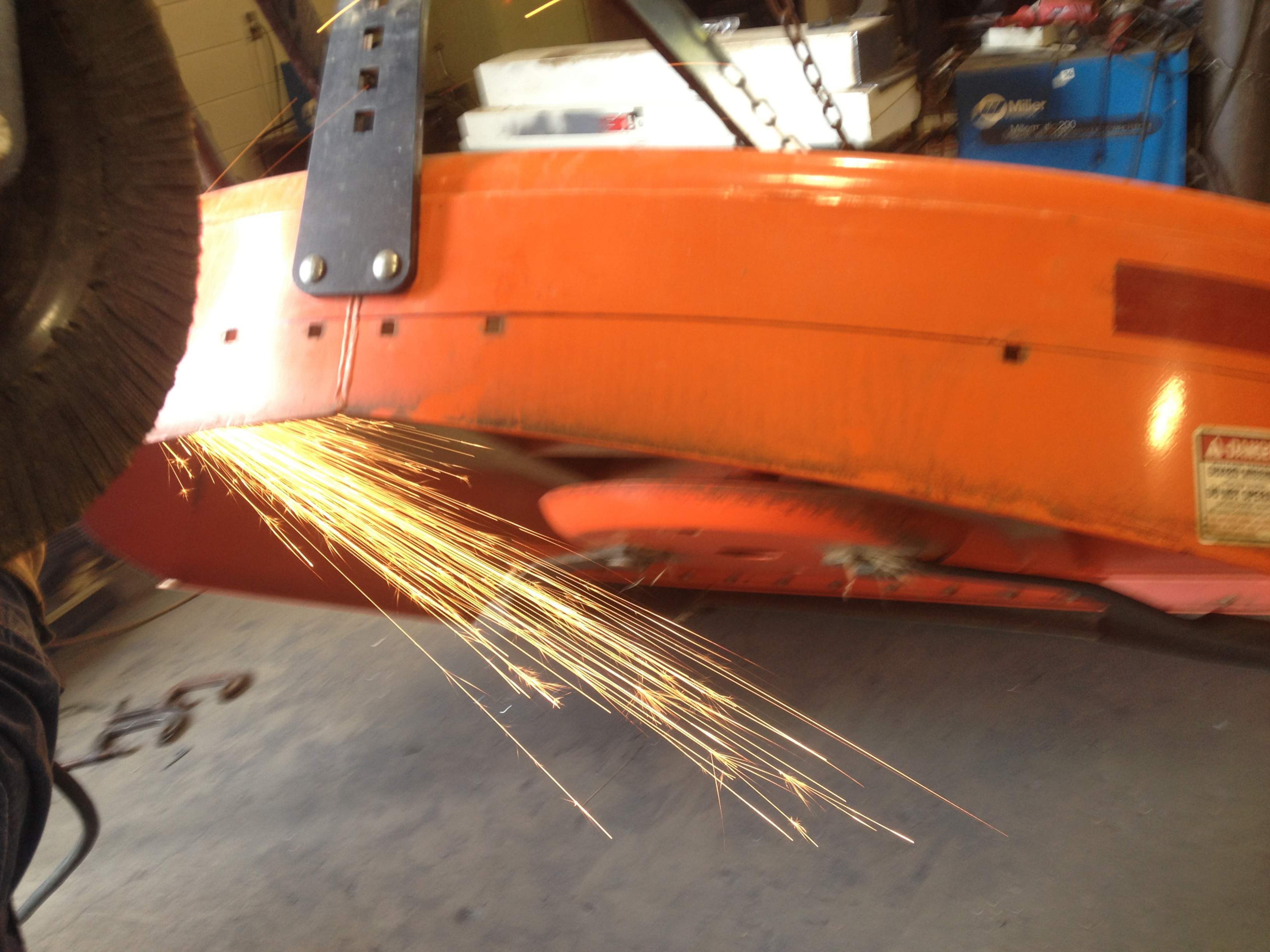

First pic is a new LandPride 2060 on local dealers lot
Second is my buds 2072 that is a week or so old with 3 hours on it
After cutting rear down
   / Which new cutter???
#26
In my first photo of the new2060, you can see the black guard totally covers the rear outlet. We thought if you removed it we may be able to get some clippings discharged better.
Photo two shows how we are cutting the rear out. Removing the black cover helped non that we could tell.
Photo three shows how we cut the rear down. Next week it gets reinforced and painted then we will see if any of this helps.
I guess all my posts are for one answer: do any of these other new cutters have the back totally blocked off like the LandPride? The Ag teacher told me he had to cut the back out of a John deere mx6 for it to cut as well.
I hope this shows what we feel is the problem
