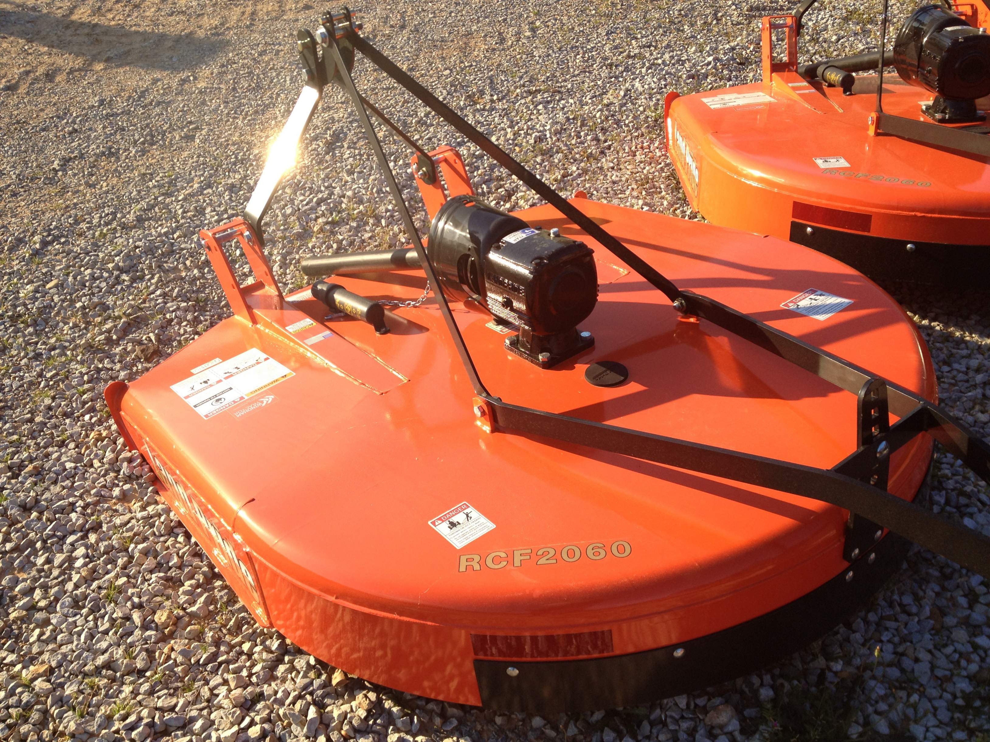

You are on the right track as to width and weight at least in opinion, I run a Land Pride RCR2672 on my L5740 and really like Land Pride products, the RCF2060 looks like it will fit your tractor and needs. It lists "up to 2 inches" and their specs are pretty conservative. Mine is rated "up to 2 inches" and I have exceeded that without any noticeable effect though it makes quite the racket. Cutting as you describe will present no problems. Bush Hog also makes good cutters, I just don't have have recent experience with them and my Kubota dealer handles LP, so that is what I get though we do run a Woods 10' on our M8540.

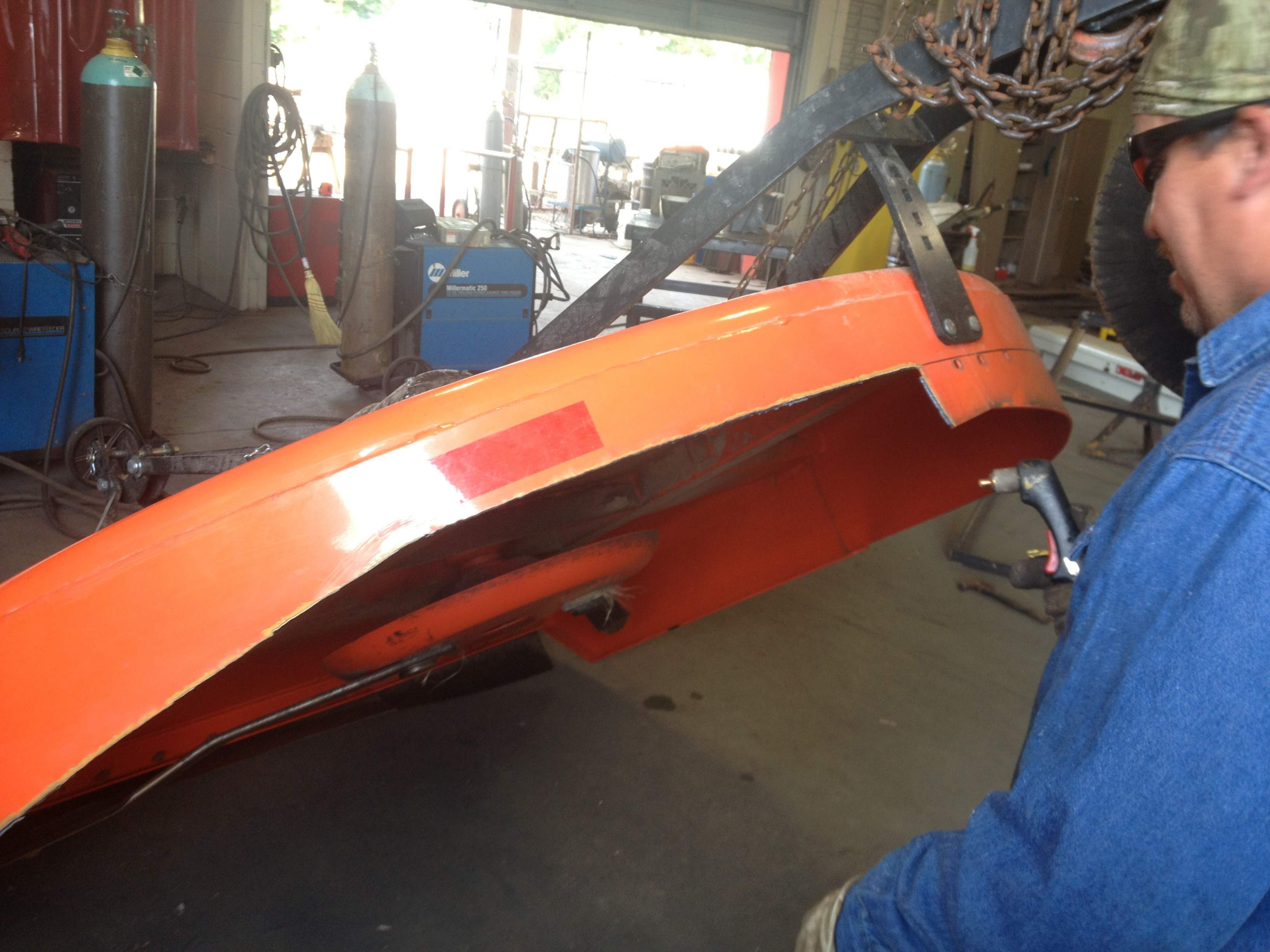

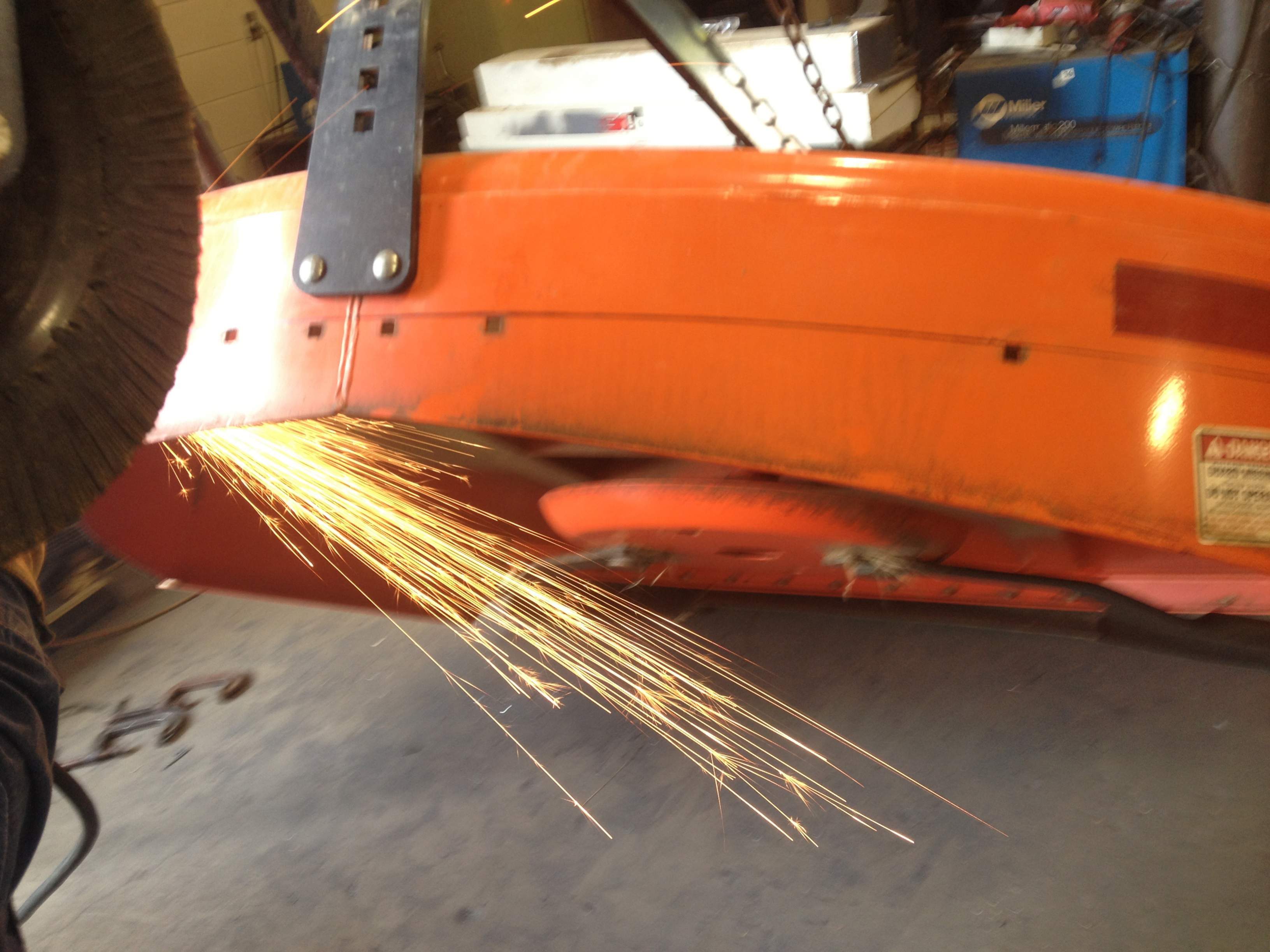

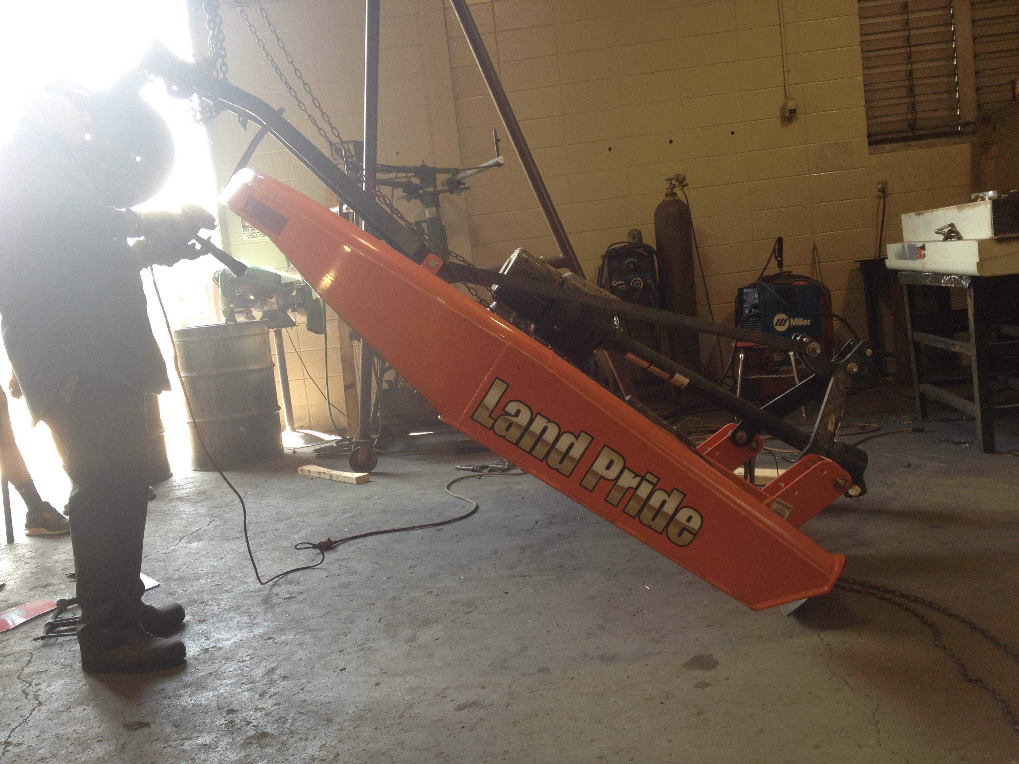

The only LandPride brush cutter I have ever run was within the last week. It was a brand new 2072 6' medium duty cutter. I like the way it is built and it did cut well. However, the rear of this cutter seems to be more "covered" than the other round back cutters I have seen. It had an additional black shield on the rear that I assumed was adjustable to release the cut grass/brush. I was wrong. It is not adjustable and my friend totally removed it trying to gain a "relief opening" for the grass to discharge through. This is we're I was not impressed with the LandPride unit. Not sure if this is technically right, but it appears to me that the design is to create a type of vacuum to keep the clippings inside of the cutter and mulch them up. That in itself is ok but where we use a cutter it is usually tall and needs to be discharged away from the cutter instead of recirculating inside the cutter. My theory is that This caused the tractor to bog down and actually ran the temp gauge up causing the operator to have to shut down the tractor to an idle while the tractor cooled off. My friend disliked this so much he brought the cutter to our vo-tech Ag shop and had the back cut out opening up a relief for the grass to be discharged. I/we are hoping this will make it quit bogging and run cooler. The cutter itself is great. I like the design a lot, the clevis hitch is strong and the gearbox is bombproof. It just needs some help discharging the grass.
That lead up to the newest post from me. If the woods has a way to discharge out the rear, that's probay the way I'm going to go. No disrespect at all to LandPride just not what I was expecting
