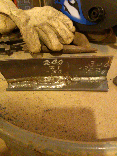

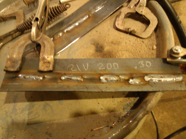

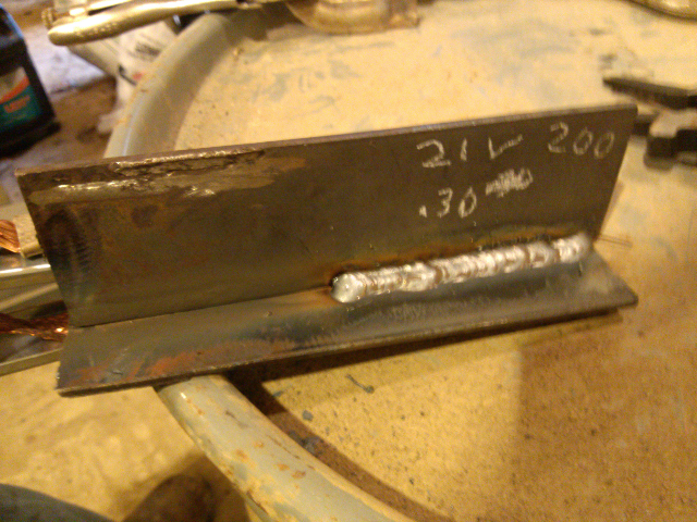

So taking the advice of the TBN braintrust I picked up a cheater lens. Wow I can see and that helped. I also picked up a better solid brass ground clamp and that made a difference. I also practiced some more and that always helps. Here are a few pics of the welds.
This is the jeep that I am getting ready to repair and upgrade. It has some rust issues but has a lot of life left.
/ Which MIG wire is the best.
#33
I also shortened the stick out. That also helped
