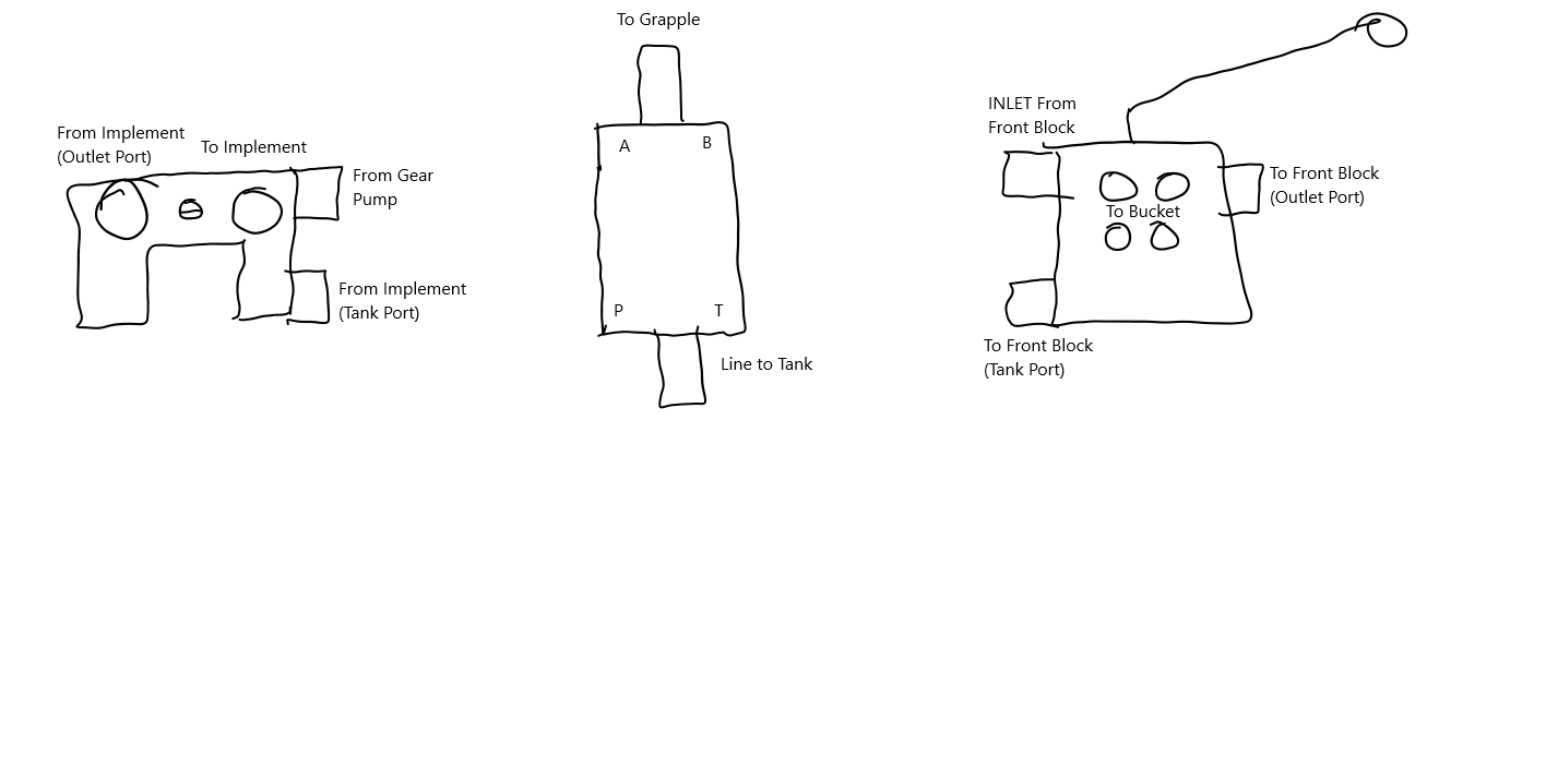

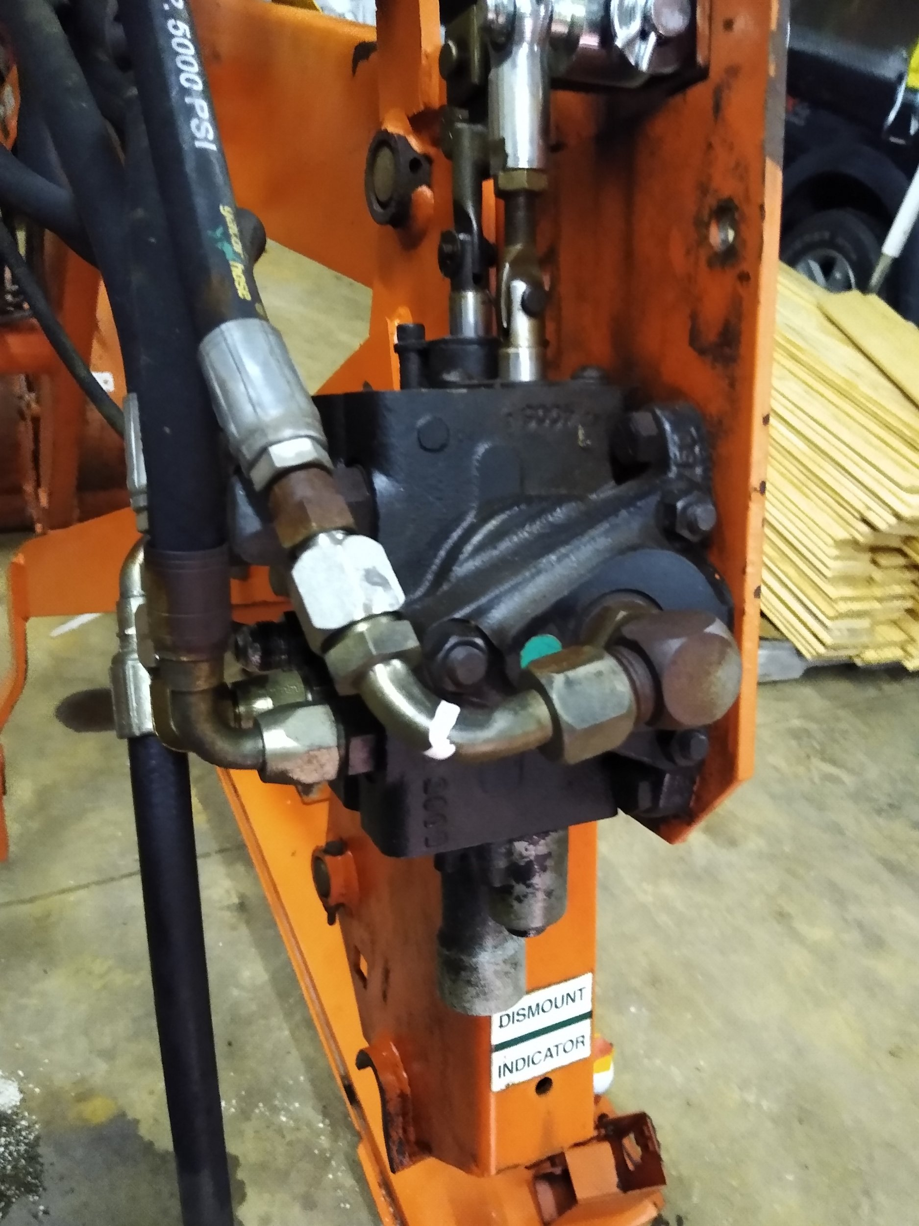

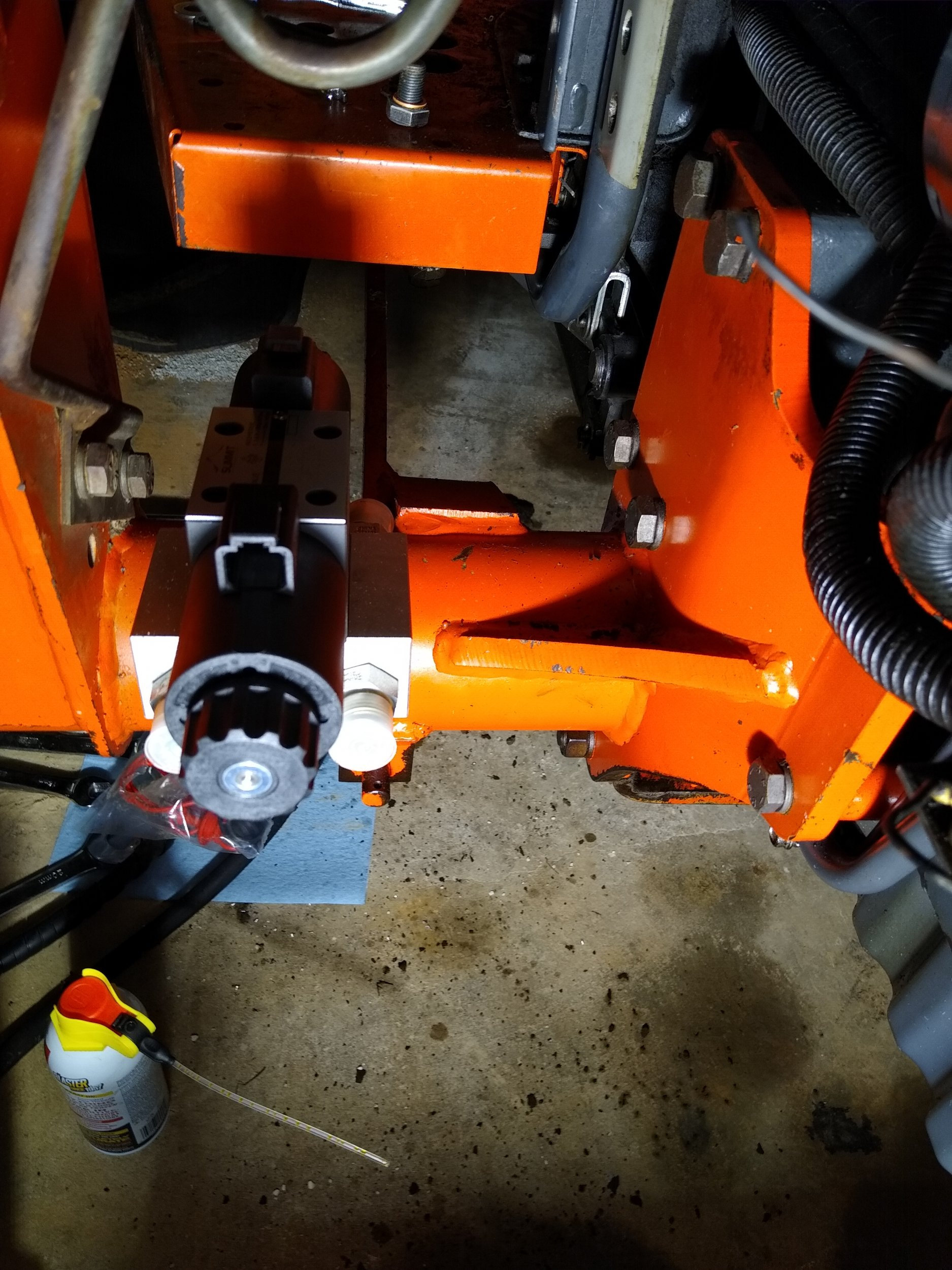

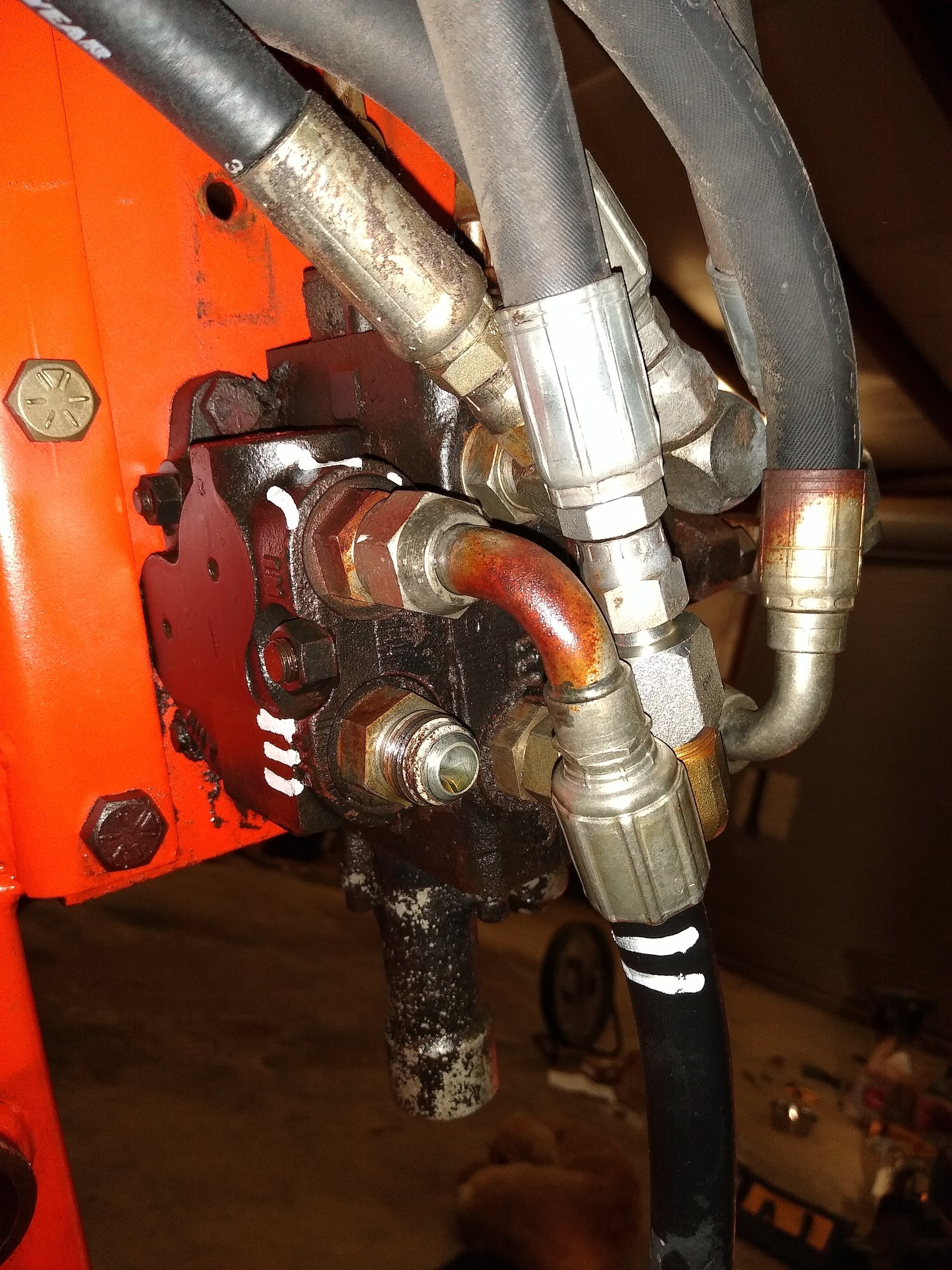

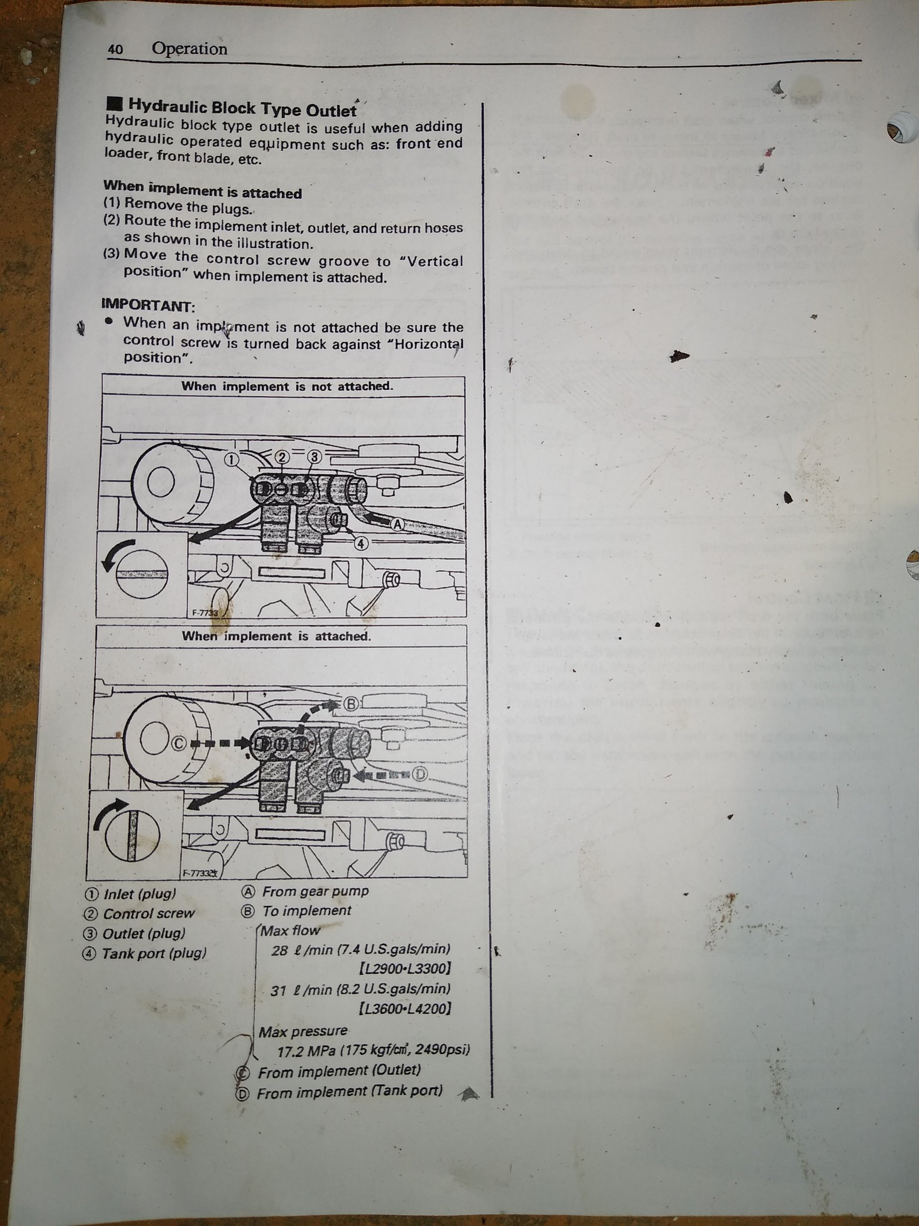

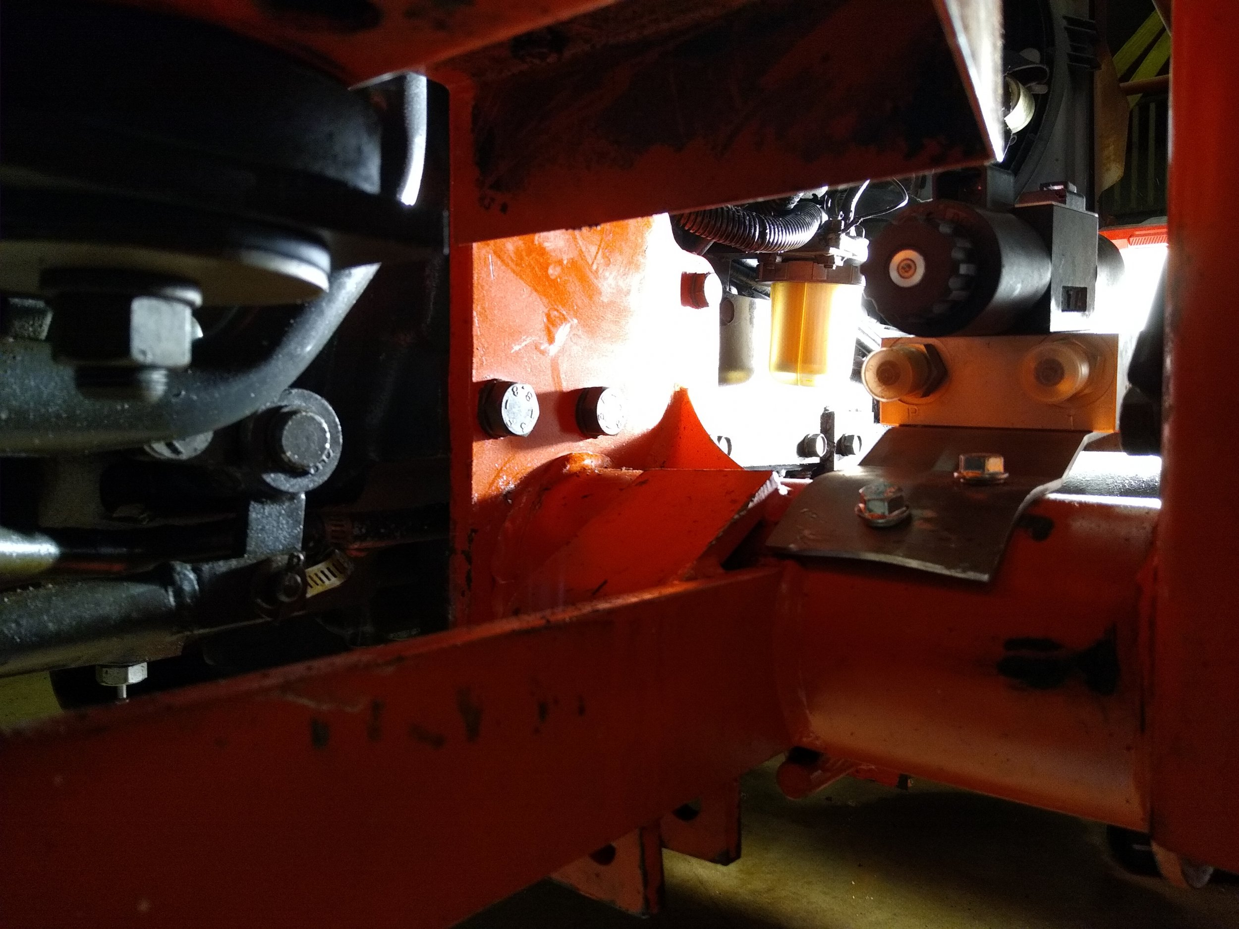

Alright, I got the summit electronic 3rd function valve mounted on my 90's Kubota L4200. The major question is, which lines go where?!
See attached photos and any help is greatly appreciated!!

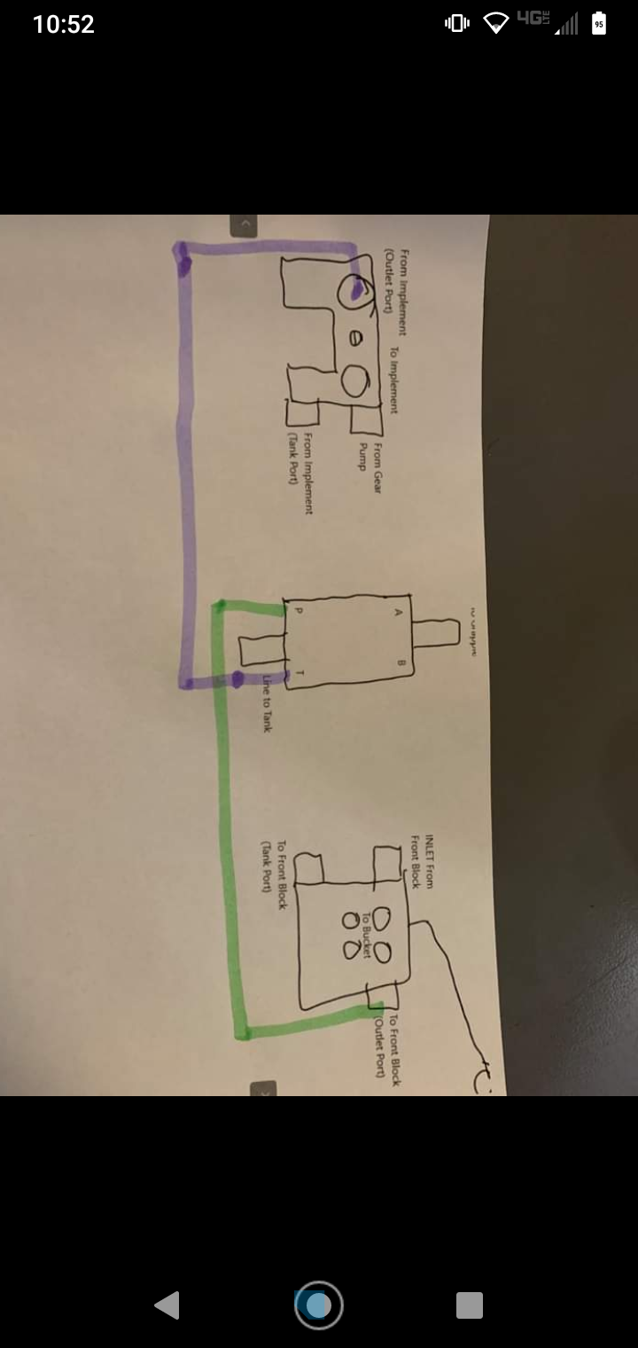

The new valve needs to be inserted into the line you marked as 1. The other hoses are not involved and need to go back where they were.
Take the hose marked 1 off of the loader valve. Install new hose from that port to the port marked In on your new valve. Then attach the hose marked 1 to the port marked T on the new valve. Now just run your work ports on the new valve to the grapple and you are good to go.
/ Which lines Where???? #4
Exactly like that. (y)
