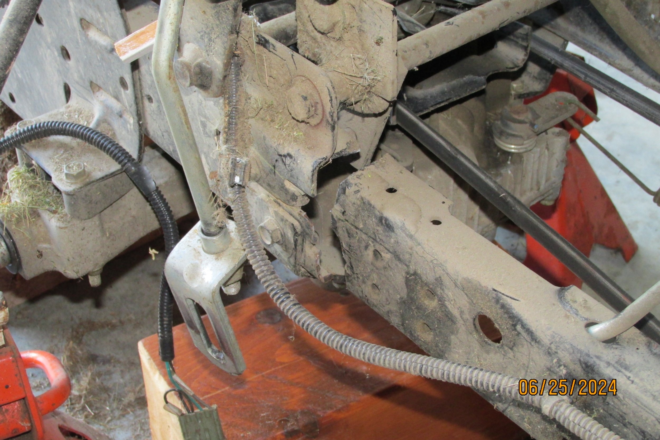

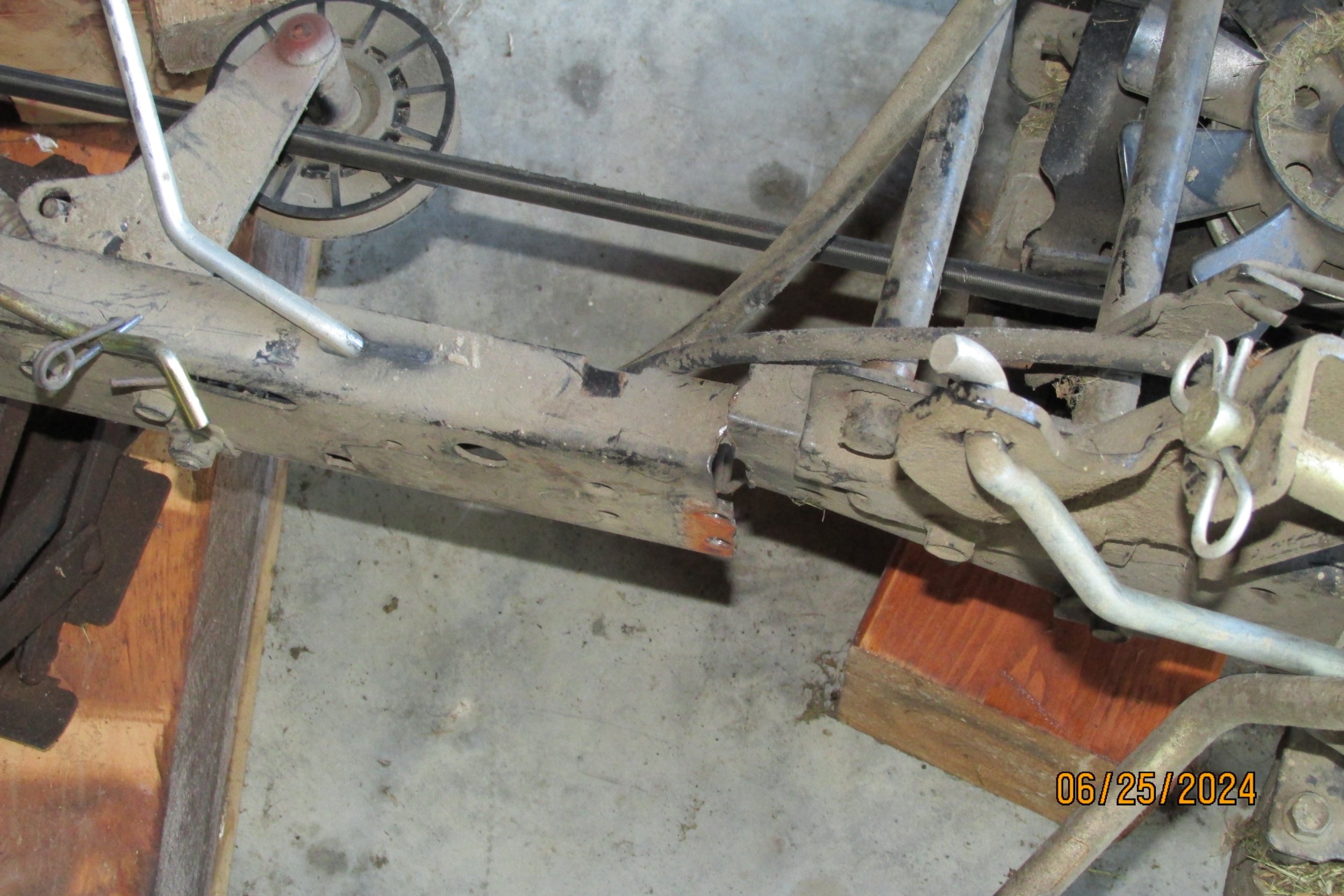

I have a Huskvarna LGT- 2654 which I bought at Lowes about 9 years ago which has 348 hours on it. About a month ago the frame on both sides broke and I have just finished welding and reinforcing the broken areas.
Starboard side
Port side
Turns our the frame on these tractors is stamped steel and I guess not too strong. Granted the ground is very uneven and hilly here but I never expected such a break to occur. According to my research almost every brand tractor is made by MTD so there are few choices. I also found out that the transmissions in these tractors are weak so don't try to tow anything.
After fixing the frame and reinforcing the break area I tested the mower out and after a while the tensioning spring for the mower deck belt broke. I am wondering what is next.
Sorry for the rant.
Guy
Unfortunately, that looks familiar. The frame broke on my 2009 Husqvarna 2354GXLS, which at the time was their high end model for this type of lawn tractor. If I recall correctly, the lesser models in their lineup had been MTD clones, but this model was made by AYP. At the time, Husqvarna provided a repair kit for the frame, but it had to be during the warranty period.
I had to weld the stamped deck back together, the sway bar bent easily, and the transmission bit the dust well before 500 hours (no steep hills, no heavy carts/trailers, 2 acres regular mowing, meticulous maintenance). It had a 23hp B&S Vanguard that blew a rod around 300 hours (bad luck, repair shop agreed). At the time, this tractor also was available as Craftsman's high end lawn tractor.
Even though I bought it at a Husqvarna dealer, it was a big box store model, and I have since vowed never to buy this level of tractor again. It was replaced with an eXmark ZTR that I can buy parts for very easily, mows better than anything we've ever had, is much faster, and very comfortable.
