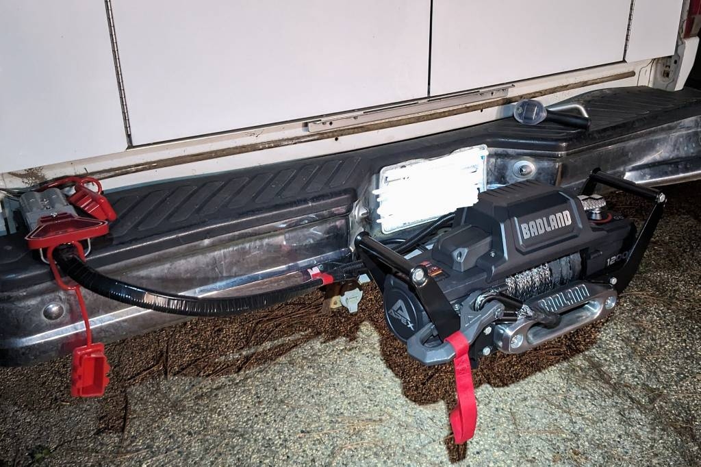

My last 3 sets have been 20ft 2 gauge, and I've bought them off ebay. The currently run $25 to $30. I've had no problems with them and I've used them to jump my 7.3 powerstroke when the batteries went bad. I've also used them to run a 13k winch (+200 amp continous draw) a few times with no problems. For reference, the truck will normally start off of 1 good 950cca battery so ling as its above freezing. In colder weather, it needs both of its batteries and the GPs pull 200 amps when they are cycling. Ive found that the weak point on jumper cables is the connectors. If they have the normal aligator jaws, you're doing good to get 200 amps because of the minimal contact area. If you need more than that, you need to wire in a plug.
If you really want 2/0 cables, they have 20 sets for around $140.

Ditto on the home made welding cable jumpers using Anderson connectors wired to the truck and tractors. Mine are a "modular" design with the clamps on a short piece of wire so I can connect more than one length of wire when I need longer length.
