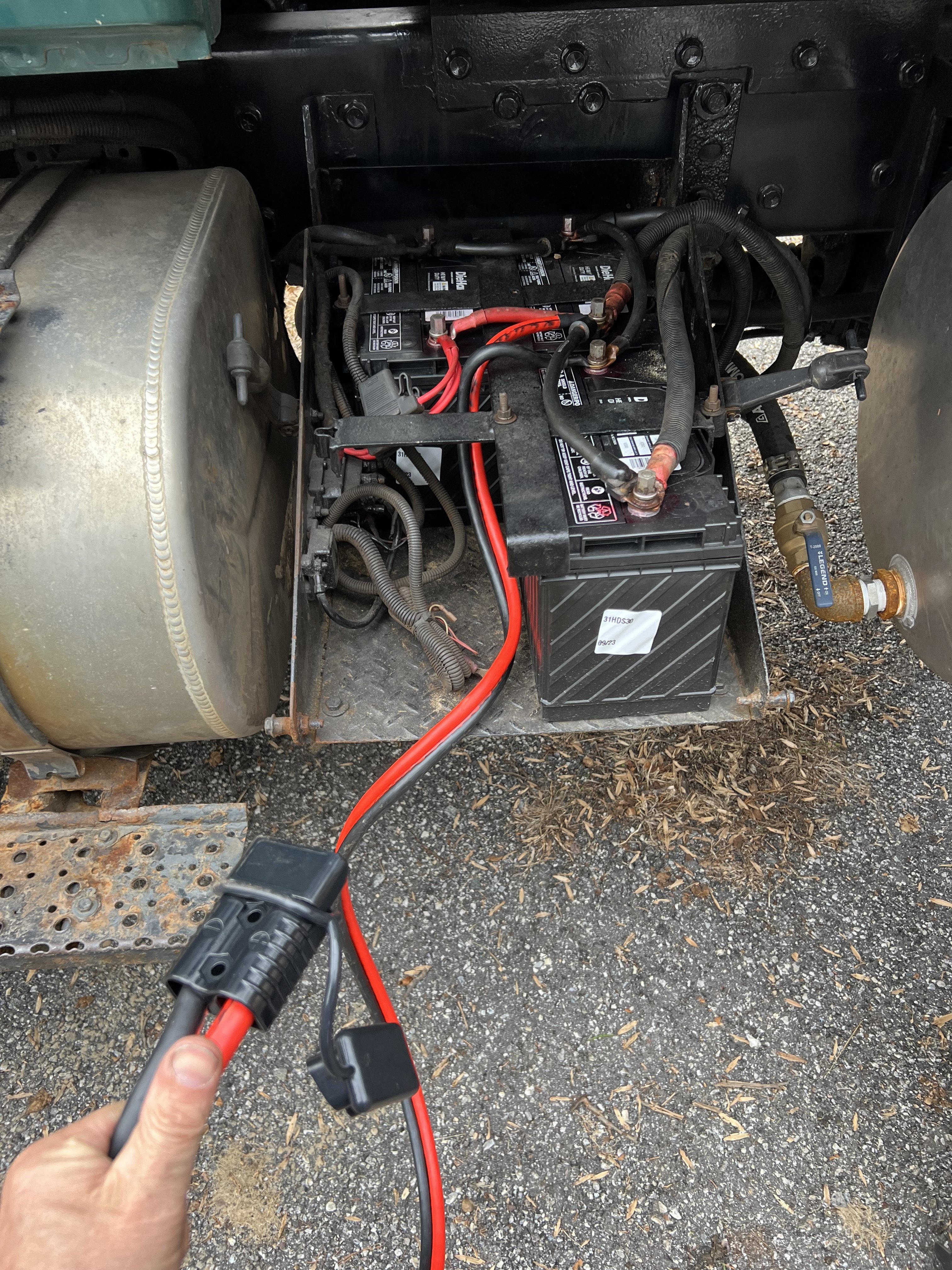

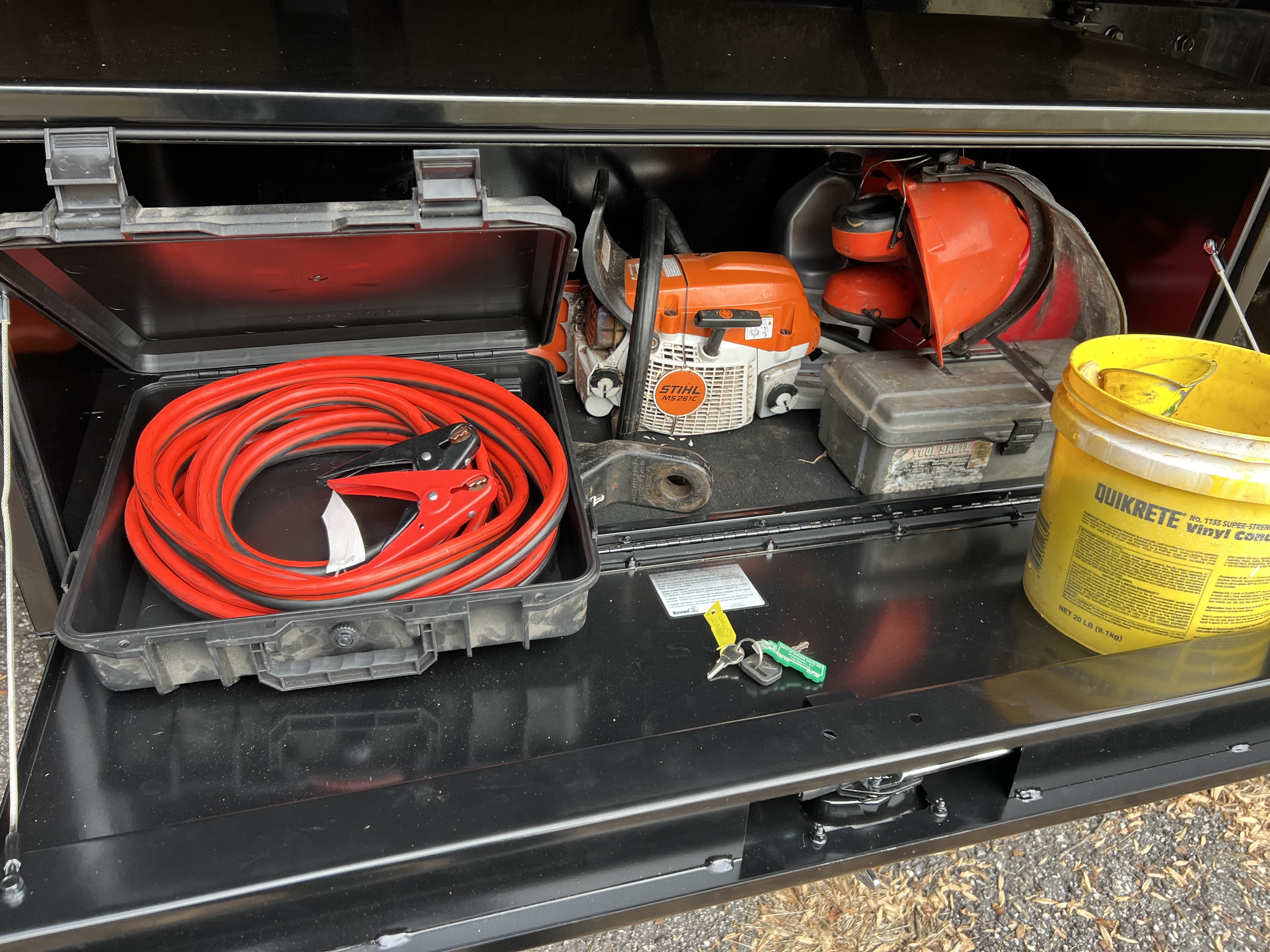

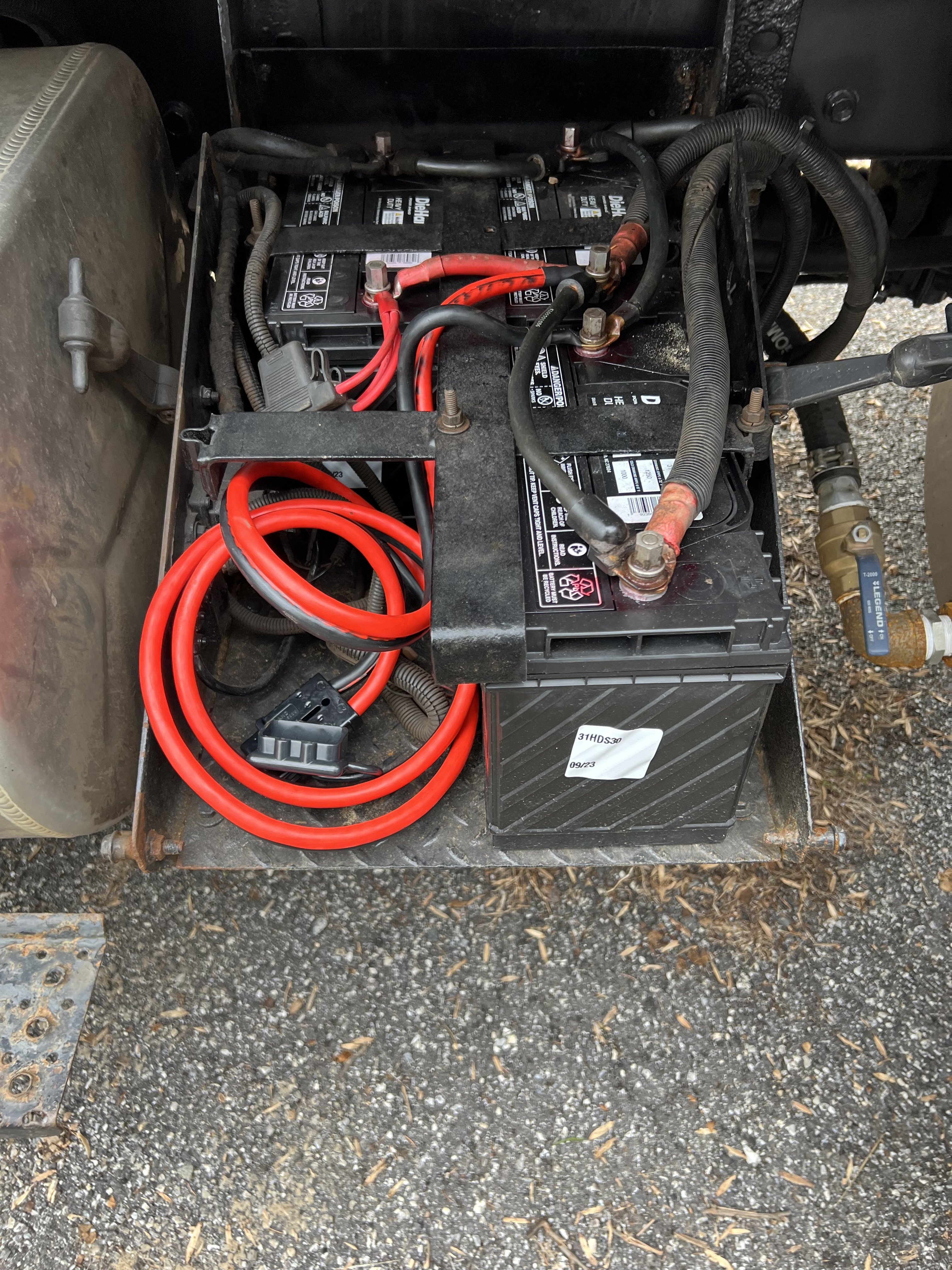

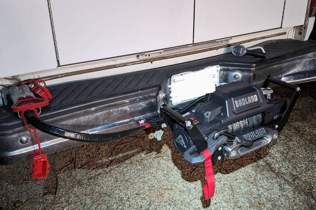

I run this type of jumper cables. One end hard wires to your battery, Anderson plug on the other end. Then a long set of jumper cables to dead battery.
Anderson Plug on truck side
Battery cables stored in side box.
Jumps tractors, vehicles, etc. great!
I have a similar setup on my older F350 - 2/0 all-copper to anderson connectors at the front and rear bumpers
can connect winch or jumpers to either end very quickly without looking at a battery.

I have a similar setup on my older F350 - 2/0 all-copper to anderson connectors at the front and rear bumpersView attachment 2100674
Very kool.

I made a set of jumper cables over 25 years ago using 1/0, fine strand welding cable. The reason for the wire size is that they are long enough so that vehicles can be rear bumper to rear bumper and I made them that long because I had experience with a situation where that was the only way, so that means they are around 30 feet in length. I picked up the wire for free, at the time I was working in a factory that made wire and cable.
I can't remember the last time I used them. I stopped using them after I purchased my first jump starter. But I would never part with those cables.
