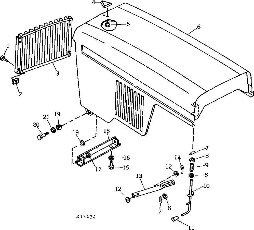

/ Which John Deere 850 do I have? #7
you can do a little recon thru the JDPARTS system,
(sign up, etc) and narrow down your model by looking
at some parts and seeing different listings for different
ser number breaks. the grill/hood are different above and below
007760 for starters...
other parts may lead to more clues... and eventually you
should be able to get a close approximation of what yours is
