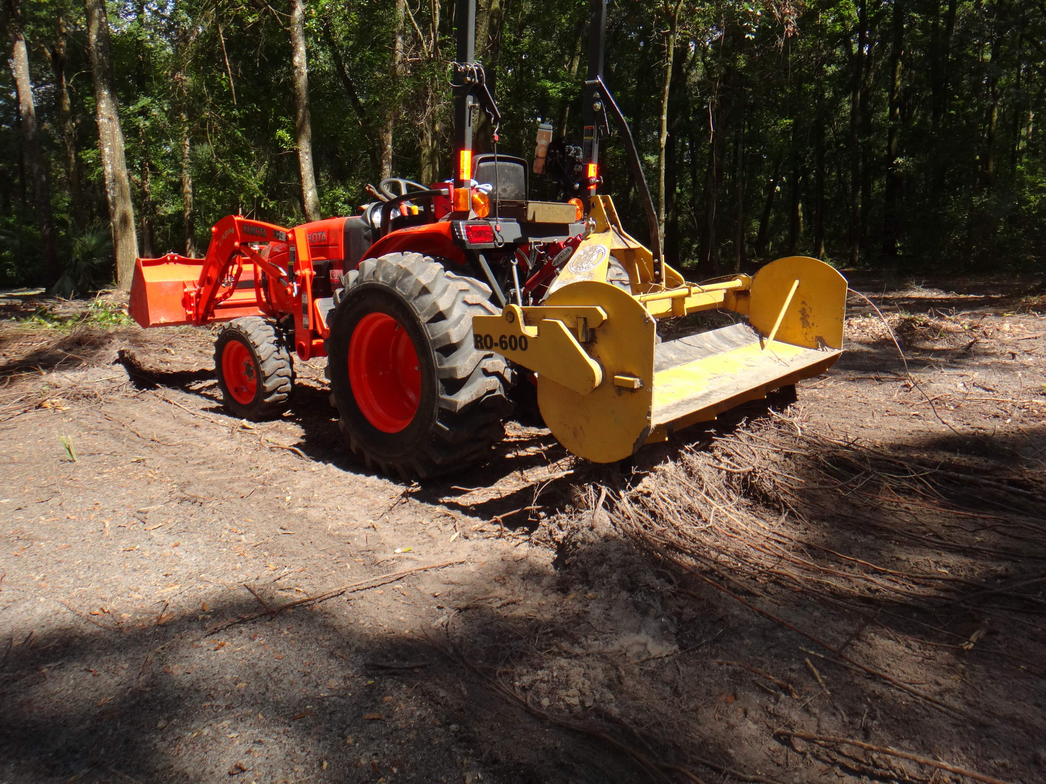

Note grape vine roots in both photos.

I would say you have a very big task ahead of you. I have cleared many isolated trees, but only a couple of acres of closer spaced - grubbing out an old olive grove, and in that case I worked close to each individual tree to identify those with a strong root system that would need to be dug out rather than pulled over. First, some negatives. A disc in front of a tine will not cut through most of the roots you show in the photos. A spring loaded shank will not lift the length of roots you show. The tine will often go underneath, and break the root or stop the tractor. In this case I suspect you will bring very little to the surface. Alternately the root will be stronger (often due to length increasing the force needed to move it) and the springs will be stretched to their limit before the shank slams back into position. Do this often and you will break springs. I have a 7 tine implement similar to the Fred Cain one, and which I refer to as a scarifier. In Australia I also had a root rake attached to a front blade. This worked well where heavy timber had been pulled and the roots left in the ground, but it only worked about 4" below the surface.
I have had success in lifting roots also by using a single leg fixed subsoiler. I think the mouldboard plough (without a disc or tine in front of the plough) would do the job, but you would probably need to go shallow on the first pass and you will obviously have an enormous quantity of rubbish to rake and burn - but you will have that whatever method you use.
Best of luck with it all, and you will have immense satisfaction when it is completed.
