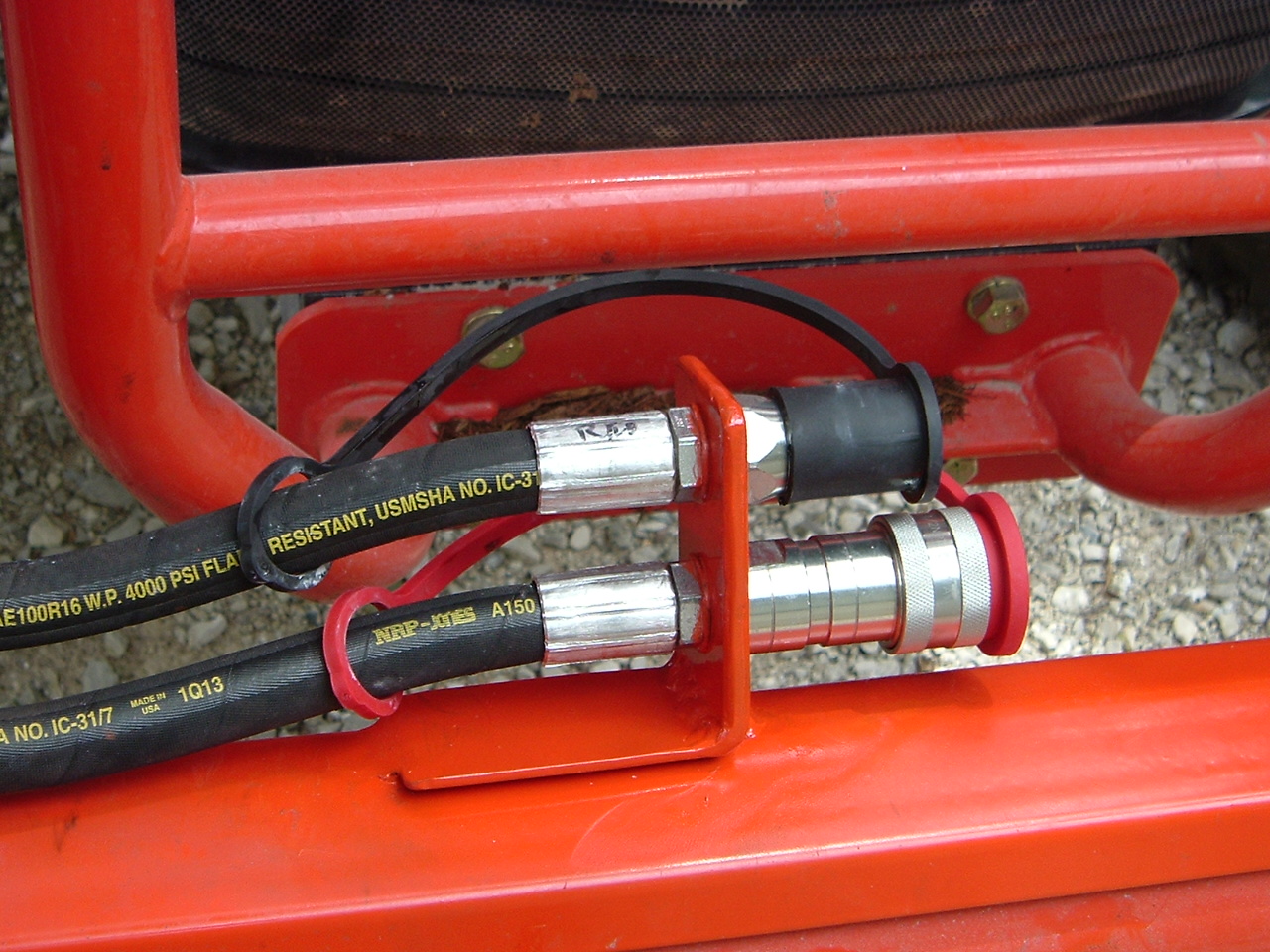

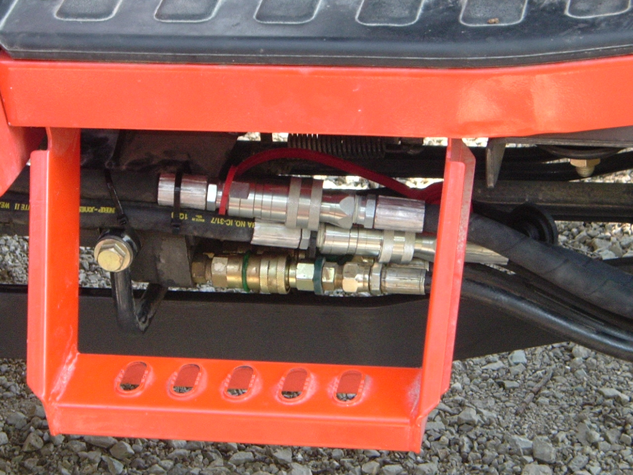

If you look at the Surplus Supply catalogue you may find bulkhead mounts. However, if you can bend a piece of 1/8 or 3/16 steel into a 90 degree angle and then drill two holes in one side to fit the end of the hydraulic hoses before attaching quick connectors on the other side to secure the hoses in place, you can do it with scrap metal. Just weld or even use long hose clamps to attach the "mount" to the torque tube.
I cannot find the mounts on surplus center. I did find this which is a bit unusual but would still serve the purpose. Just clamp the hoses and secure the mount to the torque tube: 1 IN TWO WIRE DUAL HYDRAULIC HOSE CLAMP
/ Which grapple #50

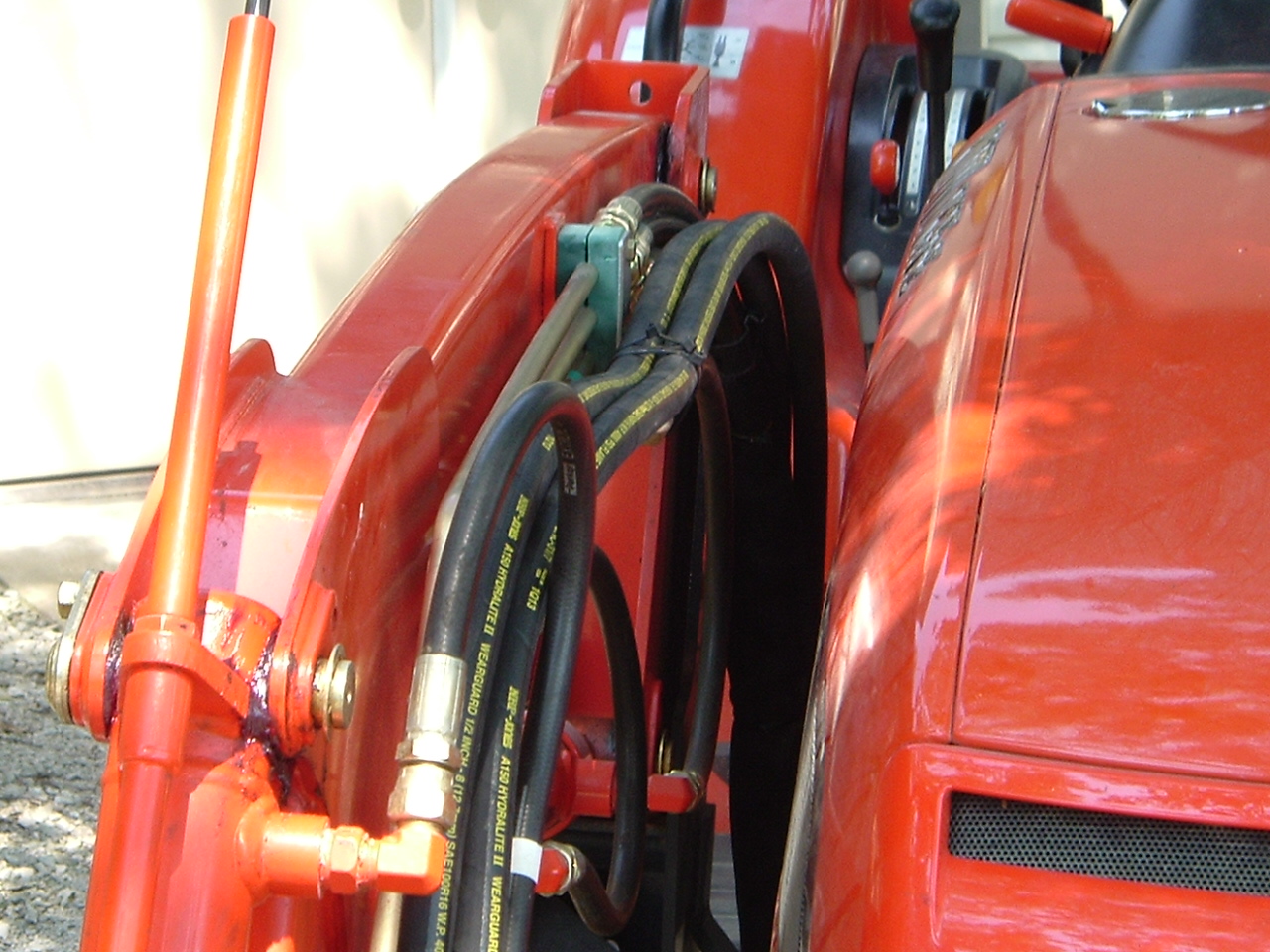

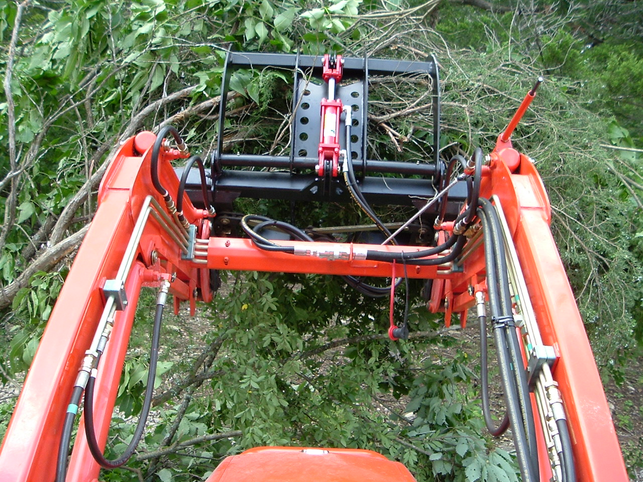

4shorts used those to route his hoses on his backhoe hydraulic thumb mod. Apparently worked quite well.
I sure did and I'm very happy with them. I painted them to get rid of that awful green though. In my video I show how I attached them as well ;)
They were also used in my grapple mod on my 5740. A great way to secure your hoses

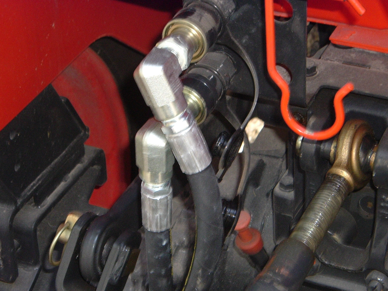

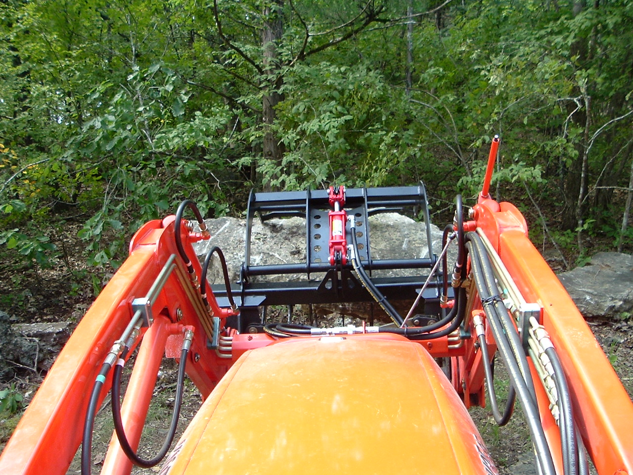

Good morning, Latest tally on the grapple from EA: Cost and shipping $1650 Cdn, Customs and taxes $156, 16' hydraulic lines $130, so all in it was $1936 and I still need a bulk fitting. Grapple works well but requires time to become proficient with it. Island the duct tape is history! Can I leave the penalty box?
/ Which grapple #56
OK, you are promoted to ziptie level. :thumbsup: Next step up the ladder is bulkhead mount. Bonus points for fabricating your own! A few folks go overboard and install copper lines....but they are the type that polish their tractors so while we note such "improvements", we don't award prizes for such silliness.
