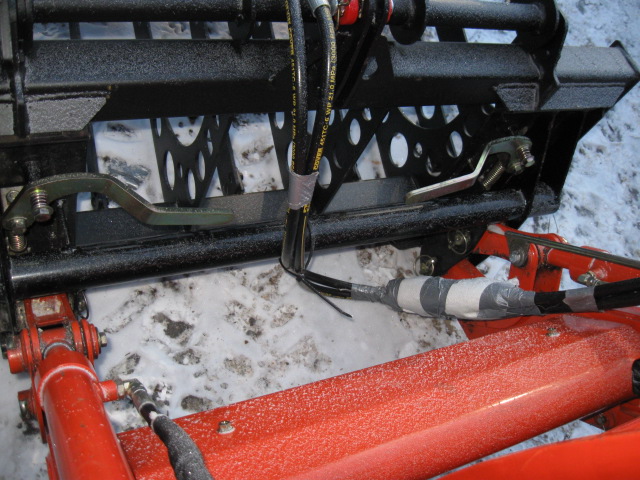

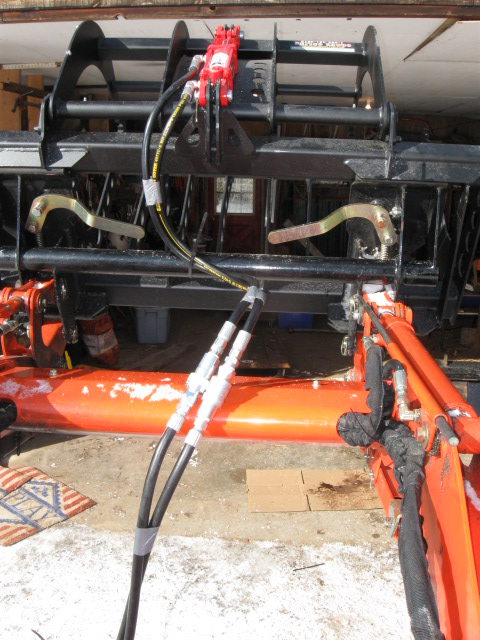

James, Thanks for the input. How long is your line from grapple to 1st connectors? Mine is EA standard 46" and I could not tie down those connectors as it would limit the upward extension of the unit. It just seems there is too much movement of the front lines. I went under from the front, not on the arms as you did. I wonder if that makes a difference? I cut a yellow birch 20" on the stump today, dropped it on the trail and didn't have to pick up 1 branch to clean up. Good seat time!

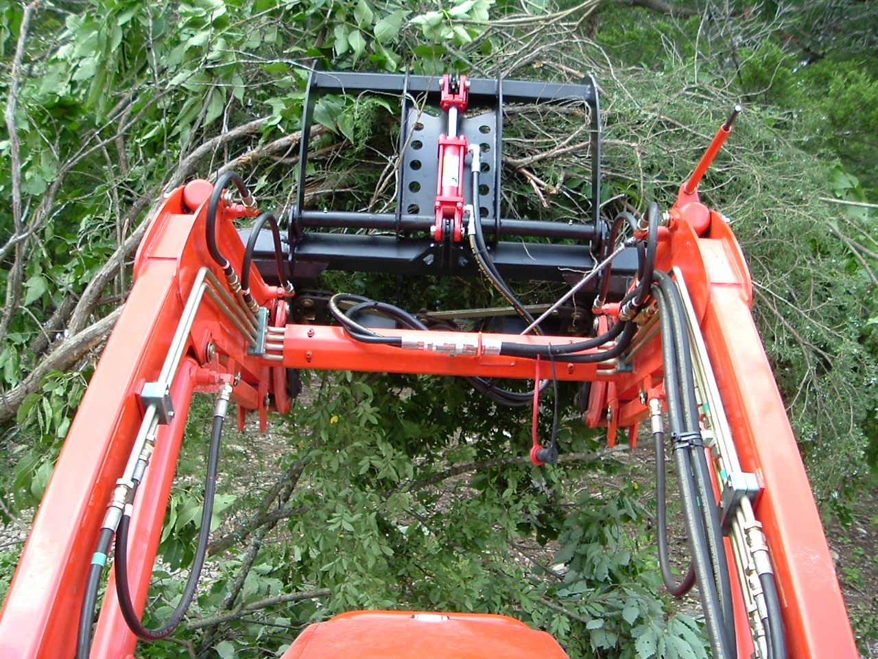

I had them make mine 1 foot longer. As sent they were too short, and I sent back the hoses, and they made up longer ones at no charge.

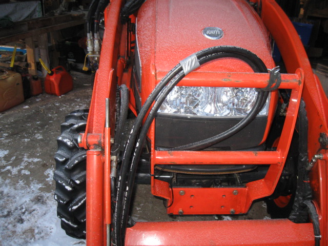

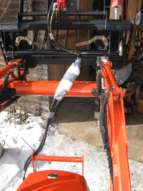

Here is the latest, another happy day in the great white north, -26 that's -12 to you southern lads. I love winter! I wrapped the connectors in front so they wouldn't scratch the paint.

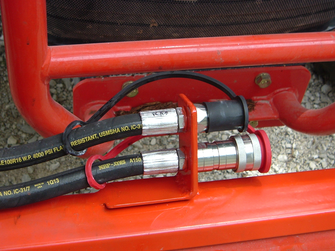

need to make a bulk fitting mount to the crossbar guard mount

View attachment 362967View attachment 362968View attachment 362969View attachment 362970
Hey, what's with the duct tape. We don't allow duct tape on orange tractors. Into the penalty box. 2 minutes.
Now, bungee cords are approved by the league. Zip ties are approved. Welded or bolted bulkhead mount fittings are great if you wanna get fancy. But, we don't wanna see no stinking duct tape!
/ Which grapple #36
Yeah, put an L angle between the two bolts that hold the shield onto the crossbar between the loader arms. Punch two holes in it side by side. Attach the hoses to the angle and you're done. Run your slack along your loader arm and attach with zip ties of adequate size. The way you have it rigged now will be nothing but problems.:confused3:

Good Morning, I appreciate your concerns Gentleman and thank you for your input. The grapple lines are a work in progress and I must say I agree with the appearance of duct tape on an orange tractor. I tried zip ties but they broke, now the L angle will be considered. I probably got the lines too long (16') and I'am not too tore about the look of that big loop on the front. Stay tuned. For now I have to put the loader back on and do some light plowing for the elder neighbors. As far as the 2 minute penalty Island...wheres your stripped shirt and whistle?

Back to business: on my first tractor with grapple I had a similar grapple remote arrangement (minus tape). You can take up excess hose more neatly by creating a loop or zigzag at the back near the rear remotes and secure with zip ties. In front the excess is a bit of a hazard as it can snag on brush etc. You do need some extra up front but to keep it under control I put a tight zip tie to hold the two lines together then slipped a bungee cord into that zipped bundle and attached the other end to the torque tube with zip ties too. Adjust tension so it can easily stretch when the grapple is fully dumped but still takes up most slack when fully curled. I never did use more than zip ties which were not exactly beautiful (but better than duct tape!) and worked fine. They would also break when stressed rather than tear hoses so are kind of a safety feature.
