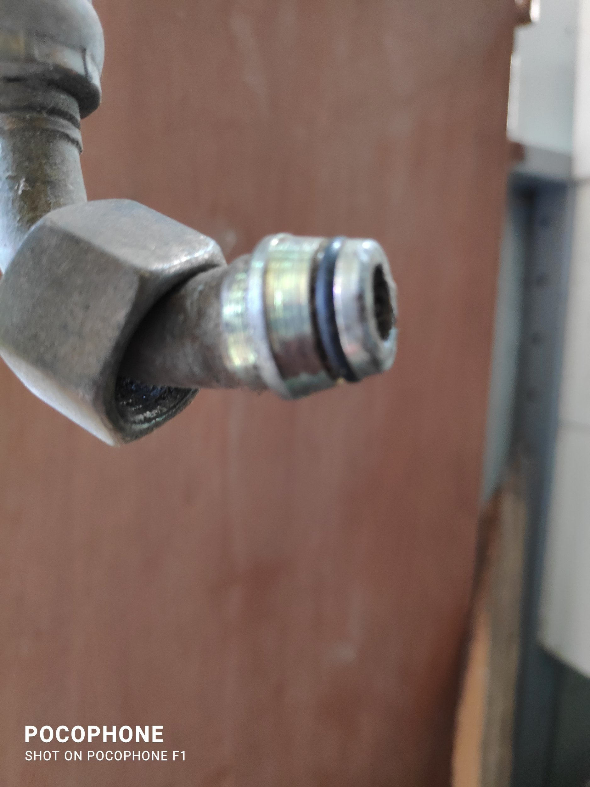

Apr 2, 2022 / Which connector is this? #1 A avz Member Joined Apr 24, 2009 Messages 25 Could you please help me by telling me which type of connector is this? unfortunately, I didn't found it in the catalogs. Thanx. Attachments IMG_20220402_111232.jpg 1.4 MB · Views: 129
Apr 2, 2022 / Which connector is this? #2 ptsg Super Member Joined Apr 3, 2013 Messages 7,807 Location Portugal Tractor Branson F36Rn - Agria 8900D It's a metric fitting with a 1.5 mm thread pitch. DIN2353 fitting to be exact. Easiest way to figure the size, is to measure the outside diameter of the male threads and the diameter of the tube on the 90 degree bend. Last edited: Apr 2, 2022
Apr 2, 2022 / Which connector is this? #3 WranglerX Super Member Joined Apr 6, 2018 Messages 5,623 Location A Little Bit West Of Yosemite NP Tractor MF GC1715 Believe fitting is described in this document... Believe its "Metric Cone"... Attachments thread_guide.pdf 303.5 KB · Views: 180
