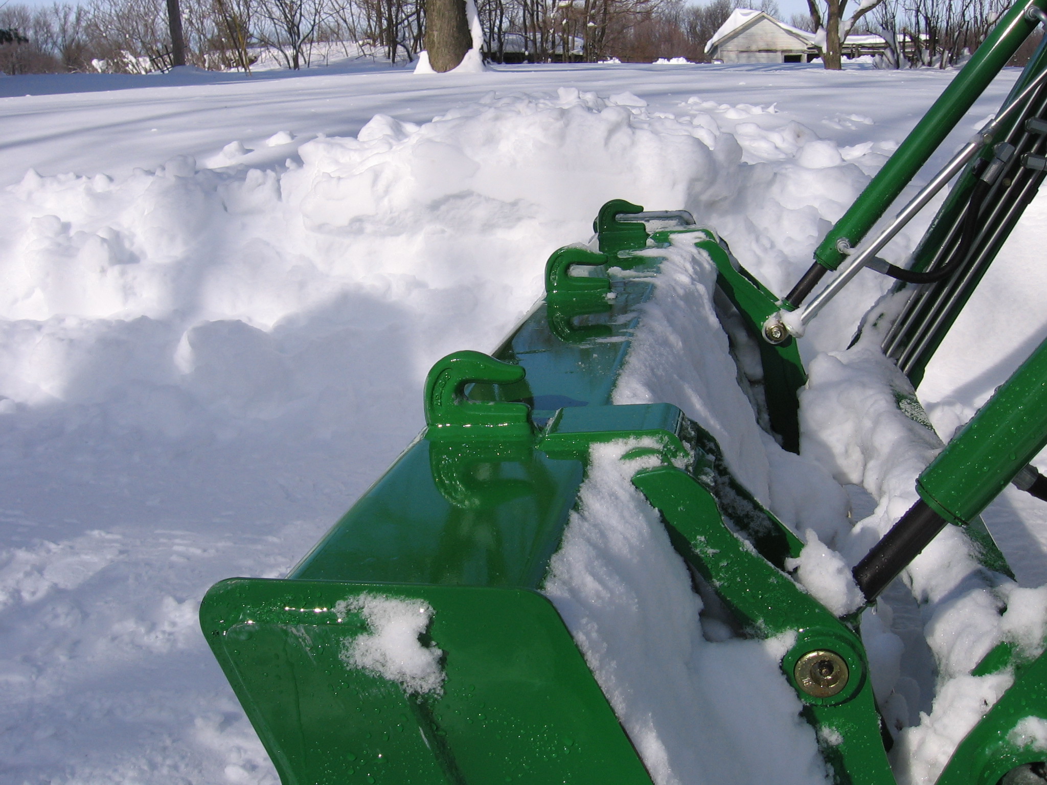

/ which bucket ... #28
Wonder why my 61" is considered heavy duty.:confused2:
Greg
Greg,
You can check, HD buckets have reinforced sides and bottom. The top portion is completely enclosed also. On the material buckets the top lip is just an 11 ga. plate and is not boxed in. with no reinforcement of the sides.
Rob
/ which bucket ... #29
Rob,
That is the way my bucket is made.
I couldn't find a decent photo,but this one kind of shows the sides. The top is completely boxed in also.
Brrrrrr,what a picture to post. Almost forgot about this kind of weather.:)
Greg

/ which bucket ... #30
Rob,
Greg
You have a HD bucket. Must be the 61" bucket is different than the 49 and the 53. I hadthe 53 andi saw the 49 too, both are materials buckets without reinforcements. That's the one you want, for the little you lose from the extra weight it's still worth it in my view.
