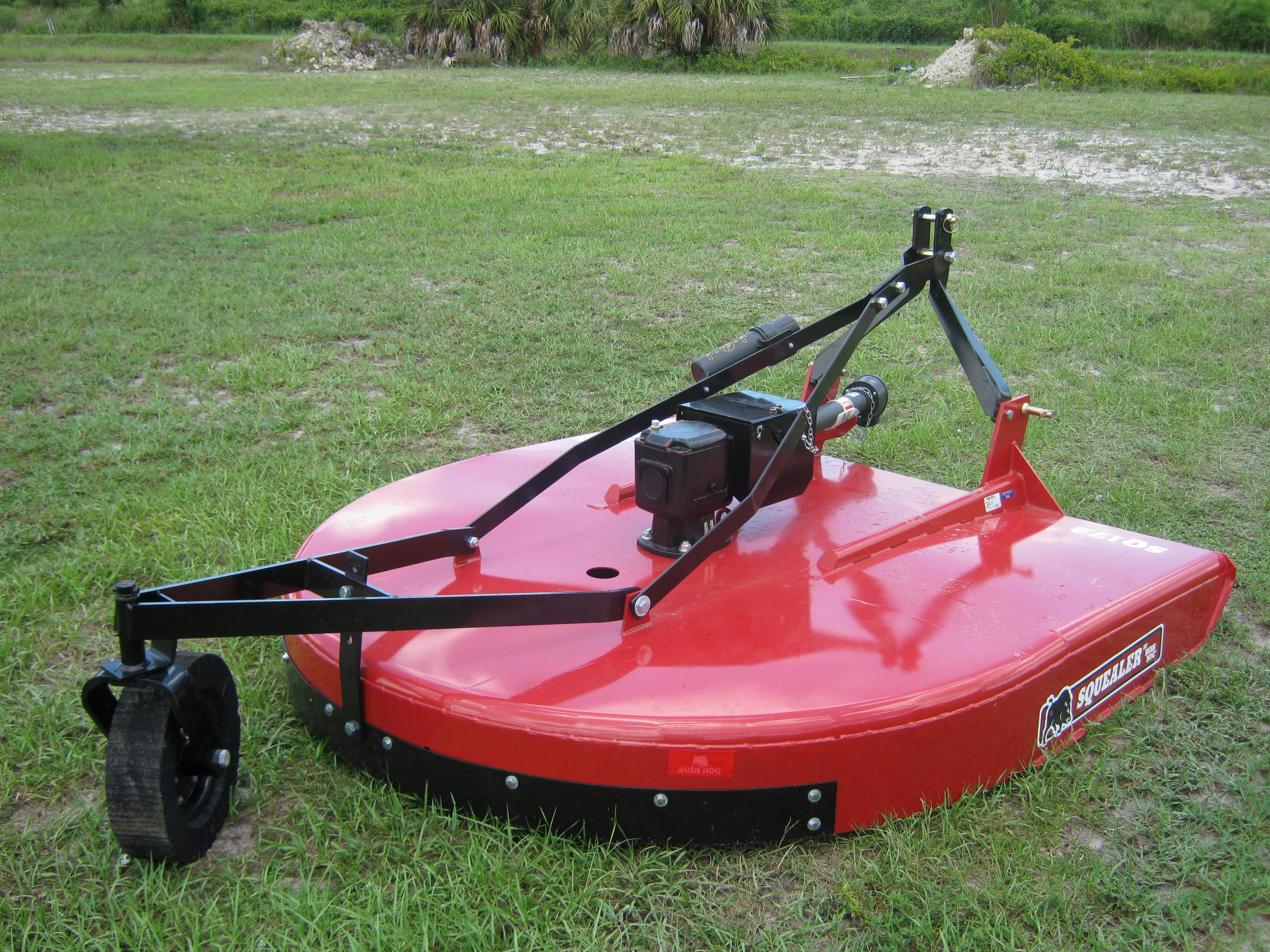

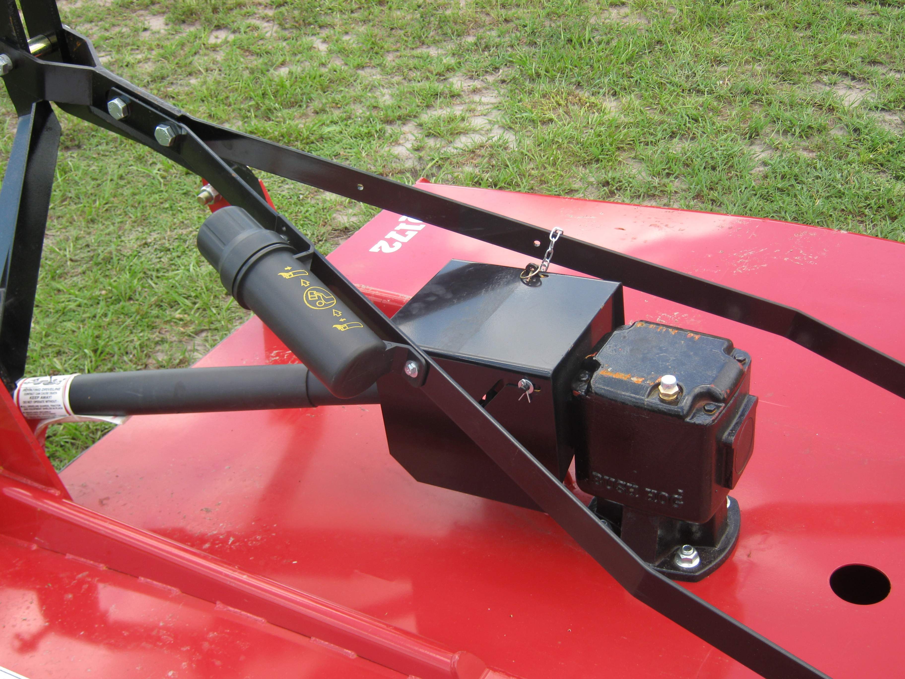

/ Which brush hog should I buy #14
I like my 6' King Kutter. My 31hp Belarus runs it fine.
If you can spend a little more consider a flail mower:
FLAIL MOWER 73 WIDTH W/ PTO SHAFT - Agri Supply
There are several threads here discussing this brand of flail.
A rotary mower has a lot of momentum when cornering due to it's length. The rotary momentum of the massive blades doesn't like bumps. The front corners can dig in on uneven ground. A flail mower will simply handle better.
