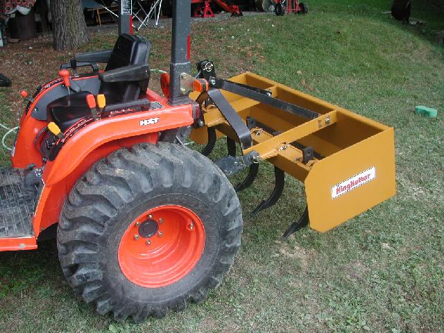

Happened to stumble upon a pic of my KK 60" box blade that I paid $299 for...hanging on the back of my B2910 Kubota.
Thought it might be of interest...Don't remember anyone posting a pic of the KK in this thread....
