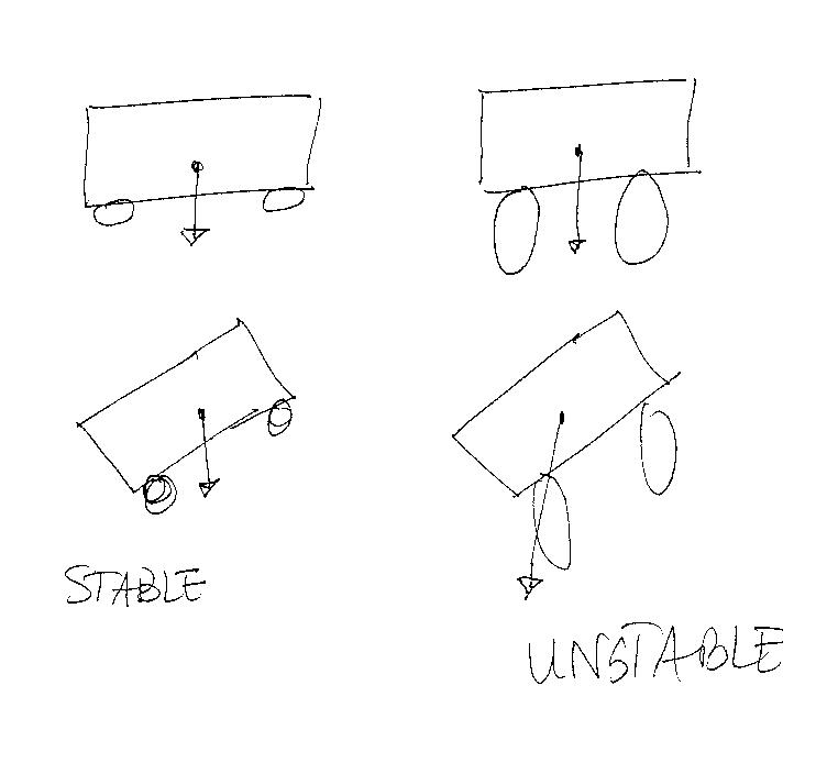

The center of gravity (COG) of any object is fixed, and it is very important in determining the stability of the object. That stability however depends a lot on the path of the force that the earth's gravity exerts on the object crudely defined as acting on the COG. In a tractor the COG is somewhere inside the tractor itself, probably in the midpoint from the front to the back, at the level just above the transmission. If a tractor is level and stationary, the force will pass between the width of the tires and the tractor will be fine. As the tractor tilts, the line of the force changes to the point whereby it may pass outside the width of the tire and the tractor will overturn. The lower the COG, the greater the tilt that can be achieved before the tractor tilts.
The weight of the tractor plays no role in this stability, but the height, and the distribution of the components in the tractor do.
I have attached a rough sketch of what I am trying to describe.

This is the sketch.

I goofed, Not unusall. The center of gravity of an object remains constant. The metacentric height varies and this is the one that is important.
