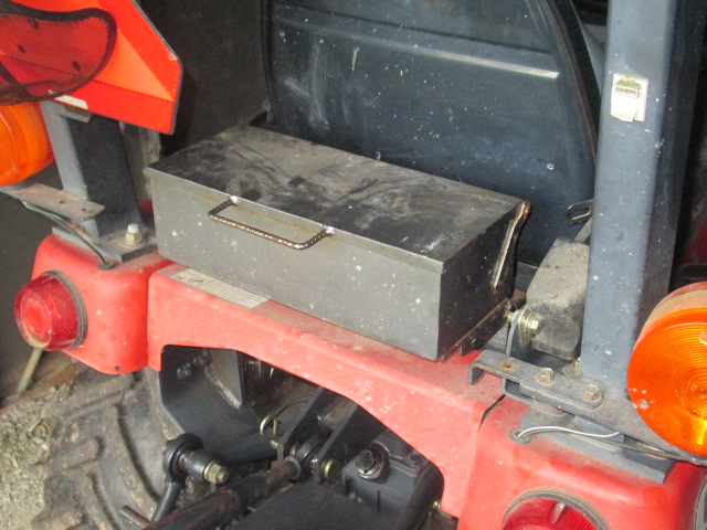

Check for any unused bolt holes behind the seat.The GC2300 had 2. Brackets were made with angle iron to extend out from under the seat. The toolbox then bolted to the brackets. I used a steel box, but a plastic box would do just as well.

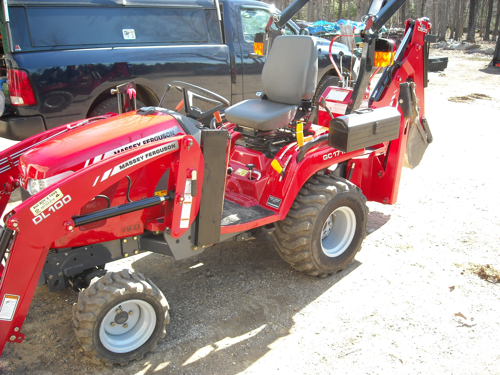

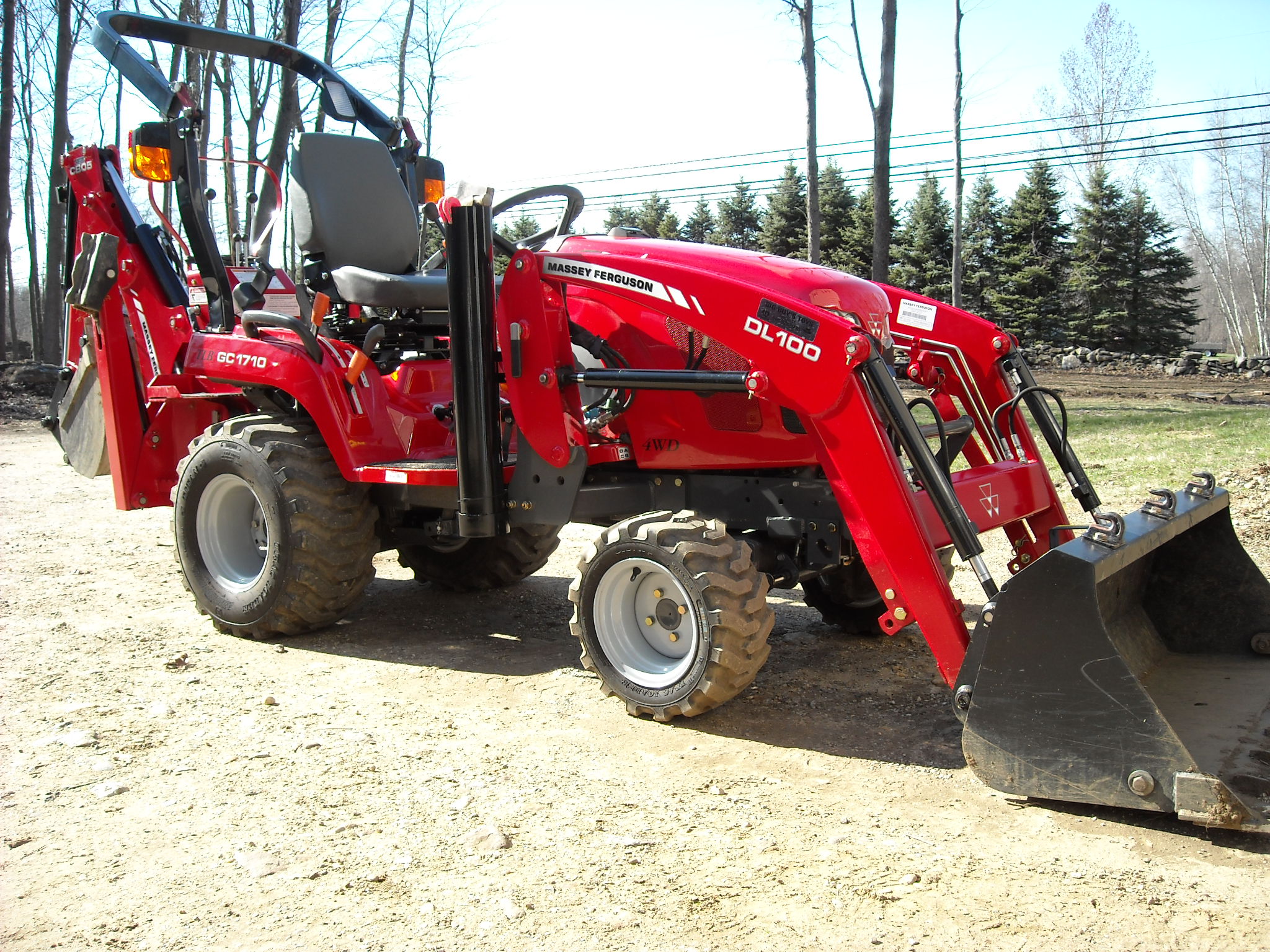

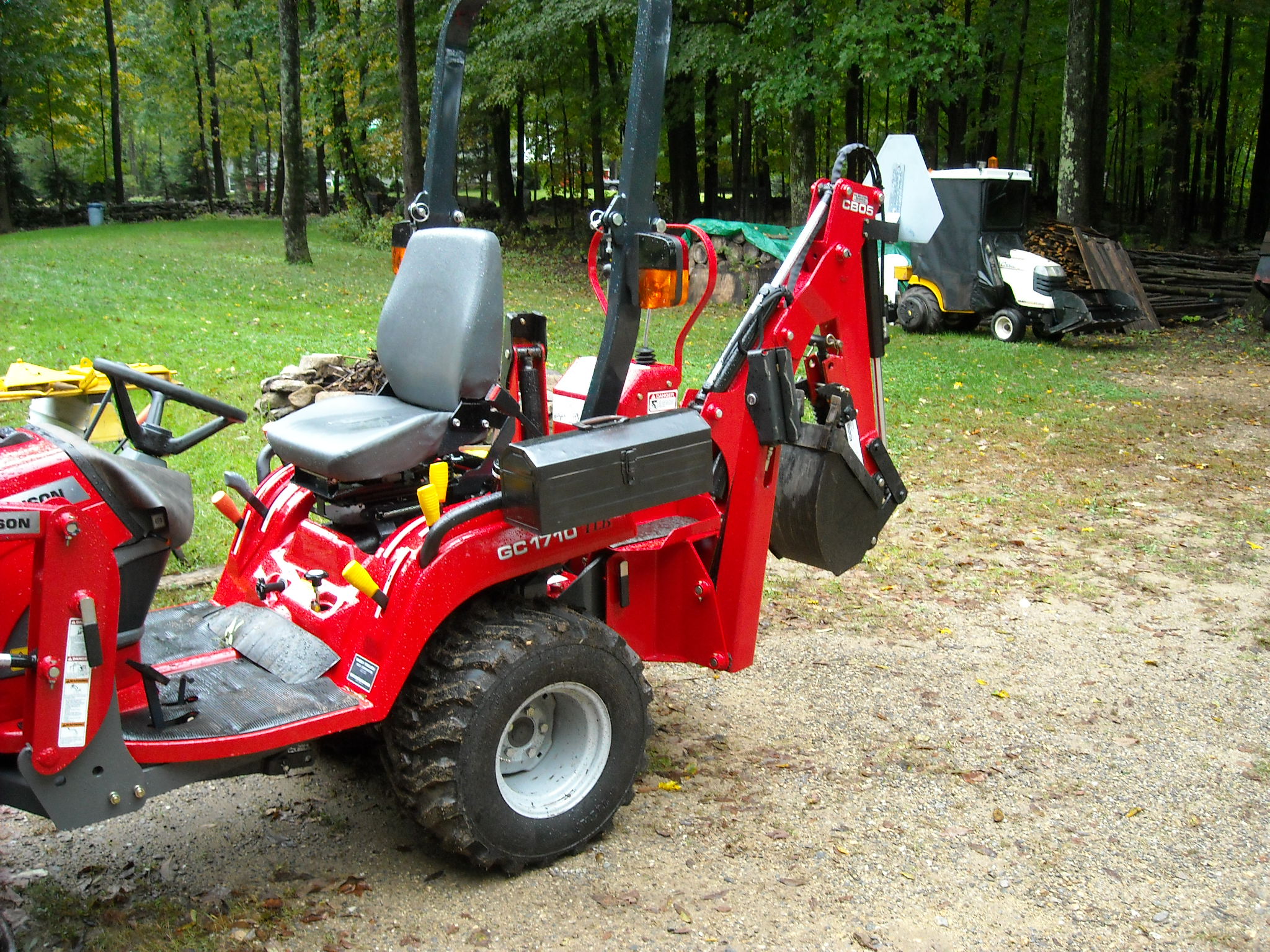

/ Where would you put a tool box? (1705) #20
I used the bracket for the SMV sign.
The box has been on there a couple years now and no problems.
The bracket on the tool box is a scrap L bend from some garage door parts...and I put a piece of angle iron inside the tool box.
I also added a pvc tube for my chains and a plywood scabbard for my chainsaw.
