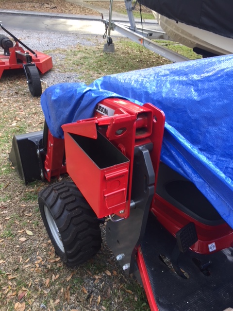

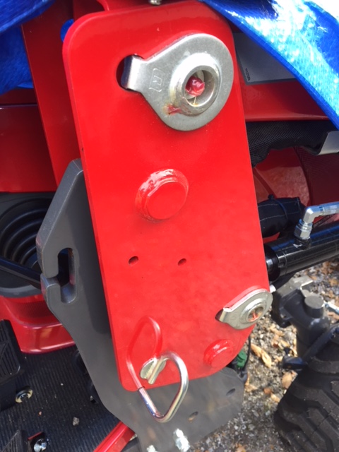

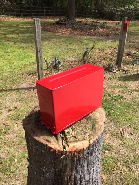

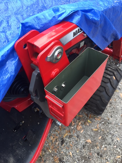

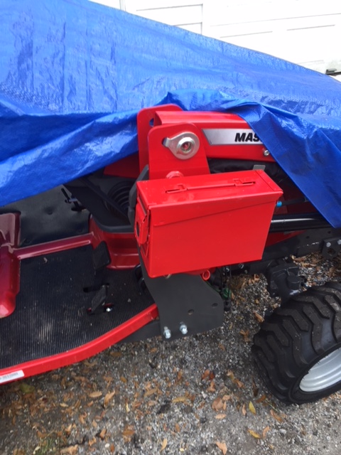

I saw something similar to this in another thread I can't find...so not my original idea.....
But I'm going to add an ammo can as a tool box to each FEL support. Staring with a .30 cal can but may end up with a .50 cal can.
Used a 3/4" thick piece of black starboard (UV proof marine plastic) to make the spacers and stainless bolts. Just need to drill the holes in the
ammo cans and bolt them on. TSC for the MF Red paint. With one on each side should be enough room for enough tools and
should be waterproof. Should be relatively waterproof too. Still thinking about where to store some chains......something attached to the front brush guard looks possible.

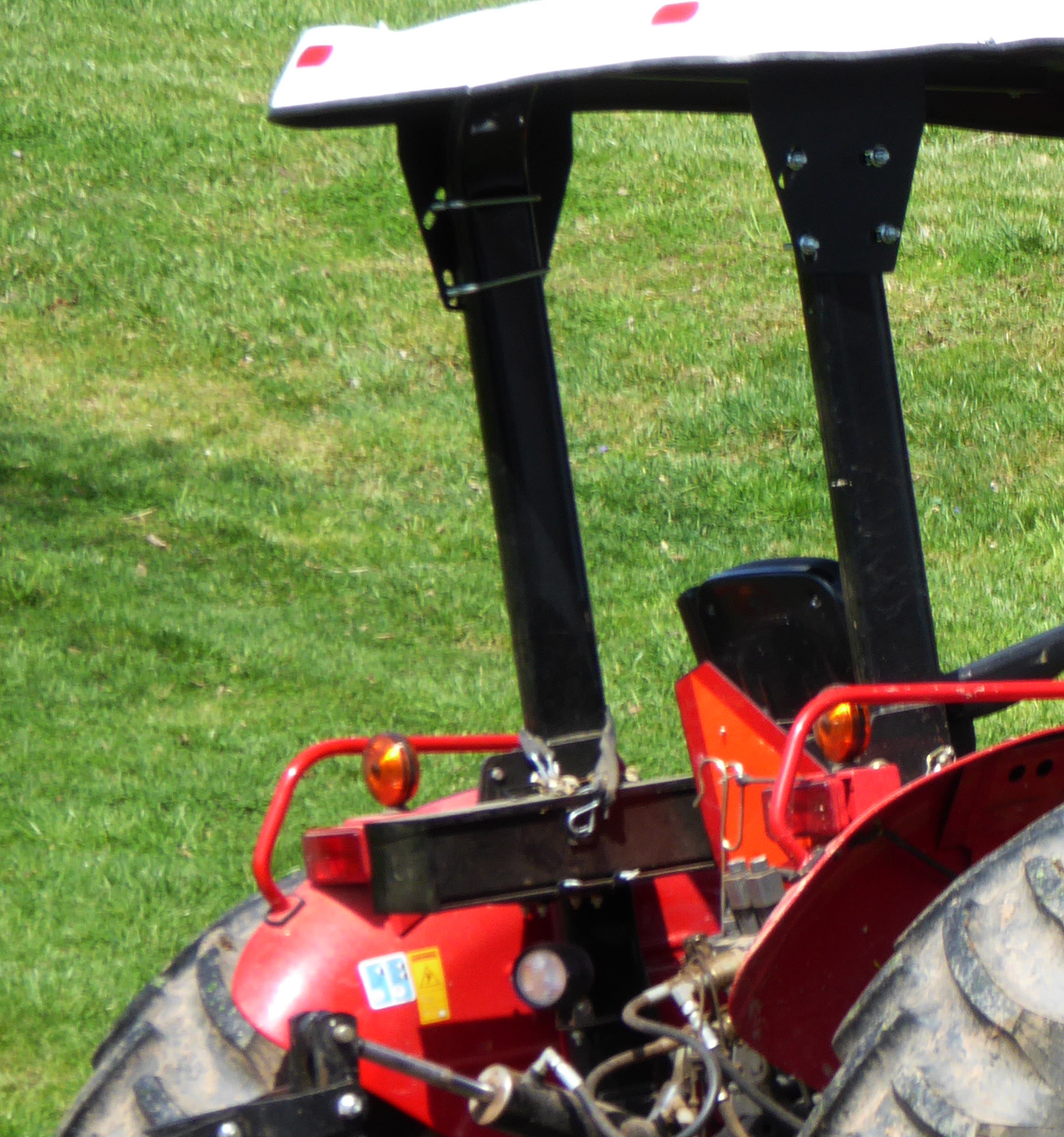

That's a pretty darn good idea DMW. There are several precautions: 1) No matter where you mount it I guarantee it will be in the way for something else you wanted to do later. 2) Vibration is much more of an enemy of tractor mounted tool boxes than most realize ahead of time. What seems solid turns out to be flimsy and floppy.
I find a small plastic tool box fastened down by bolts thru the floor boards or bungy cords or whatever is useful. I keep a chain in that. Then a steel box bolted to the ROPS had better space and served well.
I used the broader plate on my ROPS for a backing for the mounting of the tool box on this MF2660. Not ideal but it does hold the essentials, the Crescent wrench,the vise grips, the screw drivers, the spare bolts and clips, the old rag, you know. The heavy rubber straps were added to provide tension on it and minimize the flopping and vibration. I think on many tractors the floorboard is best if you can spare space. All mfrs need to include a toolbox as std equipment. A big one too, not the 1/2 pint size.
