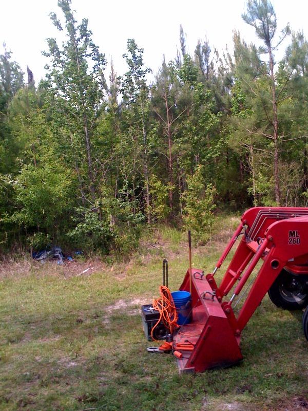

the outboard hooks are fine to the maximum capacity of the loader, they are in a very rigid area, and wrapping them around the bend makes the bucket more rigid and stronger at the lifting point.
the shackle in the middle is there specifically to be the 'fusible link'... i put it there to fail first, before bending the bucket. in as much as the downward and twisting force of the trailer hitch was absorbed by the shackle, an overloading in a lifting capacity would do the same. since this picture was taken, a few good smacks with a 6lbs hammer has repaired the damage to the shackle without causing any damage to the bucket.
the plan obviously works.
if you overload the bucket across a larger section, you simply spread the damage over a greater area... effectively causing more damage. :2cents
After bending the shackle back the strength is greatly reduced and every time after that it will get worse. If that "link" is a must, weld it on a piece of flat stock and just change that if you must so you wouldn't be grinding and welding multiple times on one spot. Why not put a long piece of beefy flat stock welded or bolted on with a regular hook that don't bend? Just wondering. I wouldn't want a heavy load tied down and run the risk of any weak link breaking and having the load fall on someone or getting away on me. I would want it strong enough to where the bucket would fall off before the hook would break. But that's just me. I really like all these various ideas on this link so so I can have multiple choices.

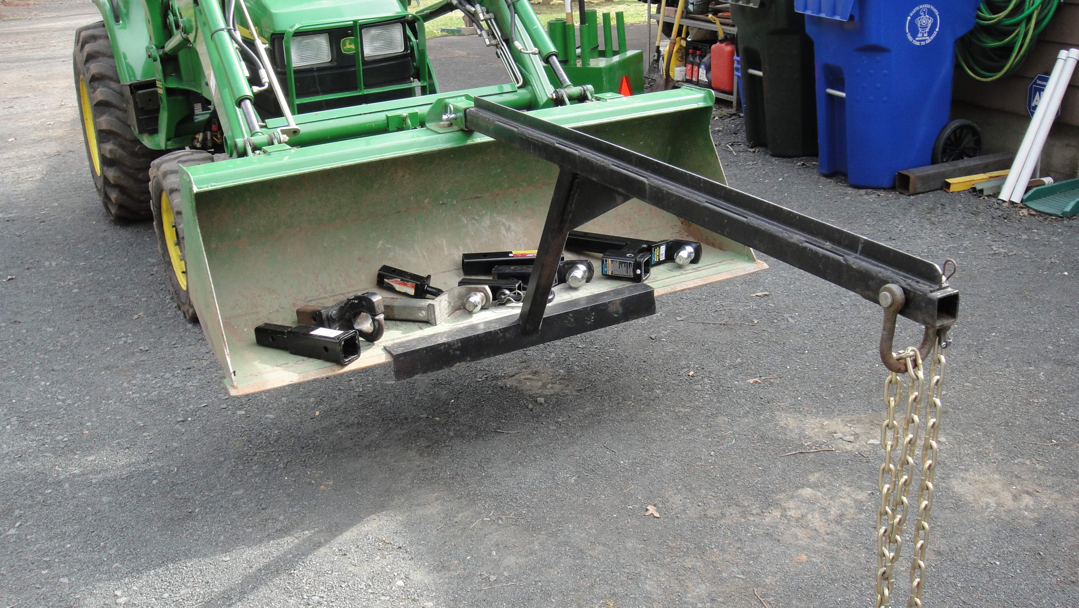

I know I lose alot of my loaders lift capacity with this setup, but definitely no need for a hood guard :D
Another use of receiver tube on top center of bucket, i have yet to need or want weld on hooks.
JB.

Nice boonm pole. My only concern would be how easy it would be to overload the front tires. The further out the load is in front of the bucket, the more it loads the front tires.
This may not be an issue on your tractor. Oowever, on my tractor the front tires are a 6-12 size. The 4 ply tire rating is 600 lbs. Even 6 ply is only 780 lbs. & these are tough to find. With an empty bucket, there already is 500 lbs. on each tire. Hanging even 400 lbs. a couple of feet in front of the bucket would bring the rim down to the rubber!
I never thought about the tires, but I think the loaders limit is the same.
My loader can lift aprx 1500 pounds, that's probably about in the middle of the bucket. with the boom pole the the capacity would go down drastically out at the end of the boom. But the loader still feels 1500 pounds.
I have worried a little about the front tires when I have capacity loads in the bucket, but these must be pretty good HD tires, cause they seem to handle it with out any noticeable problem. I've only checked the air pressure a couple times since I owned the tractor. Thanks for bringing this up, I should check them now.

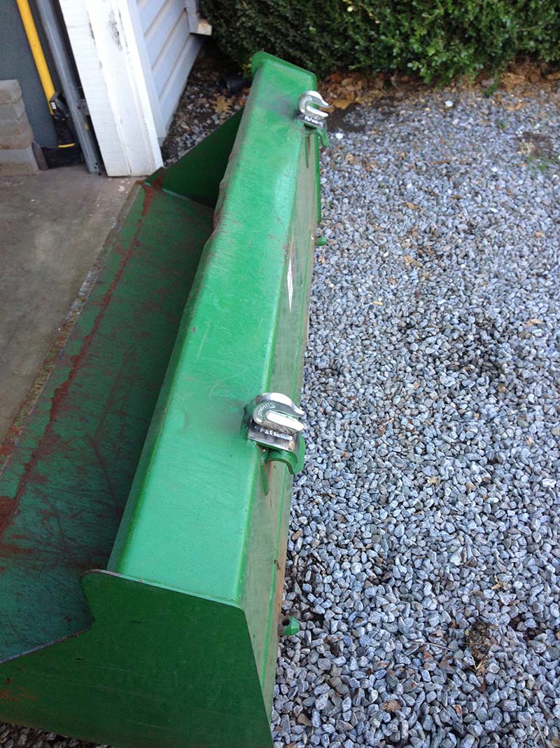

I did not put these shackles on my bucket I bought the tractor used.
But these are the handiest things to have , I can not tell you how many times I have used them in the past year. I know this much if I ever get another tractor with a FEL the first thing I will do is get some welded on my bucket

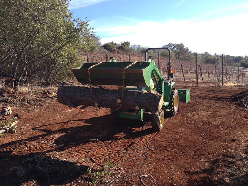

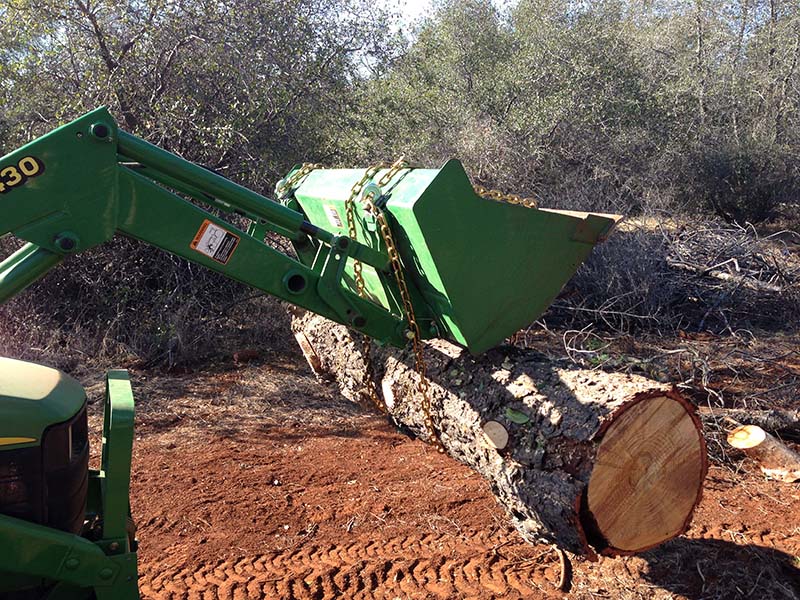

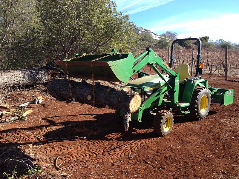

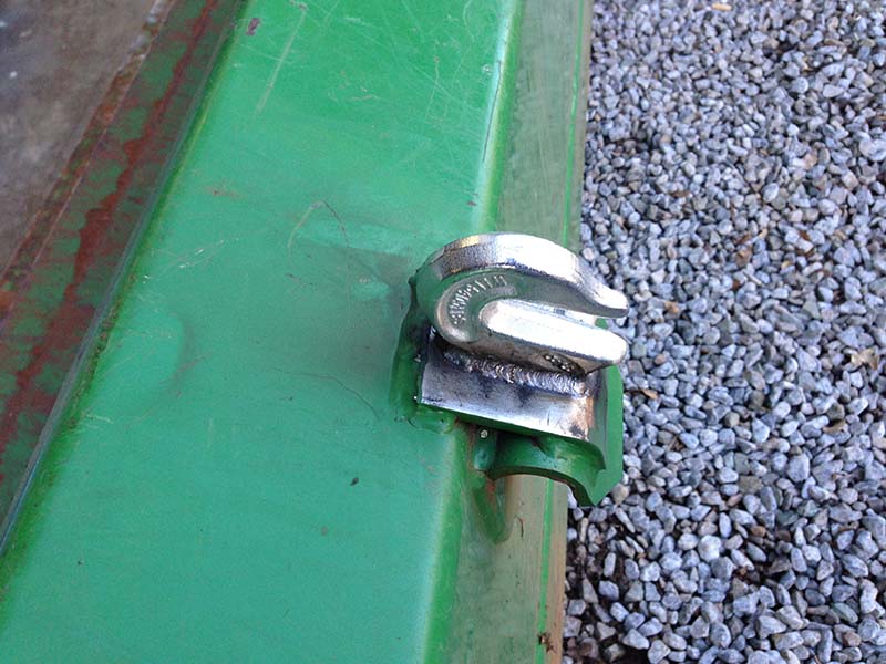

Thanks to this forum topic it has helped me successfully add a few hooks to the JD. I plan to add a 2" trailer set-up on the center of the bucket very soon.
I had two 40+ foot pine trees fall last winter and needed a way to move the 6-8 cut sections.
See the results in the posted pics. I painted them JD green.

Nice. I didn't see it but is that length of angle that sits on the bottom lip of the bucket pinned or connected in any way, or does it just sit there. I realize the pole is a rigid piece of 2x2 tube steel but personally if I was building something like this for myself I would put two pinsor bolts through the angle and bucket to lock it all down tight with zero chance of it coming loose.

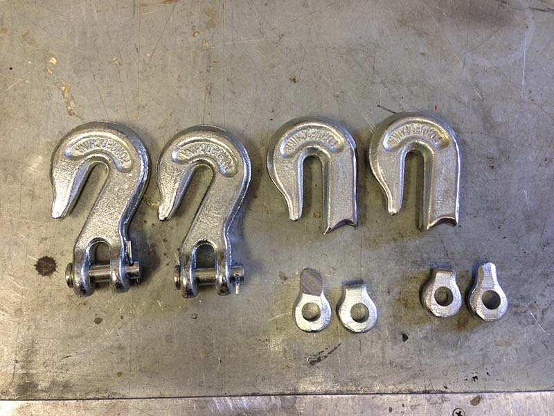

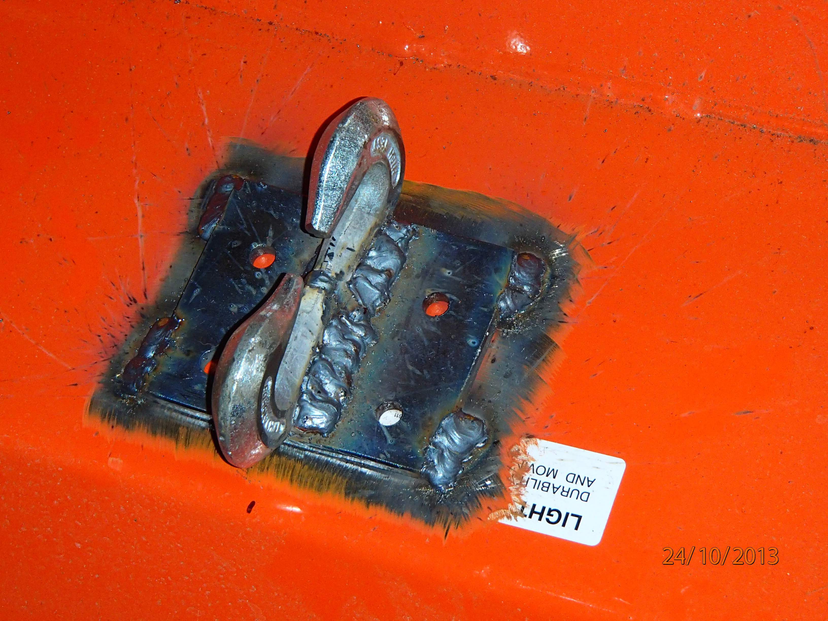

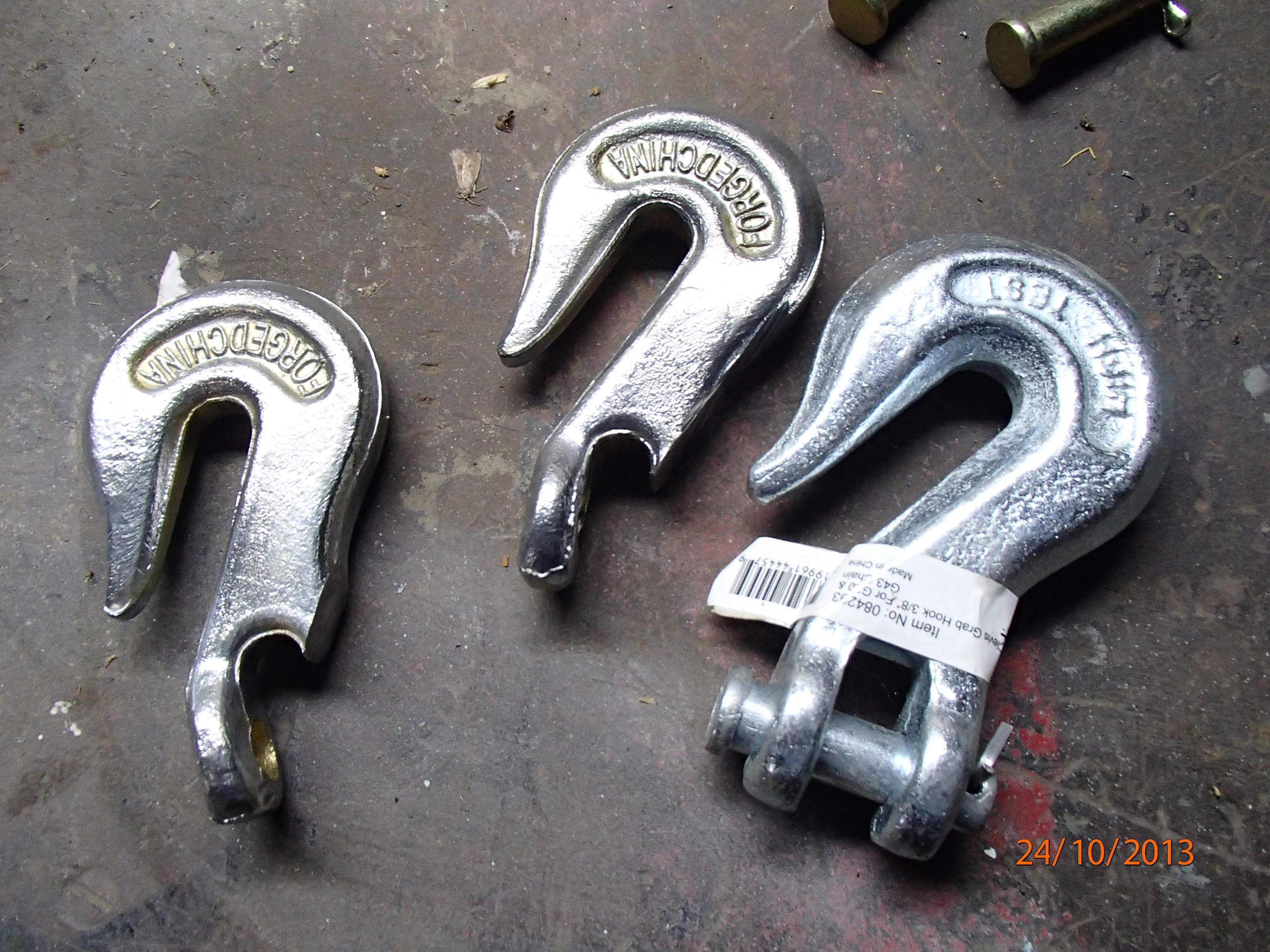

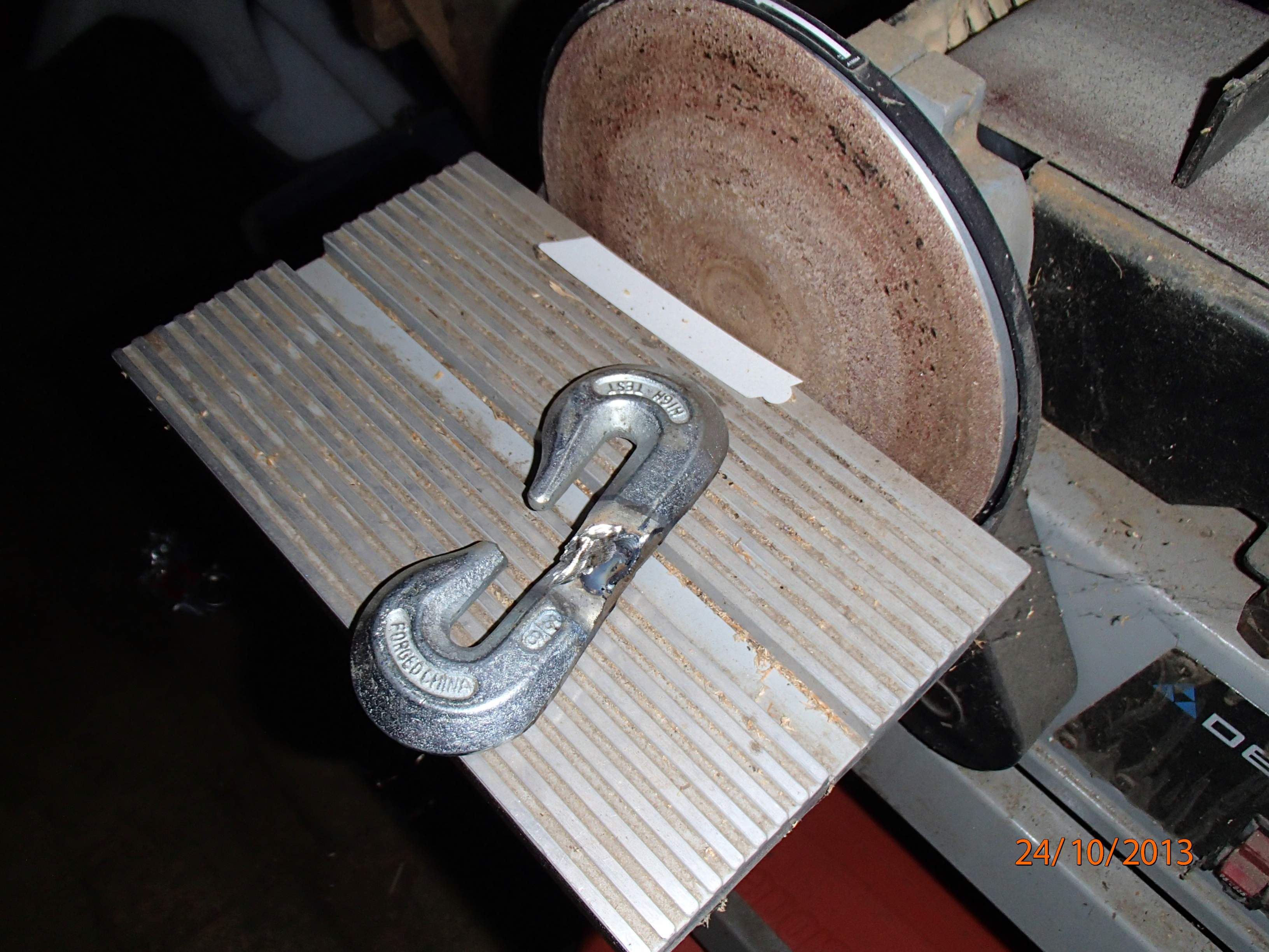

Here is my idea for how to install them!
But with the forks below i find i never use the hooks on the bucket! My first time with forks....best attachment I've ever purchased!
/ Where to weld bucket hooks? #95
Looks good. I put a slip hook in between the two grab hooks. I can then run the chain through the slip and over to a grab hook on one side or the other to take up the slack. The slip hook is nice when you need to hook to a rope or cable eye, strap, etc.
