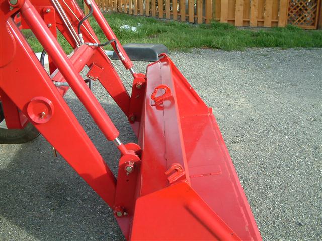

Hooks mounted outside the lift arms are simply asking for trouble. As I've said many times, I've cut off and re-located dozens of hooks in my shop. Every time the owner had a ruined loader because he had twisted it by using incorrectly mounted hooks on the outer edges of his bucket. Besides the pure physics and avoidable torque applied incorrectly for which an FEL is designed, it is also an accident waiting to happen. It's your tractor, your money and your life, but I'd cut those outboard hooks off and mount them properly in line with the loader arms as soon as possible.
Trust me, I am not saying this just so I can say "I told you so", it's to try to help a fellow member avoid unnecessarily tearing up a good machine and possibly getting hurt. I have nothing to personally gain for it. If I thought it funny to see guys tear up a tractor they spent their hard earned money on or possibly read about someone getting hurt, I'd say nothing. I've worked in and around machine shops and engineers who design equipment for decades. This is not a debatable topic. I'm just saying "don't shoot the messengers".

Generally when I've re-located hooks to be in line with the lift arms (after they've twisted their loader arms), it seems to be standard operating practice to cut off the center hook and weld a 2" receiver in the center of the bucket. Once you've used your FEL with your trailer hitch on it to move your trailer, you'll throw away any 3 pt. hitch trailer hitch setup you may have. It's far easier and you can see what you are doing without trying to twist your neck off.

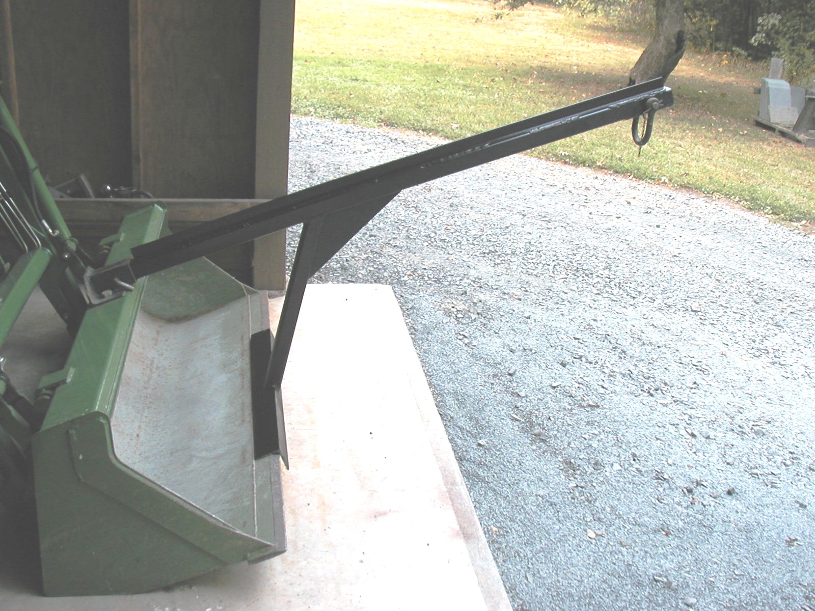

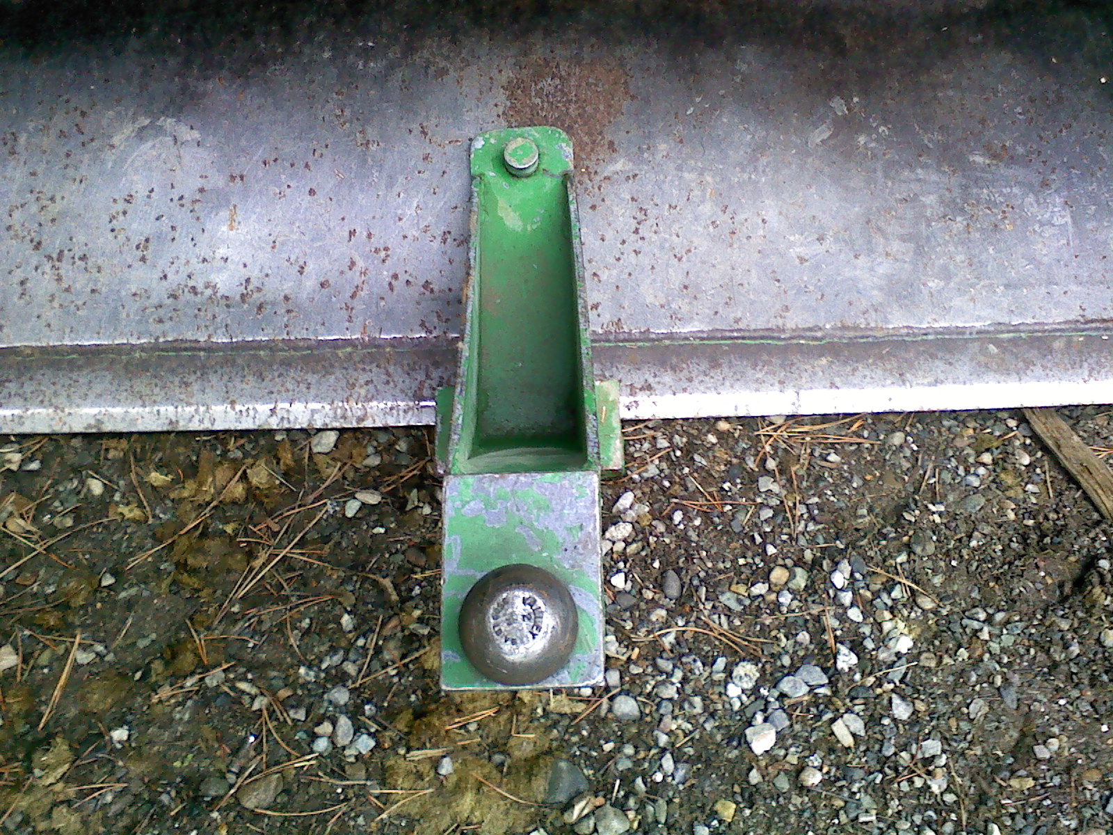

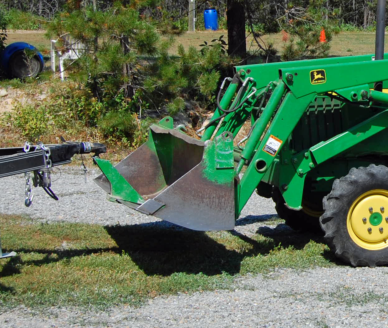

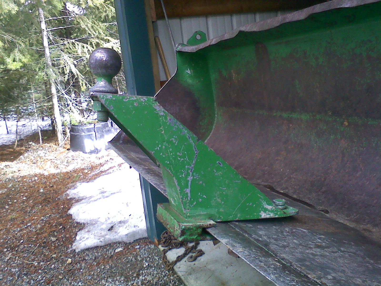

i tried that on my last tractor, but i couldnt reach under the trailer to hook the ball cause the bucket was too tall. i ended up making a hitch connector that bolted thru the lip of the bucket. Simply remove a flip lever clip, and pop it off. took a second to install. have used it for years.
mynew tractor has to lift a gooseneck that has a tongue weight of 1,500 pounds. im afraid a ball screwed thru bucket lip or top cap would bend. im looking at modifing aq skid mount hitch plate with a receiver for my trailer ball...like shown. i may possible just add a beefed up receiver to a set of loader mount pallet forks. still havnt made up my mind

For those that have welded ball hitch receivers to their bucket, how much drop in the hitch is required to get low enough to connect to a trailer. I realize that depends on bucket depth and trailer tongue height but I' not seeing how one could get the ball low enough to connect.

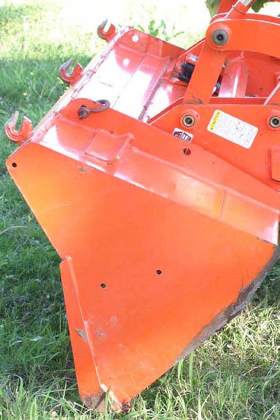

Here's what I have on my Mahindra 5525 bucket (6-ft wide)
My dealer installed them when I bought the tractor (I supplied the hooks, he kicked in the labor).
I bought the hooks at AW Direct
Gunnebo-Johnson Grade 80 Weld-On Anchor Hook w/ 4,400 lb. WLL - 3-3/4"H x 5"L - Mfg# 589357
Weld-On Grab Hook - Grade 70 - 5/16" - Mfg# 11-516WGH
My dealer welded a 1/4" thick stiffener to the top lip of the bucket and then welded the hooks to the stiffener. Very important to use adequate stiffening or risk bending the bucket out of shape.

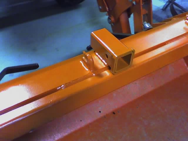

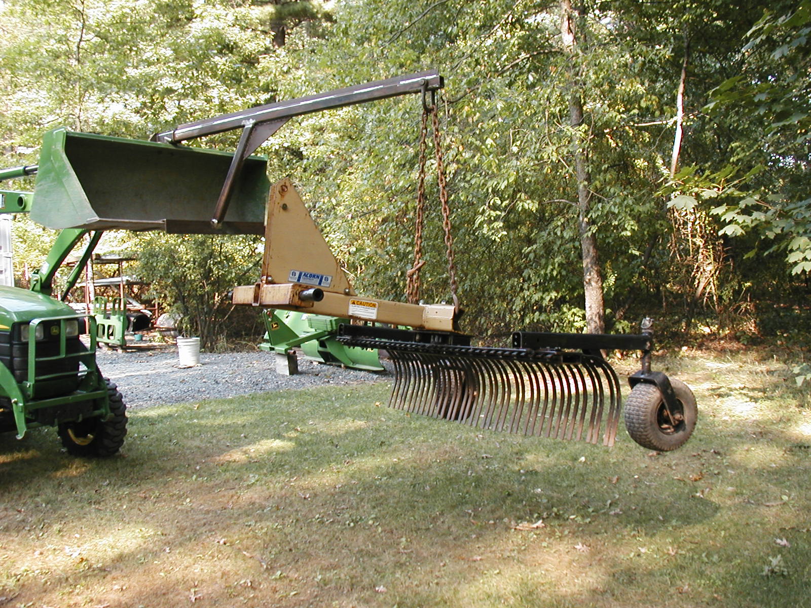

I can't say I've ever seen anything like that before. Pictured here is where I welded a receiver to the FEL on a friend's Kubota L5030HSTC. He wanted a hook along with the receiver although I don't see the need for both. He simply added a 2 5/16" ball on an insert and moved everything from his gooseneck trailers to his travel trailers around without any issue. With the insert removed the receiver is not in the way of anything. I can't see why you'd want to spend the money for anything different. Why try to re-invent the wheel? The hitch setup pictured would handle anything your tractor could handle.
Personally, all of my trailers are stored in my barns with concrete floors and concrete drives, so I use my forklift to move everything. Nothing is easier than that if you operate all on concrete (which I'm well aware a lot of guys don't - thus the FEL hitch). I despise burning a hole in a perfectly good fork to mount a ball. When the ball is off, you really weaken the end of that fork. I certainly cannot take credit for inventing the idea of welding a receiver on an FEL; guys have been doing that for years. However, I did design and invent a removable hitch for forklifts as pictured. If you have a forklift, there is nothing better when it comes to moving trailers. We even use it when lifting items with chains or slings using the forklift to assure the chain or sling does NOT slip off the end.

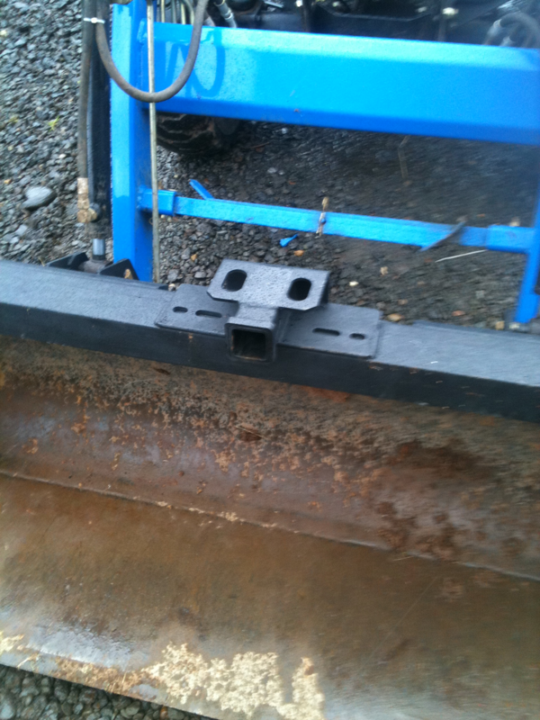

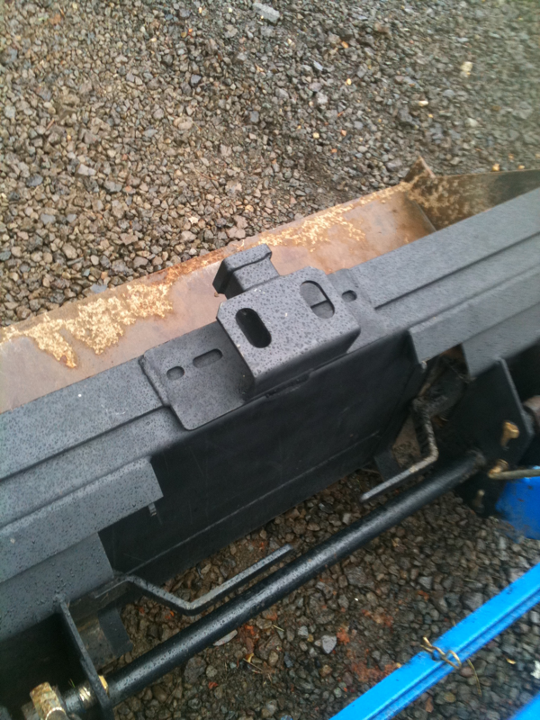

You can use the receiver for chains, slings it is great
Also HF has stingers with hooks on end, cleaves for 15-17 bucks
This works wonderful
I have a 4 inch drop for my small, low utility trailer, but the pintle on my dump trailer and coupler on flat bed is high enough for just a straight or 2 inch drop. Mine is on top of bucket, I've seen some inside which would lower it more, but mine is fine for my needs :)
There is a chance of bucket contacting the ground over rough terrain, but these are mostly for short trip trailer moving/ jockeying, so it is well worth the trade off. for any serious trailer towing I use the 3pt on rear.

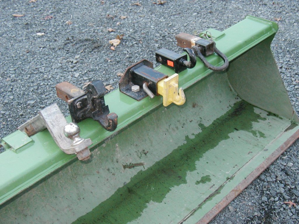

Couldn't agree more :)
Some may be tired of seeing my "Bucket Buddy" since I post this pic of all the acs. when ever the subject come up.
