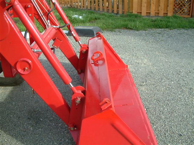

I think you are right on the outer hooks
I wonder if any hooks other than the center
One can bend your FEL. Because I have picked
Up on a fence post to pull it out of ground and
my hooks are in line with my arms and it pulled
My tractor down. But it did not bend my FEL. So
I think I will cut my hooks off and
Use my center receiver only. That would be one
Expensive fence post. I saved many yrs to get my tractor
I would hate to tweak it out on a numbskull thing like a
Fence post

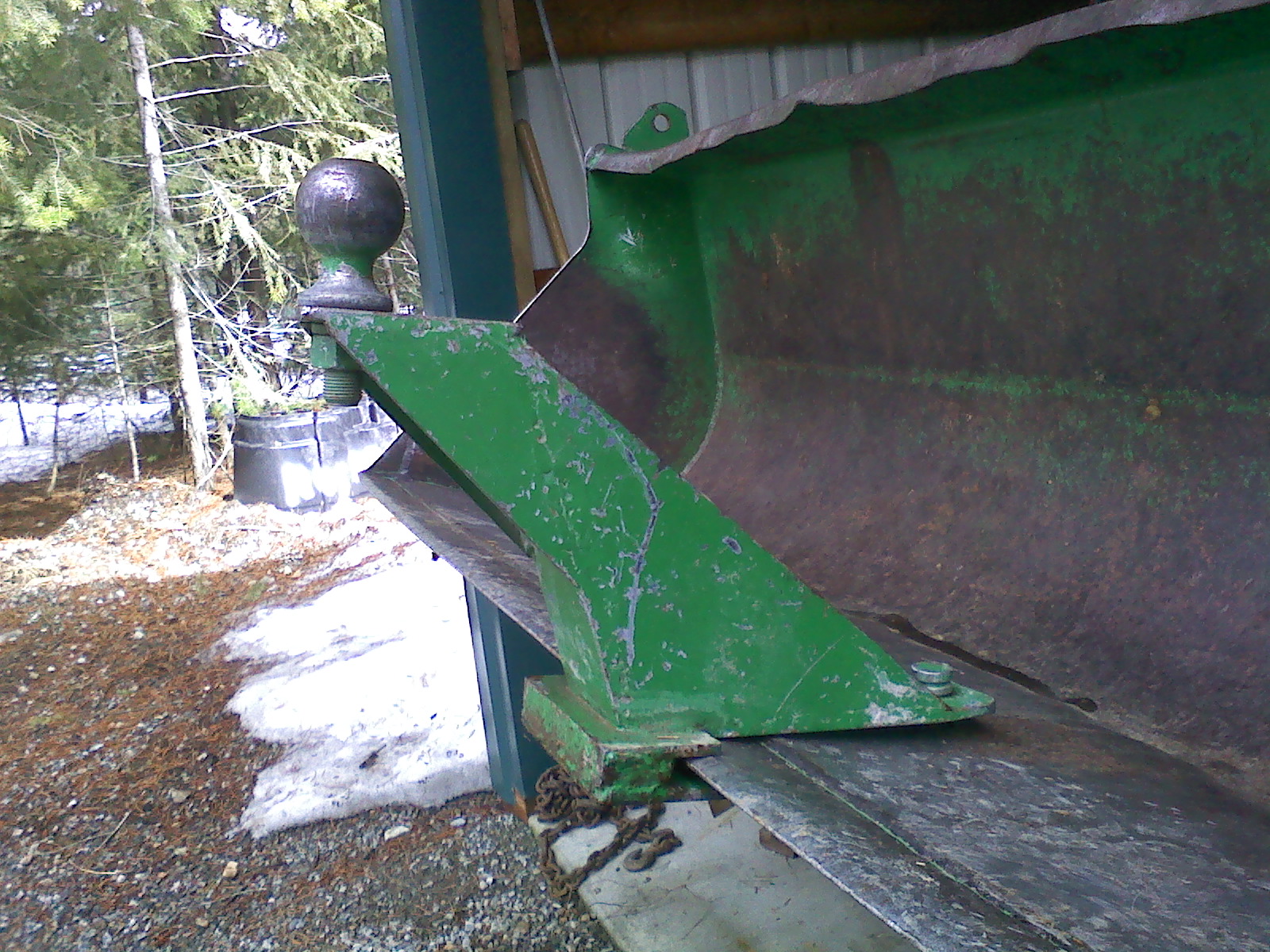

Some may be tired of seeing my "Bucket Buddy" since I post this pic of all the acs. when ever the subject come up.
JB
That is the same kind of bucket I have. When bolting the hitch on, did you put a stiffener plate under the nuts in the bucket. I want to do that same thing but it seems the bucket has a 1/2"air gap which I would worry about squashing when torquing down the bolts:confused:??

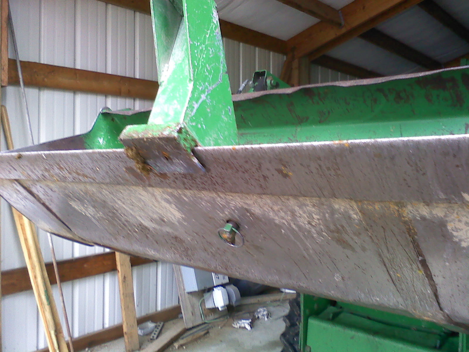

I have to double check on the bottom plate, I think I did add it after. But I know for sure I was worried about crushing the 2 walls that make up the bucket top, so what I did was add a sleeve between the 2 walls, a piece of steel pipe large enough for the bolt to fit in, over drilled the top wall so pipe could drop in, but drilled the bottom only large enough for the bolt.
That way I could crank it down to my hearts delight and it would only go so far. These double wall HD bucket tops must be pretty tough, cause even with the heaviest thing I have lifted (full ballast box) There was zero deflection in the top of the bucket.
But even if someone had to reinforce the bucket top, it would be well worth it to be able to have a center mount receiver tube :thumbsup:
JB

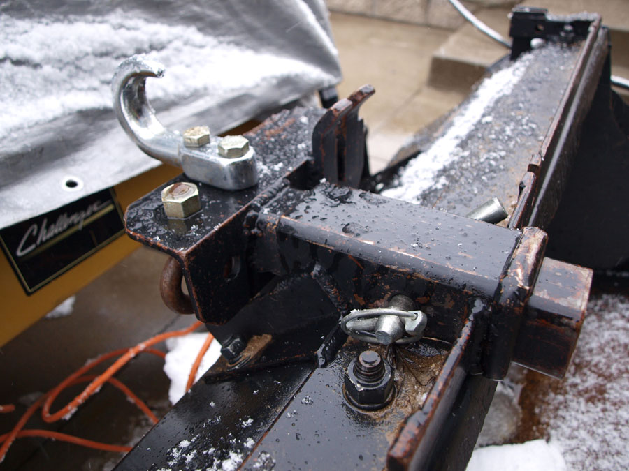

This is how I did my front bucket hooks. I put a 2 inch receiver in the middle and 2, 1 inch receivers on the ends of a 1/4 inch 3"x2" piece of angle. Bolted and welded to the bucket. I also notched the angle iron for chain with reinforcement. I carry with the tractor the piece for the 2 inch receiver at all times and when needed just reverse it around as needed. On the ends I can put any type of device I can dream up which includes hooks. The last pic is the 1 inch receiver on the end. Kind of hard to see as we are getting yet another snow storm. Getting close to one hundred inches at the house and 500 inches at the local ski resort, Mt. Rose Ski Tahoe.

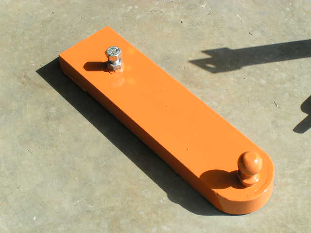

ok....i spent about an hour redesigning what i want to make. ran it thru the cad program, ran that thru the vextractor program, then ran that thru a program called Enroute to set the cut parameters and do the nesting to save on materials as much as practical. Im cutting the parts out of a 24" x 48" piece of 1/4" plate stock i have laying around. a bit rusty but will clean up ok.
ill cut the 1/4" plate material tomorrow...if time permits and weld it all together. The amazing thing about cnc plasma cutting is i can cut these parts out in a few minutes, and pick up the pieces almost immediately after by my bare hands.....not sure how that works, but the metal doesn't get very hot. 30 seconds cooling time is all it usually needs for 1/8" stock, about 45-60 sec for 1/4" plate.
heres a lame picture of the nested art work. the program doesn't have a good way to send a copy to my printer. i have to do it a round-about way and convert that to a JPG to post. Ill take a few pics while cutting and after cut.
