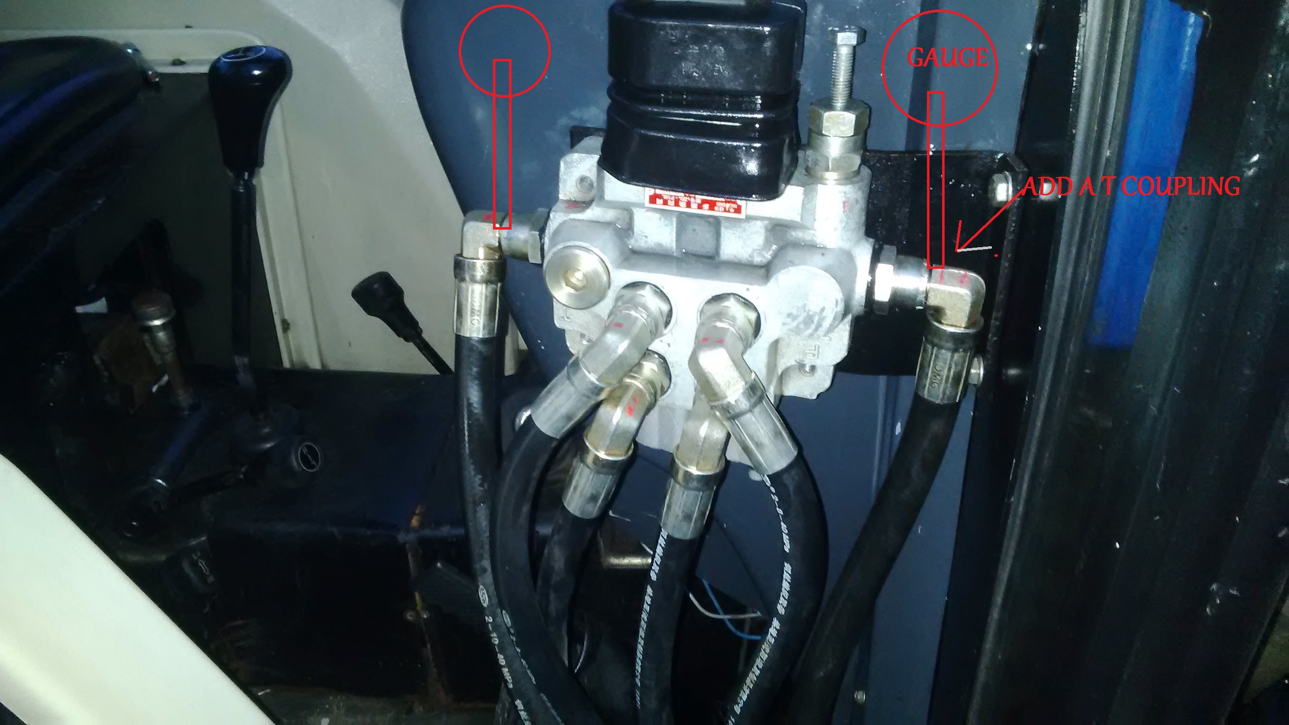

As some of you may have been reading my latest post regarding my hydraulic problem, to protect my new pump coming via mail someone suggested to add a hydraulic gauge to view from time to time and was thinking could I simply add the gauge on the spool in or our by adding a T coupling see picture I would add it with a long hugh pressure house so I could place it where i could see it Spool Valve.jpg

That is a good place to install the tee, hose and gauge.

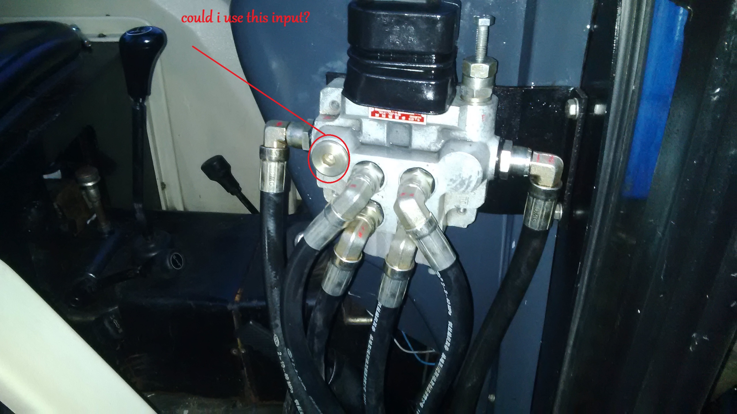

Hello JJ, on the valve top right is P and the top left is T, what is I should have a PB on line? What is PB? Thank you
/ Where to add hydaulic gauge #13
PB is Power Beyond, meaning that port is capable of supplying high pressure downstream using a PB adapter.
The tank port is supposed to go to tank, as it is low pressure up to about 500 psi max.
In most loader valves, you add a PB adapter and feed that to a hyd block and then it if routed downstream for use by a remote valve or the 3pt.
On the left side of that valve, where the OUT hose is, is there another port?
If not, the tank port may be facing you and the PB port is being used for a tank port.
Back pressure could damage the tank port, and cause loader valve problems.

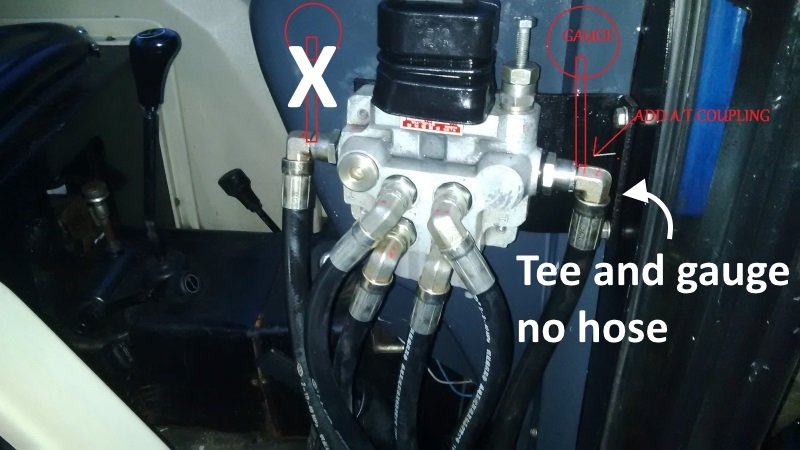

It should work here, I don't see a need for a long hose if you can see the valve from the seat.

Jinmas aren't like other tractors, they come from the factory plumbed "wrong." They don't use the power beyond port on the FEL valve, the output of the valve feeds the power steering and then the 3PH. So the output feels the full pressure if a downstream device is being used. In theory this should be a problem as the pressure massively exceeds the back pressure rating of the valve but in use they seem to stand it.
In order to get a true system reading you have to have the gauge upstream of the first device -- somewhere between the pump and the input to the FEL valve. If the hose you marked is the input hose then a tee there will work.
