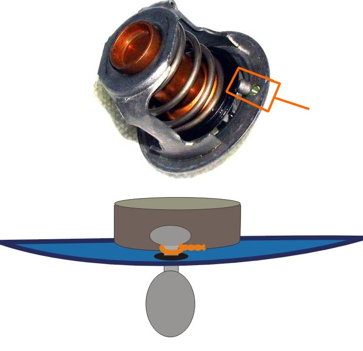

<font color=blue>the jiggle pin may not become lodged in the thermostat</font color=blue>
Spencer, the engine manufacturers solution sounds like "smoke and mirrors" to me. I took a different approach to fixing my thermostat and they could take a lesson and modify their thermostat so this fix isn't necessary. Here is what I did: I found a piece of thin stainless steel wire (lockwire/safety wire) and put it around the pin on the opposite side of the jiggle pin's bulb. This reduced the length of the pin enough that the pin can no longer move far enough to get under the valve lip. I cut the wire with a couple of twist loops on it so it will not come loose and end up in the coolant system (although I doubt that such a small wire would ever cause a problem). Here is an illustration of how I fixed the thermostat. I don't know why the manufacturer doesn't just shorten the pin and have the problem fixed. They probably have their tooling and process set to do it as is and don't want to incur the expense of retooling./w3tcompact/icons/hmm.gif

For those in need of a quick fix, I used to rap the thermostat housing with a rubber mallet if the ball stuck and that worked just fine /w3tcompact/icons/laugh.gif. I would have made the repair had I kept the tractor though!

Spencer, I didn't mean that you were using "smoke and mirrors," but rather the manufacturers are doing it. Gosh! If it weren't for great dealers, we'd be left out in the cold on many of these issues. Thanks to you and others like you, we can have confidence that our warranties will be honored.
