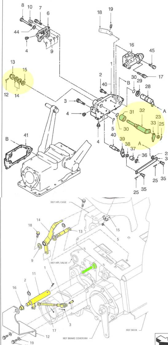

Duane, here is the illustration from the IPC. The shaft with the castle nut is shown in green. I'll let you draw your own conclusions as to how it operates. It's sure hard to tell with no more detail than is shown here./w3tcompact/icons/crazy.gif

I never took the nut completely off, just loosened it until I was happy with the amount of force required to move the lever.
