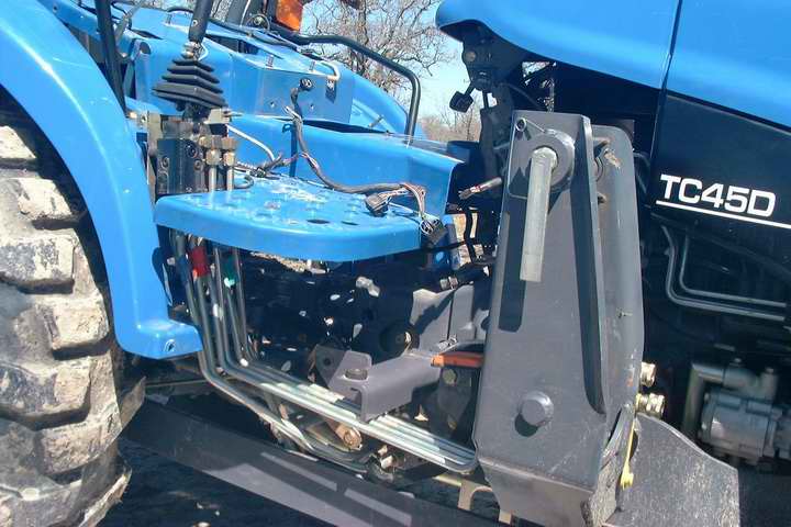

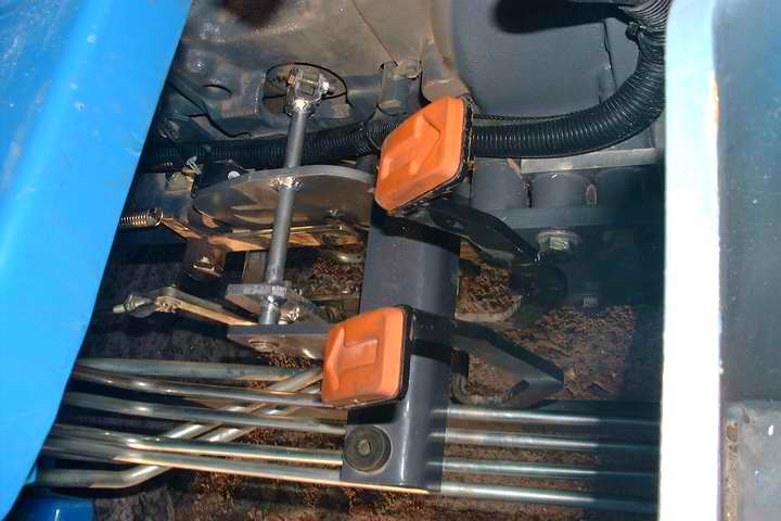

   / Where the TC45D is NOT deluxe #95
It happened to me! /forums/images/graemlins/mad.gif
Last weekend I was backing up with the rotary cutter and let off the pedal and the tractor turned into the energizer bunny, it just kept going and going and going.... the pedals would move they just did not have any influence on the tractor direction or speed.
So I turned the PTO off and just kept driving it backwards out of the field and back to the house. Climbed underneath looking for a stick or some other object that might have become jammed in the pedal linkage. There was no stick. Then I remembered this list that jinman started a little over a year ago. Gulped and scooted into position to look at that weld, aarrrghhh! My three year warranty ended in April. Guess this is why I bought the repair manual.
So that was last weekend. Yesterday I started the process of removing the part, but I wanted to do it faster than Jim did. /forums/images/graemlins/smile.gif Was able to get the part partially free but just needed to remove the operator platform brace which required removing the FEL mounting bracket, that thing is heavy!
That did not give me enough room. 4 hrs later the part was off but not before doing everything that Jim mentioned: /forums/images/graemlins/shocked.gif removing the seat, FEL, operator's platform, rubber mat, FEL control valve (could not get the rubber mat off without doing this), disconnecting lots of electrical connections (since the wiring harness is connected to the bottom of the operator's platform), both rear wheel fenders and the turn signals, both side consoles, the side panels under the dashboard (in order to prevent gouging them while lifting the operator's platform out of the way) and probably some other items that I have convieniently forgotten.
In the end I did not have to totally remove the operator's platform, just totally loosen it so that I could prop it up 6 inches to get at the part.
During this removal process all the bolts and nuts were metric -- except for the two bolts on the part where it clamps onto transmission, they were SAE.
So at this point the part is off and the tractor looks rather dorky. Have a call into the dealer, did not call them until I had the part off (was hoping to have it off much earlier in the day, before they closed). Will see what a new one costs vs having this one re-welded. Will probably get a new one since I seemed to have damaged the end shaft on this part, most likely while trying to remove it without having to remove the entire operator's platform. Bent the very end of the shaft where the "e" clip attaches.
One notable difference between Jim's unit and mine is that Jim's pictures show a unit much cleaner than mine. Maybe I should have bought a power washer. The grease and dirt have made a lasting impression on my clothes, the shirt is history and the jeans, well lets just say they weren't my wife's favorite before yesterday.
I'm figuring that I'll be spending some quality time with my tractor the next week or so. Hope I can get it all back together in less than 8 hours, with no parts left over or missing. /forums/images/graemlins/blush.gif
   / Where the TC45D is NOT deluxe #96
Dave,
Did you have a partial weld on the shaft or was it fully welded?
I'm just curious as to whether those of us who got units that included a full weld ( not just tacked ) are due for failure.

DVerbarg,
The same thing happened to me last Sat. afternoon. In my case, my TC40D would creep either forward or backward (depending on which way it was last pressed.) Thought it as a spring adjustment until it would not go anywhere but forward. So - shut it off - now it won't go because the transmission is turning and it won't go into hi or lo range without grinding the gears. So - on to the next task - beer drinking started much earlier that day. My dealer came out Tuesday to pick it up for me - no charge /forums/images/graemlins/grin.gif disabled the neutral starter switch, drove it up on his trailer. I picked it up on Wednesday. Although I don't know if is a new one or rewelded, it seems to work ok. I have almost 300 hours on mine, it made it to the dealer yard in 6/2001, and my barn in Jan 2002. In a side note, while they were working on replacing a hose on my backhoe, I told them my loader valve was "sticky", while they were checking it it out, it broke off, so I have a new one of those too.

Oh no! /forums/images/graemlins/shocked.gif Wouldn't you know it. It happened after your warranty was gone. What a bummer. /forums/images/graemlins/tongue.gif This part is a giant pain to replace and I'd suggest you get prepared for a struggle getting the "U" shaped piece reattached to the transmission. I could only get one bolt in mine, but it is still holding just fine. That and some stripped bolts in the side panels by some "monkey fist" at the factory were my only problems. I think you will agree with me that the platform is a royal PITA to take off. I just raised mine about 6 inches too. Getting all the actuator shafts back in the right places in the side consoles is real fun. /forums/images/graemlins/crazy.gif They are made of soft metal, so you can easily bend them. About the time I had this job finished, I was thinking how nice the old tractors with no operator platform were to work on. ...everything right out in the open.
Well, Dave, I'm not going to rehash what I think of New Holland engineering on this part, but it made me very angry when mine broke and now I'm angry again. Heck! Wasn't it just last year that one of your front wheels broke at the hub? Wow! I know you have to be pretty disappointed with all this bad luck coming your way. I'm really sorry you have to go through this.
I don't know how much help I can be, but I normally check TBN daily. If I can offer you any advice or help I will be happy to answer any question about my reassembly. Good luck, Dave. You should NOT have to be doing this. /forums/images/graemlins/mad.gif
Just one thing I forgot. I didn't want to disconnect my loader control valve, so I just cut the platform pad in a spot that is covered by the control valve cowling. It sure made that job easier. After reassembly, you can't even see it. I kept wondering why it didn't come split from the factory.
