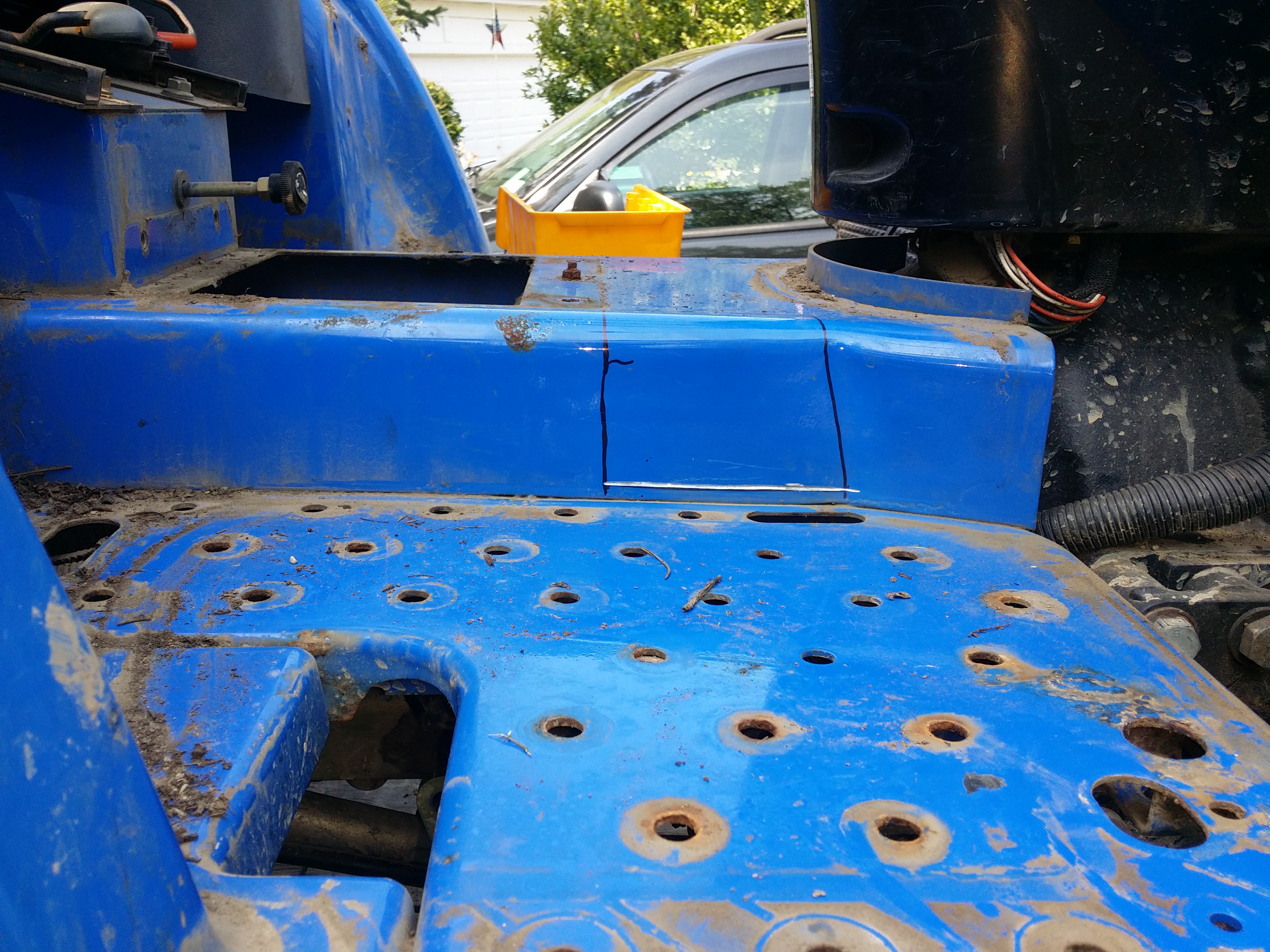

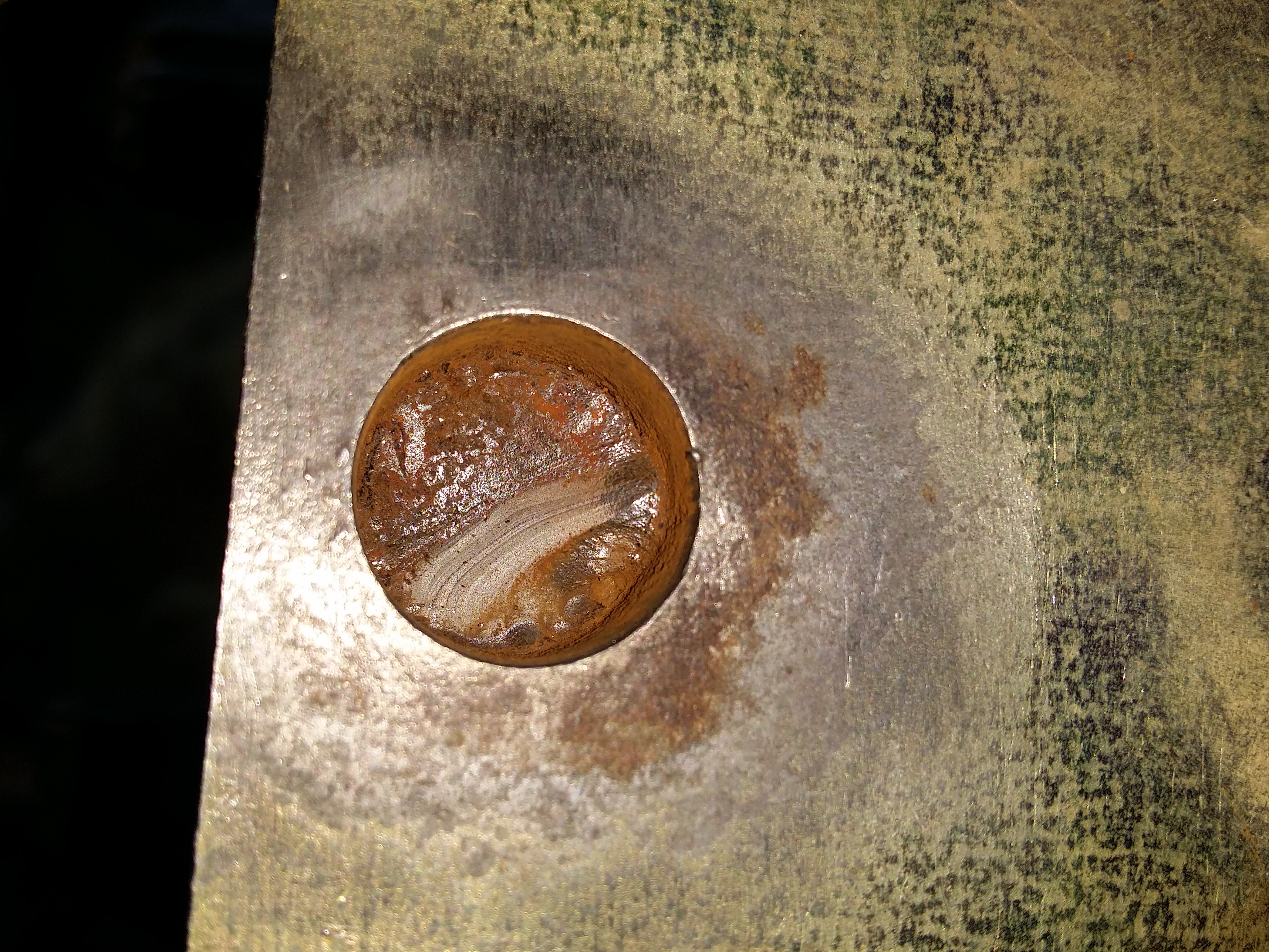

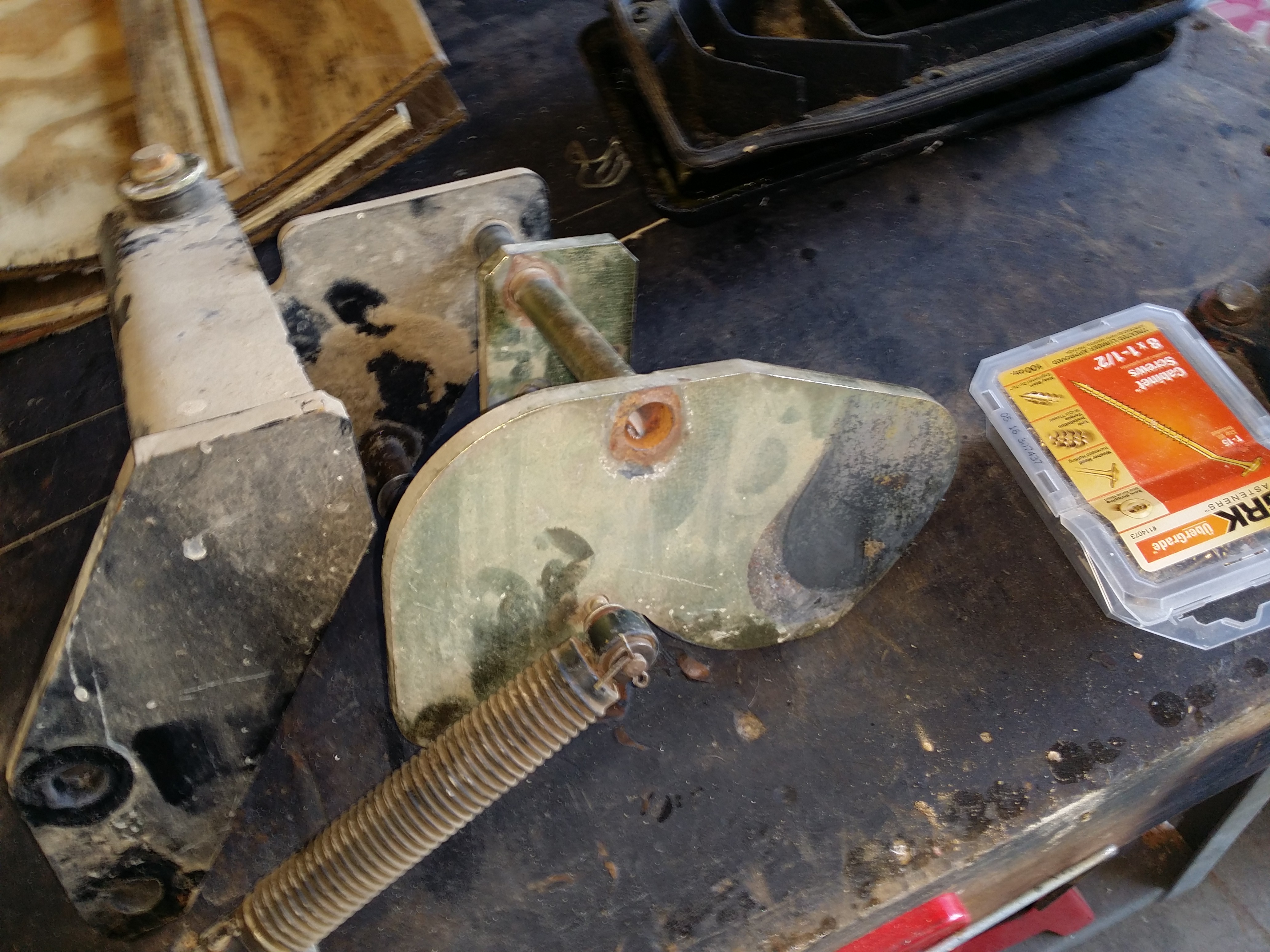

3 year Resurrection... yep.. mine cracked also on a TC40D (no Deluxe here either). Thanks for the original post as well as all the great comments. It definitely is a major design flaw. After evaluating the situation and all that needs to get removed just to get access to the 2 trans bolts, I sat in the garage and contemplated my options over an Ice Cold PBR..so dont think I just jumped at with a bunch of cheap tools :)
Now before you all beat me up and verbally abuse me... please keep in mind that 1. I am way out of warrantee 2. I am on a very tight schedule as this is a work machine used to brush hog vacant residential lots to avoid code violations from the municipalities (Cant have any down time) 3. If It happened once, It may happen again.
With a cut-off wheel..
I decided to stay below the hump...

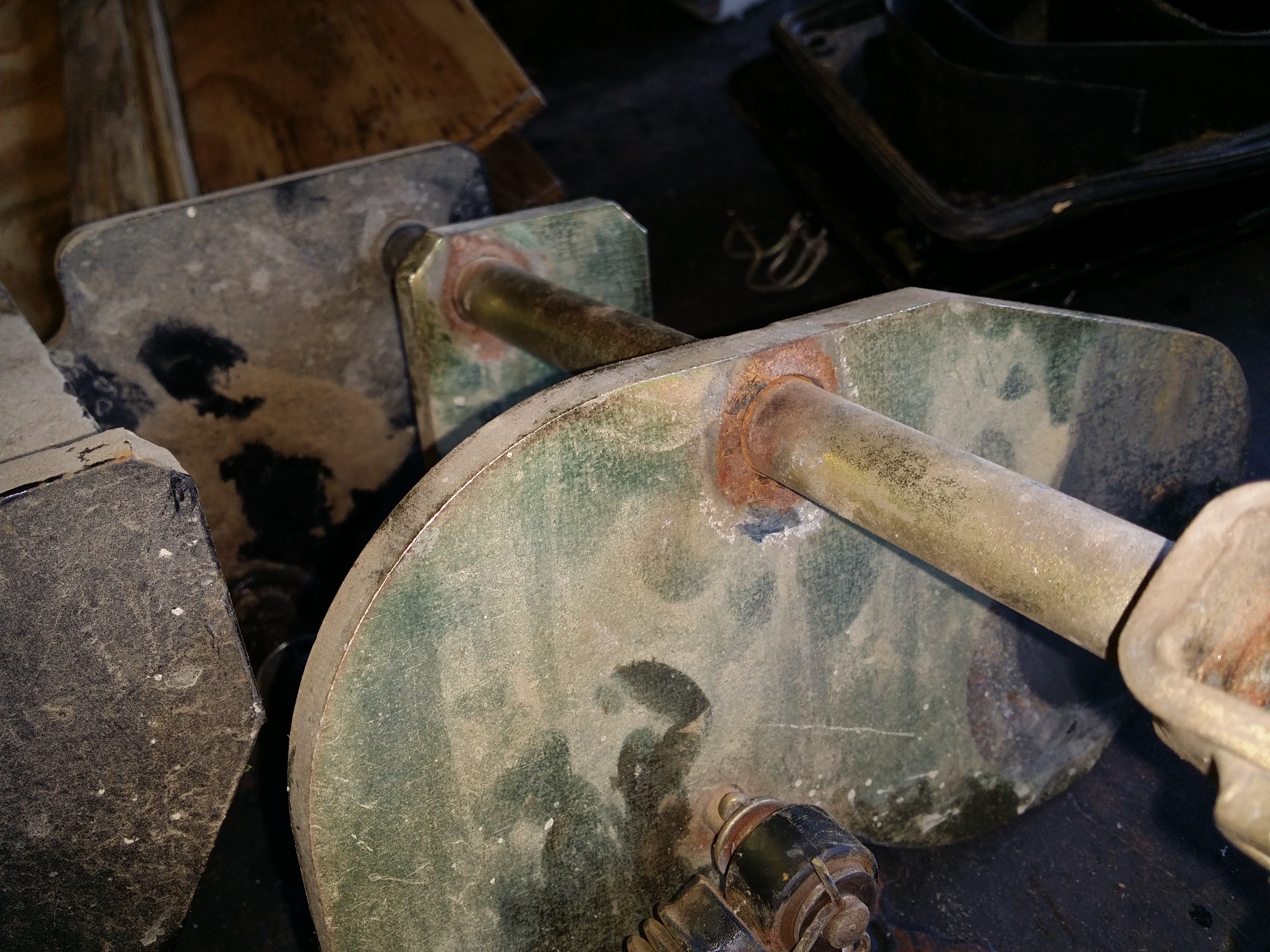

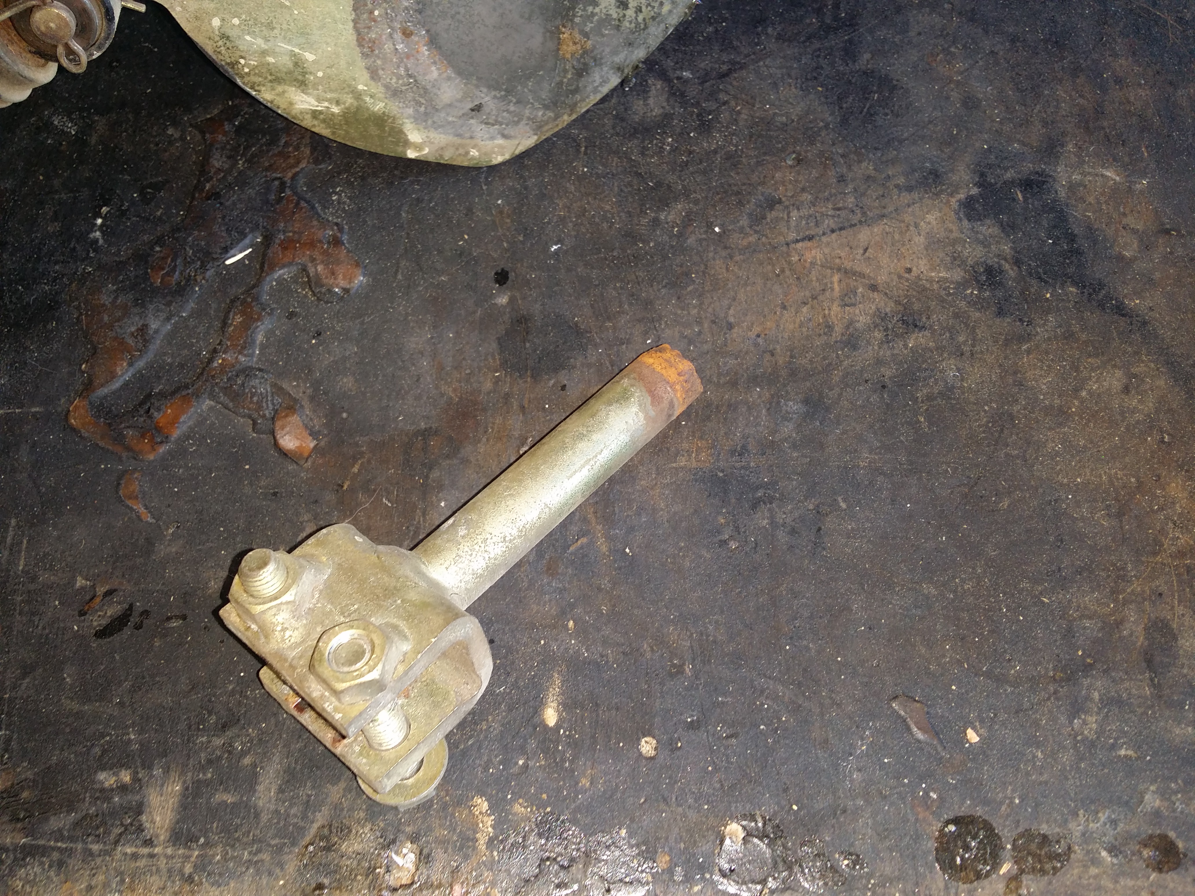

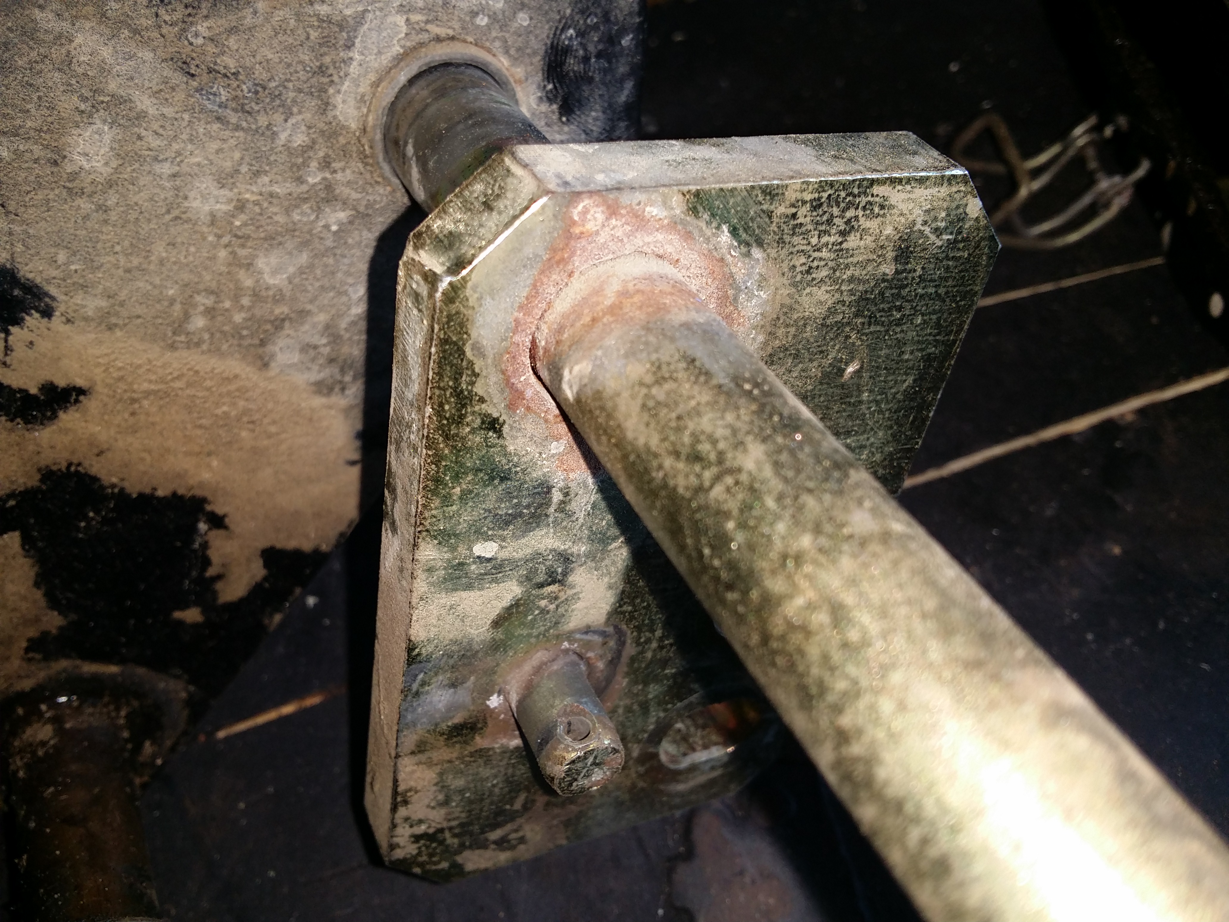

The next 2 photos show the failure.
Now, you guys have talked about full welds and spot welds. On my unit here, I have full welds on one side of the plates and No welds on the other side of the plates. the failure happened on the No Weld side.
IMG_20170802_112830.jpgIMG_20170802_112837.jpgIMG_20170802_112844.jpgIMG_20170802_112855.jpgIMG_20170802_112951.jpgIMG_20170802_113006.jpg
I am going to weld this back up myself, reinstall the assembly, tack weld the cut-out back on and douse it with some rustoleum.
after cleaning up the anodized plates, you can see here where the penetration of the weld on one side weakened the integrity of the rod...causing it to fatigue and crack... they should have welded both sides from the get go.

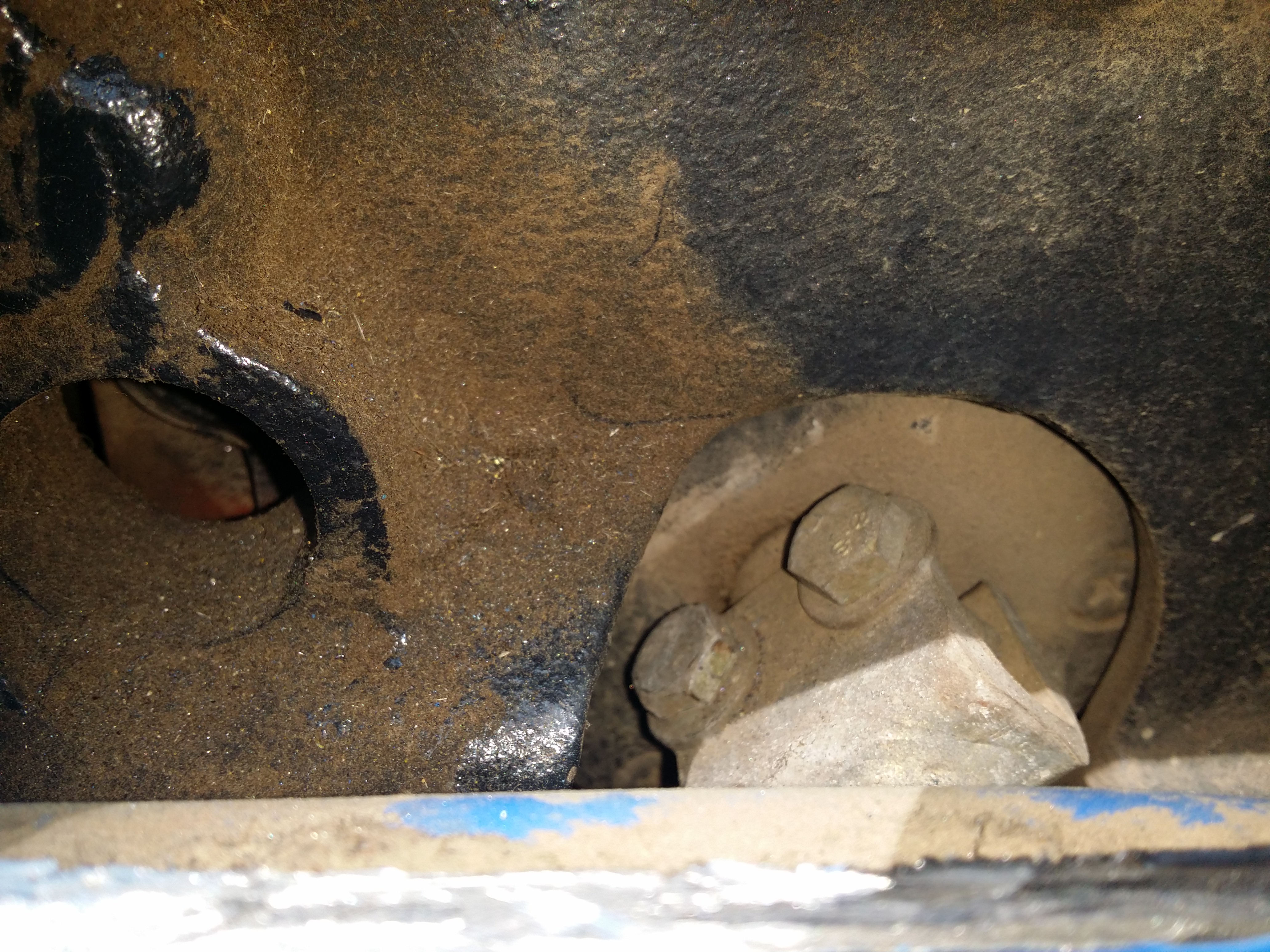

Thank you MarkoCSI. I have a 2001ish TC35D. The Trans Pivot (New Holland #87300017 ) broke at the U Shaped part closest to the transmission. The tractor for a few days was basically sticking in gear (push forward and it would continue to creep, same with reverse). Until the weld completely broke, and stuck in reverse going a a good clip! Looking at removing the floor, FEL, seat etc was not worth it on this 20+ year machine if you can cut an access hole. I will be doing that tomorrow, hopefully I can line it all up and just have someone weld it back in its location. If not, it will allow me to remove the Trans pivot with much less work. And thank you for the pics!
