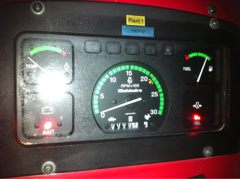

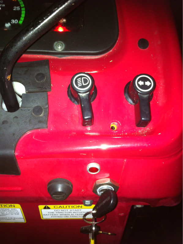

No luck.... There is a light next to my key, but it takes over 30 seconds for it to turn off... I remember the dealer telling me it was a emmission light...??? Here is a picture of it.... I don't see any yellow lights or anything that looks like a light bulb symbol...

Unless things have changed drastically, you don't have a "glow plug", but rather a manifold air heater...your engine should be "direct inject". Just turn your key to the on position for about 5 seconds, then hit the start. My 6000 will fire up in any weather/temp within 2/3 revolutions...if the battery has enough juice to roll it over..(my original battery lasted 7 years-its a '02). Good luck with your tractor. BobG in VA
/ Where is my glow plug light #8
Thanks for the picture, now I can help you . The indicator light right above the key switch is the intake heater idicator.
/ Where is my glow plug light #9
Yep that's it. Like every one said you do not have glow plugs, it is an intake heater. It is designed to go on when the key is turned. It's is also designed to go off after 30 seconds. Cold weather turn key wait 5 to 10 seconds then start. Coooooooooooooooooooooooolder weather (actually if it is this cold you might want to think about a block heater too) wait the full 30 seconds. Sometimes when it is reallly cold after it doesn't start on the first try turn the key off and then back on this will reset the timer.

Craig,
The following is a cut & paste from the 4530 4wd manual:
Heater Indicator
When the Key is turned to the ON position, the heater
indicator indicates the activation of heater element provided
in engine intake manifold. The element continues to heat
the air in the intake manifold for 41 seconds. A timer
controls this time.
1. Turn the Key to the ON position and hold it till the heater
indicator is put-off.
2. Crank the engine when the heater indicator light is putoff
after 41 seconds.
