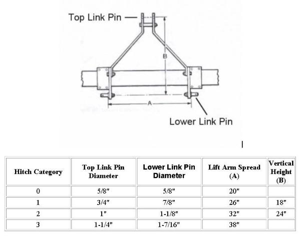

i have made several round bale forks. a rear blade. a carry all. a goose neck trailer mover. all 3 point hookup. i used some square tubing for the frame. just make a T. turn it upside down and you have a 3 point frame. weld a bracket for the top bar and a couple brackets for the pins put some braces on it and you are ready to put whatever you want to build on it. if you can build the tool then you can also build the frame.

Where can I buy the 3pt mount parts for making an implement? It can be a kit that I have to weld up or can be the basic piece. I have been searching and searching for the 3pt mount parts but am either using the wrong terms or just suck at searching Google for it :)I am looking to build my own hiller. The reason I am wanting to purchase this part is simply for time savings and would get something semi standard vs. hand making this part.
Thanks
Rick
Try AGRA SUPPLY or Northern Tools. I hope I have the names correct. There is an AGRA SUPPLY in Greenville NC ..........TCZ Wright

If you can make the implement you can sure as heck make the "3PT part".
So, go back to TSC, look at the parts and buy the ones you need. It really is that simple.
Shopping list: You need three pins.:thumbsup:

Thanks for the support guys.. I don't mind being a D*&k back and its ok if someone chooses to be one to me. I will however as you see respond in kind.
David and bcp thanks for those links. I can see future potential for the one you found for me David and I had seen those before but not put two and two together :D
bcp, now that is exactly what I was looking for so thank you very much. I really didn't think it was going to be so hard to find a kit like that I really thought before this posting that they would be at every AG shop etc.
Mr HE, Although I have the capability to build one from scratch I wanted to start with something known or standard and go from there as I worked future projects. Honestly the biggest reason for wanting a prefab kit was I have 4 implements and each of them has a different span and size.. I was looking to hopefully find a standard. ;) Live and learn I guess.
trblshuter, someone pointed me in that direction before and you are right that is a great price I actually might go that route if I can find one local since shipping would more than likely be expensive on that.
Thanks again for all your input, truly awesome. I have the toolbar built and ready to install on a 3pt mount. Potatoes went in the ground last weekend so in a few months we should see how it worked or if I failed miserably :)

Bruce, thanks again.. That site even had a Heavier duty Cat 1 hitch on it that I ordered.. Appreciate it folks
