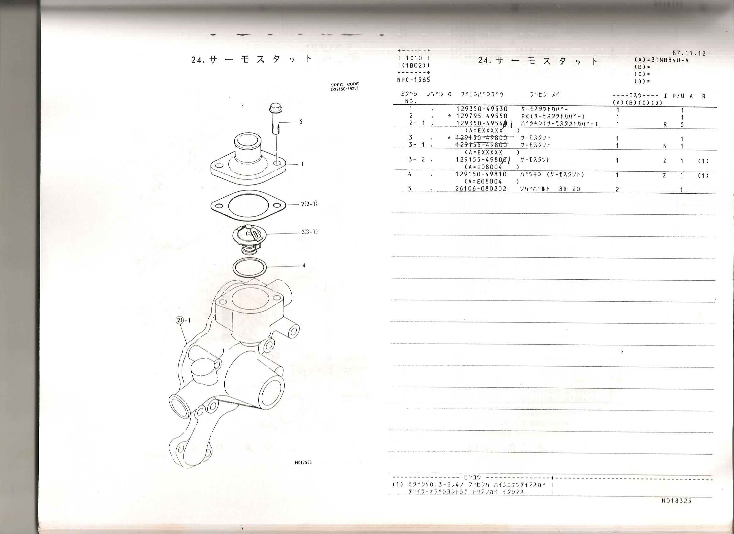

Sounds like the thermostat is opening. Parts drawing for it shown. Reference 3/3-1.
If the gauge red lined that top hose should be over 220F. Does it push any water into the overflow when the gauge is red lined?
A-HA! Somehow I missed this when you posted it originally. I did, in fact, take the top two bolts off the two-bolt flange and remove it (those are the only two bolts I can actually reach). I *could* be misremembering, but I am almost 100% sure there was NO thermostat down inside there when I pulled the hose+flange aside. (I didn't think to look up into the flange.)
This may be a stupid question, but will it be obvious if it's there? It won't be way down in side the water pump?
EDIT: Okay, well, quoting loses some of its impact when it doesn't include the attachment in the original post. This was the post where you posted the page from the exploded parts diagram showing where the thermostat should be.
