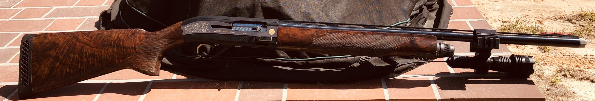

This is my 391 Beretta Silver side Sporting 20” with my stock wood, it is a fair piece of wood.

WOW!! That is more than beautiful!! I am VERY jealous.

Gorgeous wood on that Beretta.
